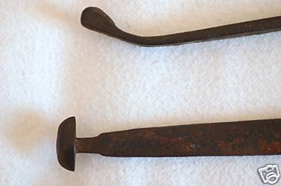

...it's peened and rounded off very smoothly. It's possible to see the circular end of the tang in the centre of the pommel - which is rather like a brazil nut pommel. No visible markings, signs of old sharpening. What do you mean by "walls"?
