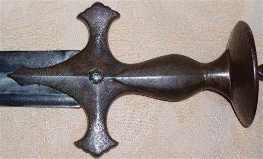

Assuming this is an Indian blade that was originally fixed to a 'tulwar hilt' ...I would suggest that the rivetted crossguard was functional. The tang on such a blade would have been relatively short....compared to that of a kaskara blade.
To 're-inforce' the tang fixture, rivetting the crossguard through the blade makes sense ....bearing in mind that part of the 'langet' is bound/fixed to the hilt. The langet above the hilt is in fact wider, it is one piece with the lower section but 'stepped'.....this again suggests that a 'good, solid' fixing of the crossguard to the handle was required ....to which finally the blade was rivetted...
I am assuming that ... indeed, the rivet passes through the blade ....so is just pure speculation

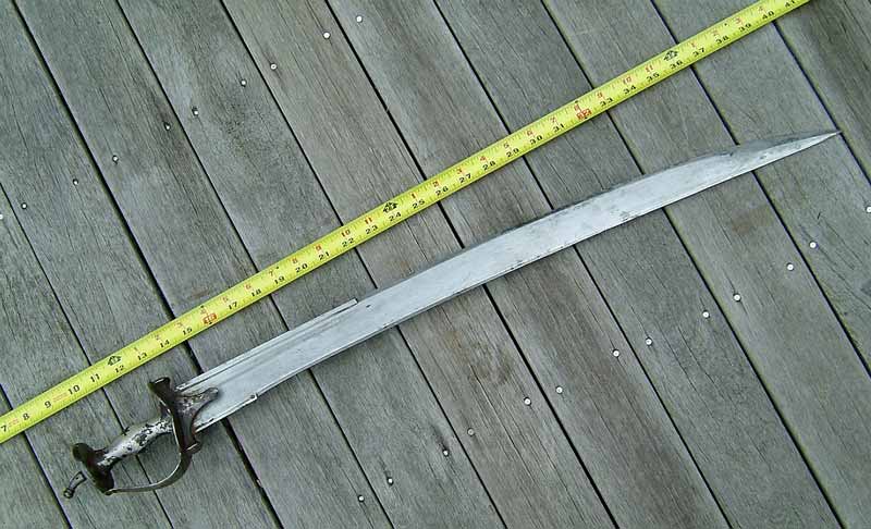

I'd like to make one comment on Jim's excellent observations, that is, in regards to the tulwar not travelling out of the Indian subcontinent.
I think the piso podang of Sumatra, primarily, but also seen in other regions, including Borneo, is very heavily influenced by the tulwar, or at the very least the earlier more archaic Indian hilts. There are some good old examples in Elgood's latest work that match up nicely to the piso podang form. In most cases the piso podang is shorter than the average tulwar and that is an adaptation, but otherwise, I think, clearly influenced by the "travelling tulwar".
Outstanding Charles!! and thank you
I completely forgot about the 'piso' and the influences of Indian swords moving into SE Asia. I think that khandas also joined in the 'travels' along with the trusty tulwar.
Regards David
David, you bring up a most valid observation, another I had overlooked. That is this strange rivet feature in the center of the crossguard. About two years ago, Richard (Pukka Bundook) had a tulwar in tragic condition ("Bad News Tulwar" thread) that he beautifully restored. In the center of the crossguard, there was a rivetlike square, which I cannot recall whether functional or not, I dont believe that entered the discussion. In any case it was replaced by an aesthetic flower feature which looked great.
In the discussion, another tulwar which was one of the Rajput type form with the stem type appendage of Hindu basket hilt type on the pommel, had this centrally placed decoration in the crossguard. Again it was presumed to be a decorative feature associated with function, i.e. support as described.
I think your observation is really interesting and seems to further the support of the influence in degree of Indian weapons in the Sudan. It just seems that these often decorative rivet type features did exist on some tulwars, whether functional or not. Your case for the functionality according to the tang length seems extremely plausible as well.
The upper langet extension overwrapped and banded by the grip material is also a good observation. Much like the wire wrap over many shamshir hilts in this manner to secure and strengthen the blades reaction to the force of impact. This is seen in this fashion particularly in many Arabian sa'if (which often in the 19th century had straight SE blades) and is a feature also seen on Indian shamshirs in certain cases.

Hi,
Tulwar of mine with through rivet/bar on hilt decorated on either side with a silver petal type motif.
Norman.

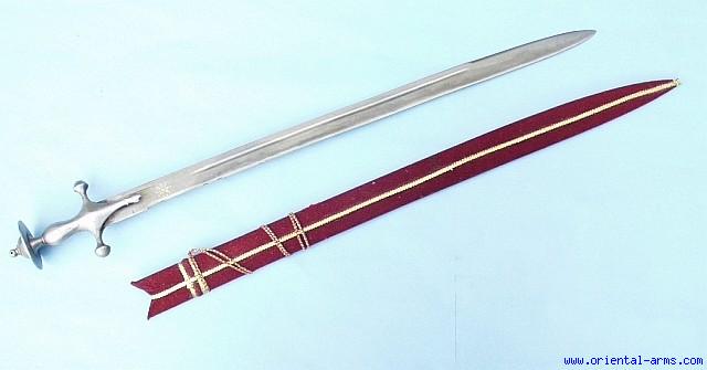

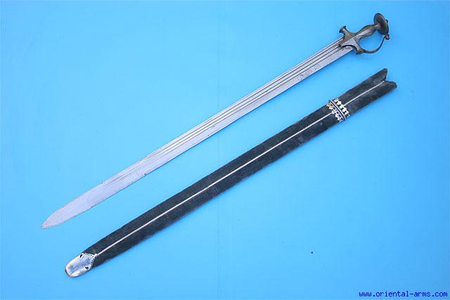

I was thinking along the lines of this type of kirash .
Old 23rd January 2009, 06:34 PM   #20
Posts: 6,025
Strange cross guard. Which might make me think perhaps it never got as north as the Sudanese Mahdist state? This picture is interesting, shows Arab weapons {sea trade?} in North Tanganika. Northern rebellion leader Bushiri bin Salim.
Old 23rd January 2009, 07:57 PM   #21
CharlesS
CharlesS's Avatar
Location: Greenville, NC
Posts: 1,854
Technically Lew, I would not call the blade from Oriental Arms a kirach. I don't think the point of the blade meets the qualifications.
I do, however, know exactly the type that you mean....long slender blade a tip that rather abruptly turns down instead of up. Some Indonesian swords are based on the same idea and similar blade profile.
Charles
What would this be considered? Is the criteria that the point must be lower than the center axis of the blade? If you have a straight bladed tulwar and the point is at the center axis of the blade is it called something else?
Lew

Lew,
That one I would call a kirach. It has a lot more in common with the previously pictured khanda hilted example, primarily curvature, though very mild. On the other hand, the long sword(in my collection, btw) is simply a straight fighter....more along the lines of a stereotypical straight blade firingi, but in the case of the straight sword you have pictured, it's an Indian made blade from the Bikaneer armoury.
I think your observations about blade qualifications are well founded. I believe a kirach, along with the downcurve, generally has some degree of false edge....long or short..., which differentiates it from a sossun patah, again, in general. But, I have seen so many Indian blades that don't "follow the rules", I'd say there are exceptions to practically every "type".

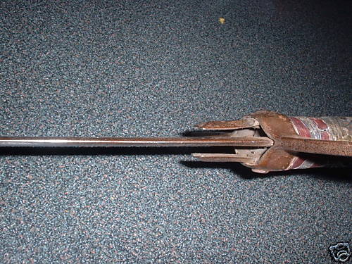

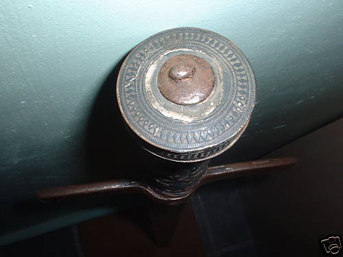

...some more images of the hilt - is it sheet metal welded together rather than wrought? Also I think that there might have originally been a cap on the pommel
stephen wood is offline   Reply With Quote
Old 23rd January 2009, 10:54 PM   #25
katana
katana's Avatar
Location: Kent
Posts: 2,658
Hi Stephen,
with the new pictures you've posted...I can see that the rivet does not pass through the blade.
Regards David

Posts: 6,441
Hi,
Norman.
Norman, this is a bit off the subject; but could you post a picture of the top of the pommel ? I have a very similar hilt that is missing the dome and would like to see how your example is finished for reference .
Thanks !

It just says Sudan to me.
In the absence of Indian markings , I see no reason to invent long journeys and "first example". Occam's razor say local.
Elgood presented Indian sword with a Piso-like handle, and let's not forget Gulabhati " khanda" handle on Sumatran peudeungs. Sure, Indians traveled to Indonesia and brought with them not only weapons but a whole culture/religion.
Nice to be able to be contrarian: some other Forums ( Fora???) would have expelled me long ago :-)
Good note on the 'ricasso' Ariel!
Contrarian? not at all, a different viewpoint yes. Yours is a respected opinion, and different opinions keep it real. Its really been interesting looking into the different views, and I think thats what adds to the learning potential.
Thanks Ariel!
Norman.
Outstanding Norman! Thats what I was thinking of.
Thanks for posting it.
All the best,

Sorry guys but the blade not having a riccasso does not prove anything. I have seen and own two tulwar that do not exhibit a riccasso. Not all tulwar especially from the Northern areas have riccassos these types were influenced by the Persians. See attached photos.
