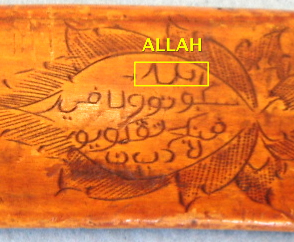

Also, can anyone translate the inscription on the back of the scabbard?

I came across this absolutely stunning piece and noticed that no-one ever checked the inscription.
At the risk of being impolite I would like to ask if Dom or Mohd or any of the other forumites with knowledge of these inscriptions can take a look
Willem
when, it's nicely requested, I can't refuse ... BUT ... it's not Arabic
it's Jawi language, using an Arabic alphabet for writing the Malay language;
- Acehnese,
- Banjarese,
- Minangkabau,
- Tausug and
- several other languages in Southeast Asia.
we may read ... only a single word "ALLAH" either "GOD" ... no more
à +
Dom

Old 8th July 2019, 12:02 PM   #16
asomotif
asomotif's Avatar
Join Date: Nov 2006
Posts: 2,238
Charles,
Did you ever get a translation of the scabbard inscription ?
Willem
Old 8th July 2019, 07:56 PM   #17
CharlesS
CharlesS's Avatar
Location: Greenville, NC
Posts: 1,854
Charles,
Willem
No Willem. Perhaps resurrecting this old thread will help!
Old 21st July 2019, 09:45 AM   #18
Loedjoe
Loedjoe's Avatar
Join Date: Nov 2011
Location: Oxford (UK)
Posts: 96
A friend of mine has had a look at the inscription; it it evidently, at least in part, an attempt at an ownership inscription; she reports as follows:
This is so poorly written it is almost undecipherable:
Allah [or: inilah]
s-k-w t-w w l-a d-y-r
p-n-g-j t-ng-k-w y-w
[k-a]-d-y-n
Inilah (this is)
Teuku ... Kadir
... Teungku Yu....
Loedjoe is offline   Reply With Quote
