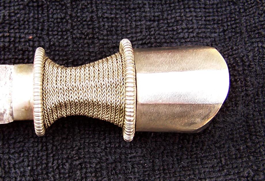

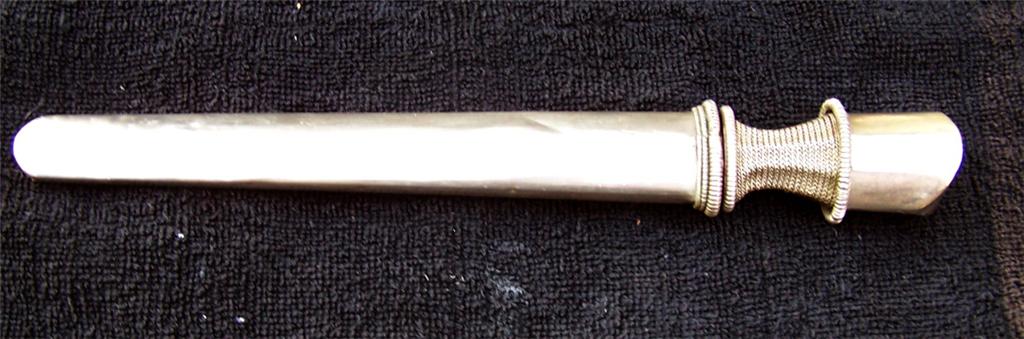

Just picked this up on ebay. It seems 19th century to me and I bet that blade is hiding a hair pin pattern in the steel?

I wouldn't necessarily date it to the 19th century, as the Bhutanese made swords and daggers in the traditional way until about 50 years ago (and had some Indian replicas made later and are now returning to traditional manufacture).
On average, the weapons with the sheet metal pommels are probably more recent than the pierced ones, although the types obviously overlap. Writing in 1910, J. Claude White, a British diplomat in Sikkim and Bhutan, characterized the pierced work, as on the traditional pommels, as almost a lost art.
The pierced pommels were much more expensive. (So what did a poor man do if he couldn't afford a pierced iron or silver pommel? Probably had a bare horn or wood hilt on a working blade.)

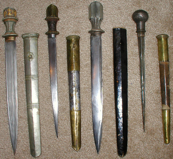

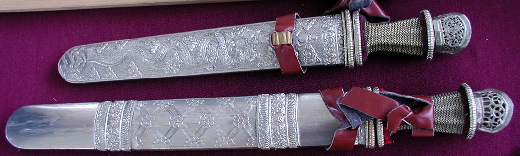

A couple of daggers made in Bhutan recently. The blades are springs but the hilts and scabbards are traditional.
And four daggers of various types and qualities, most 20th century: one with washo (grooves) on a laminated blade (plus a gilt pierced-iron pommel); one with a plain laminated blade; one with a monosteel fullered blade; and one with a doorknob shaped repousse sheet metal pommel and a fluted diamond-section blade.

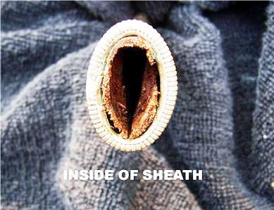

Hey it's not like I spent a lot on the dagger so I won't be disappointed I'm sure it still seems well made. I have an older one and will compare it when it arrives. The inside of the scabbard seems to have wear and some age to it and the width at the top edge seems thick so to me it won't be a thin sheet steel blade.

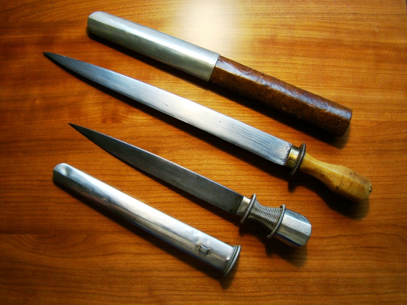

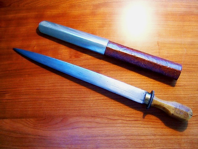

Like this one a poor man's dagger.

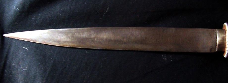

The dagger arrived today blade is mono steel but is about 1/4" thick at the base and is small compared to the other one I have. Still think it was a decent buy.
