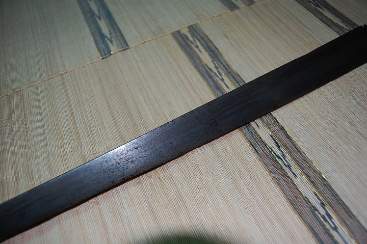

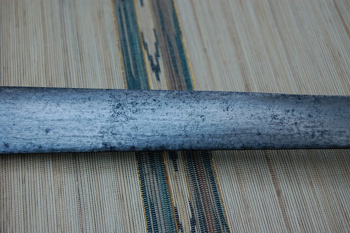

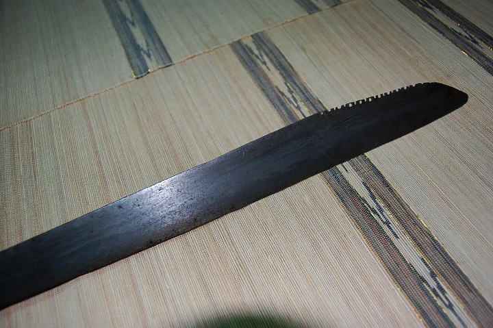

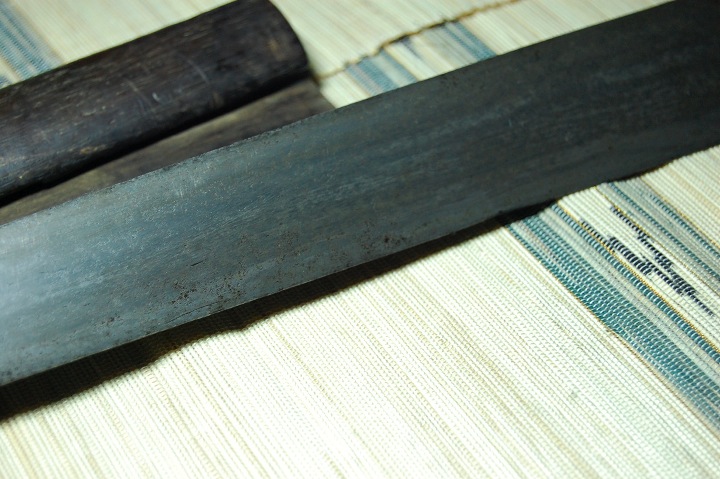

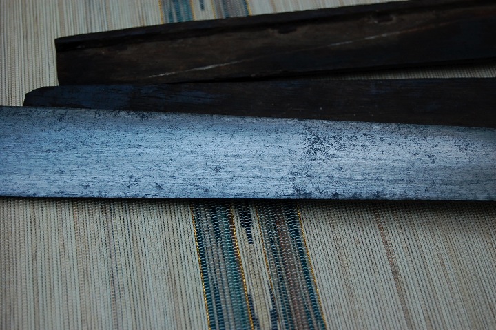

Hello Kai. Thanks too for the additional info and tips. I will certainly try the "wet" blade technique. Would you also be aware of any staining technique, that will make those lamination marks stand out even more? Thanks in advance.

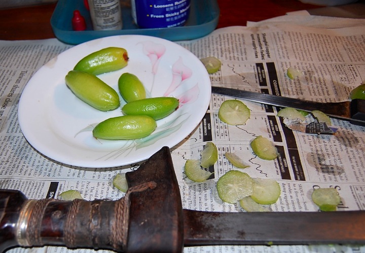

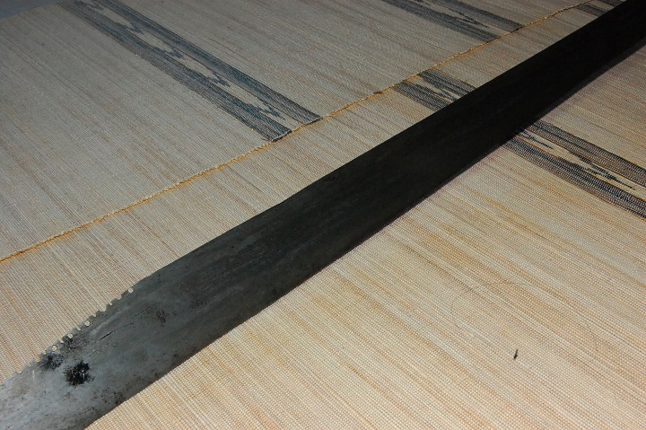

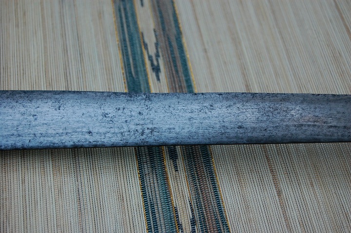

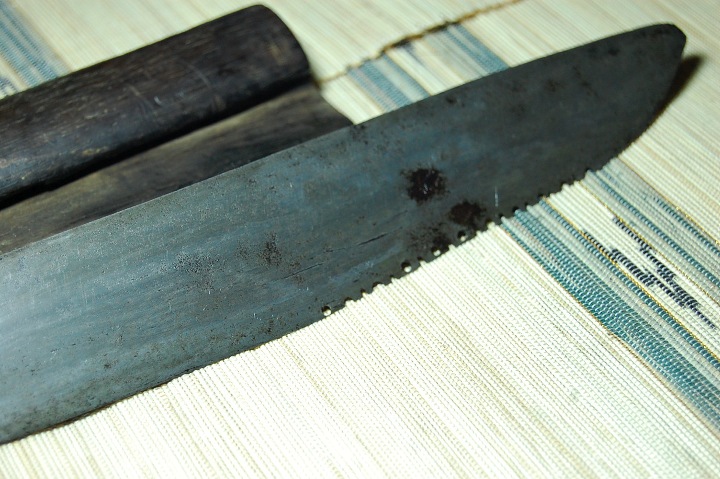

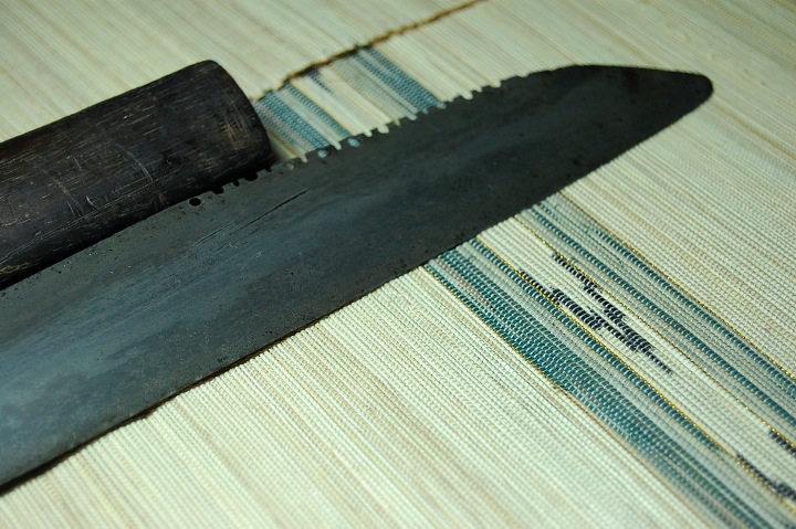

By the way, yesterday I've experimented using a local fruit called kamyas [come-YUSS], as suggested by Kino and the others.
Said fruit is the one on the plate in one of the pics.
The result is encouraging. Whereas before that kampilan's blade doesn't have conspicuous lamination marks, after rubbing the blade with the kamyas for about 20 minutes, the laminations stood out much clearer.
The scientific names of kamyas are Averrhoa bilimbi and Hedychium coronarium. And the active agent in kamyas is oxalic acid.
I think I'll try kamyas again on some other blades and will find out whether the effect is consistent.

Posts: 6,441
That level of etch is fine in my personal opinion .
The contrast levels are what they are sometimes .
Nice pattern .
