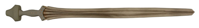

Second issue are the swords that (I think) Jim was talking about, that have relatively narrow blades and rounded, sharp tips. These are the tips I'm talking about, and they go back to the Bronze Age (see attached image of an accurate reconstruction of a Mindelheim type C sword). In these blades, I'd say the tip was blunted so that it would be a decent slashing tip, and not get embedded in the target.
Basically, we've got different possibilities for the reasons for blunt tips. I absolutely agree that broad, blunt tips are great for cutting, and I also agree that they're easier to sharpen. I also think that they can be specialized more for slashes, rather than stabs.

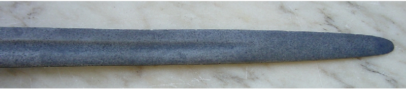

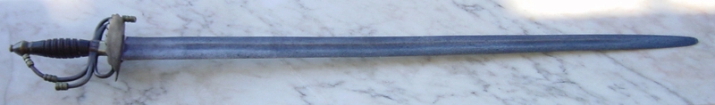

Within my ignorance and in a broad interpretation, apart from the slashing reasoning already exposed, i would say that the acute point in a blade can only cause hazardous situations, both to the owner and to his neighbours ... as also to itself, as passive of easy damage. Besides, if your foe doesn't have a cuirasse, you still can perforate his body with a rounded blade point, providing you use minimum technique ... right ?
Even there are various degrees of rounded points; this other sword i once posted, a Spanish colonial specimen, also has a rounded tip, like others from the same family, although not so dramaticaly domed, like the Walloon.
