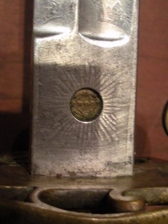

Ooops, my apologies. It's a 19th C. blade's ricasso mark. I'm having troubles taking good macro pictures of objects so small. I'll try to take another one.

What does the WHOLE item look like as that COULD probably give some clue as to origins. What sort of sword is it??

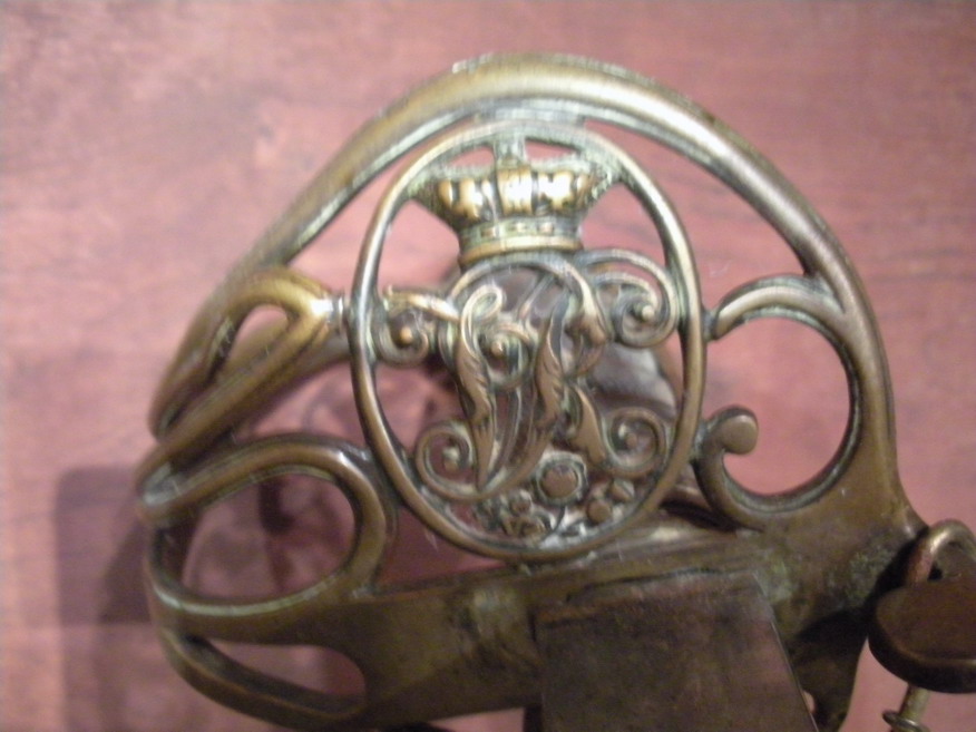

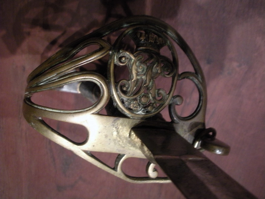

Regular 19th sword, see another pis of hilt...

You will have to post clearer and more informative pics. Looks to be a cypher on the hilt but you don't show it. What does the rest of the blade look like? Are there any other markings or inscriptions which might give a clue as to origins?
In reply to your first question----what you show is a proof stamp on a sword. Other than that I can not tell anything further from what you have supplied.

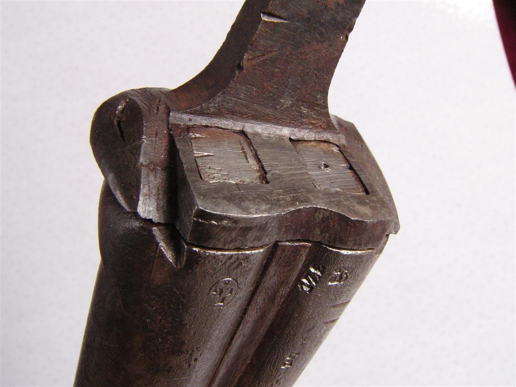

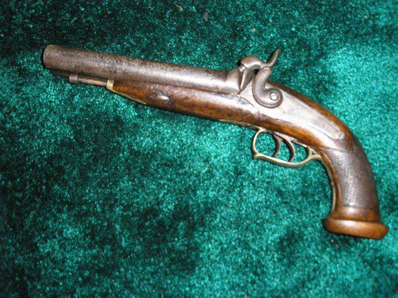

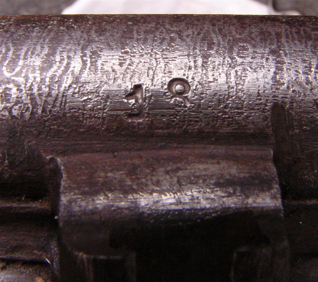

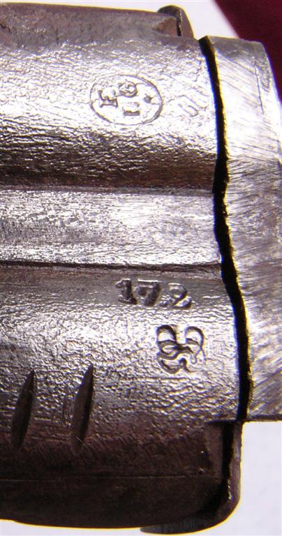

How about my howdah pistol. Double barrel about .70 bore, percussion. Gun shop guy said, "Belgium - 1835 to 1855."
Old 8th November 2008, 03:55 AM   #13
Posts: 2,821
Default Howdah marks
Hi Bill,
Marks are Belgian Proofs as follows:
The oval ELG in use from 1810 and was the SOLE MARK until 1853.
The EL intertwined was introduced 1852.
The numbers, 18 and 17.2 are the bore size in millimeters. Introduced 1810 and until 1894 graduated in 0.2mm graduations. After that date in 0.1mm graduations.
So from the above, your pistol is likely post 1853 and probably pre 1895.
Not quite what the guy in the shop said, but the marks tell the story.
Nice piece by the way!
Regards Stuart

Posts: 1,599
Originally Posted by kahnjar1
Hi Bill,
Regards Stuart
Wow Stuart! Thank you so much!
Great info! So could be anywhere between 1853 and 1894! I'll call it at 1853 1/2!
So one barrel is 18 mm and the other is 17.2 mm? Don't think that I would care to fire it with projectiles, but might try BP and wads.
I have heard conflicting comments about the strength of Damascus barrels. I know they were designed for BP, but some people say that over the years, cleaning fluids and residue get into the Damascus (mainly on the inside of the barrels) and can substantially weaken the walls.
Yet other people say this does not happen. Anyone have an opinion?

Hi again Bill,
Yes, according to the marks, the barrels are of slightly different bore. Regarding interior of damascus barrels. The most usual corrosive agent was black powder residue. OK before fired but when fired the powder residue attracts moisture and creates a real mess if left over time.
If you wanted to fire the pistol, check the inside of the bores with a borelight, after having scrubbed it with a bronze brush. ALSO CHECK THAT IT IS NOT LOADED ALREADY. Some years ago a friend of mine shot his TV with an old muzzleloader which still had a charge in it! The way to check is to put the ramrod down the barrel and compare the depth with the outside. The rod SHOULD measure right back to the nipple. If it does not, then draw the old charge with some sort of long corkscrew if you don't have the proper tool.
Regards Stu

Yes you have a British sword. Queen Victoria's Cypher. Can't tell you who maker is from Proof stamp but is there a name on the other side near hilt?
Regards Stu
