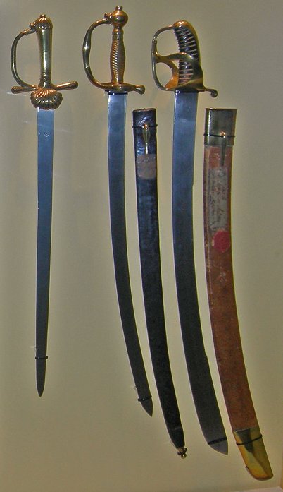

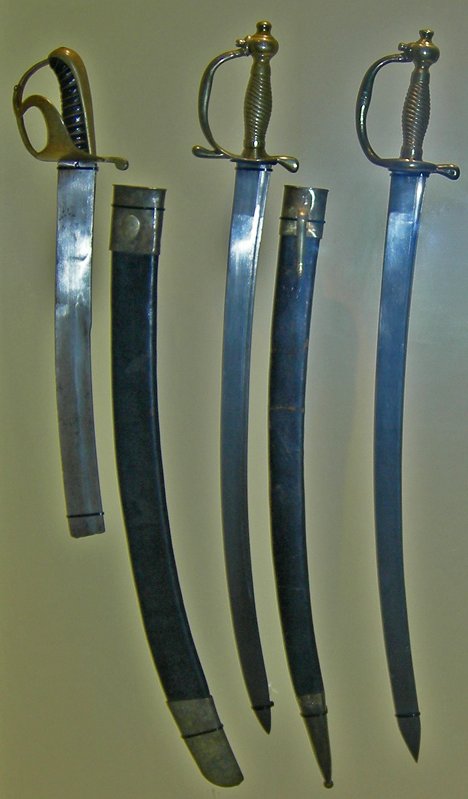

Ok, the text read very much like an
The hilt is quite different, but the blade does seem like it might be of the same "family" as the Swedish infantry cutlass m/1748 and it's descendants (various variants of it seems to have been used well into the 19th century, in the case of the infantry I'm under the impression that it was kept around until the m/1848 fascine knife took over).
The picture with the hirschfänger on the left has an m/1748 in the middle. The picture with the broken saber to the left has a cutlass m/1803 for infantry troopers in the middle, and cutlass m/1808 for infantry troopers on the right.

Hi Kisak, Your m/1748 and m/1808 look like m/1853s to me. They have the knuckleguard screwed to the pommel.
What's the difference?
I have both the purported dansk m/1801 and a couple svensk m/1856s {HUGGAREsvensk, m/1856 (förändring av huggare m/1748)}, and the blades are of different length and width. Plus the latter has a thin fuller close to the spine.

It seems that the m/1748 and m/1808 are basically the same. Berg doens't mention the m/1808 at all, but judging from the sign at the army museum, the Swedish army ceased with the cutlasses in 1806, only to start with them again in 1808. A number of new ones were made for this, and these new ones got labelled as m/1808.
The m/1856 is an m/1748 which has had the blade reshaped a bit with a pointier tip.

I have a sword identical to the "broken saber" in your picture. What's its ID..?
Best
Manuel
celtan is offline   Reply With Quote
Old 31st October 2008, 12:42 PM   #11
kisak
kisak's Avatar
Join Date: Jul 2008
Location: Stockholm
Posts: 182
The pictures are from the Army Museum in Stockholm, and according to them it's an m/1775-1807 for troopers at Savolax' light infantry regiment. It's a "modification model", where the inner guards on the old m/1775 sabers were ground off to reduce wear&tear on the uniforms. The m/1775 in turn seems to be identical to the m/1770 for Savolax' jaegers on foot.
