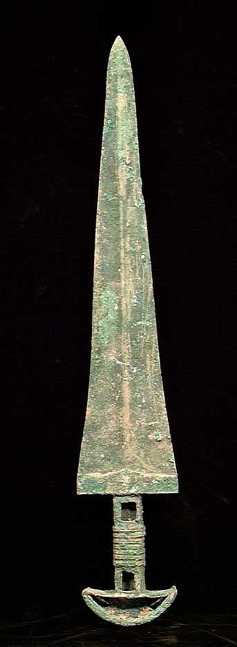

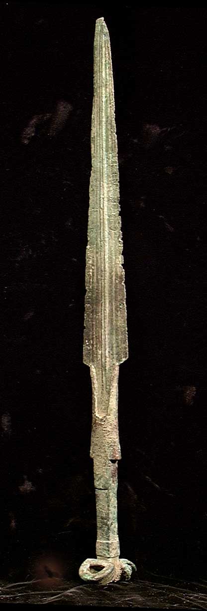

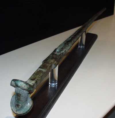

http://www.pbase.com/erlikan/inbox
There you can see 3 samples of bronze nomadic Schytian arms from Azerbaijan. 1 long sword and 2 daggers. Belongs to B.C. 1500s. Their hilt forms are too close to Turkish yataghans and karakulaks. Do you agree that these must be the far ancestors of this type? But there is a huge time gap between these bronze arms and the appearance of yataghans in 17th century. Or does anybody know samples of the lost rings in the evolution chain?
I am little suspicius in ancient weapons. The reason is that I have seen too many fakes and wrong discriptions. If you check Ebay you will understand my point.
Sorry to ask, and dont reply if you dont want to, but who says that theese are Schytian (or Schythian) and from B.C. 1500?
In that time Stonehenge built in England and Athens had its first kings. Crete was building it's colonies, Phoenicians developed alphabet...
No Schytian (or Schythian) artifacts from that era.
What is the materiar of theese weapons? If the quality of the metal is so good as we see in pictures it is equal as the medevial knights had a nuclear bomb They could conquer the world with them...

Yannis, the material is bronze as I told. About being fake or not, as many other, my basic criteria is who brings and offers it to market. I also understand your point of view but , about Schytian artifacts, if you search as" luristan" you will find many. They were nomads and warriors, having a superior bronze casting technology. They were also the first community to train horses enough to be used efficiently in wars starting mounted riding. First bronze, then iron working of nomads were always superior in any age(in general all kinds of metal, gold, silver etc. too), as strong,educated horses and efficient weapons were the things they needed to have whatever they wanted. As far as I know, they conquered and ruled today's Ukraine, Caucasia and Persia for several centuries, later forming a union till Egypt in 8th century b.c. So they have conquered not all, but much of the developed lands of their time .
About the date they belong to, some sources say 8-9th centuries b.c., and I knew like that till short time ago, but at that age, it had been more than 500 years since Hittites found iron working, and all near east was using iron instead of bronze, since it was much cheaper and easier to work. It doesnt seem logical for anybody to prefer expensive and difficult bronze swords at that age (but bronze continued to be used in helmets and shields, I dont know why). .
And, I learned the date 1500 b.c from the site of Azerbaijan national museum . They have samples like mines. They have dated their sample to b.c. 1500. Ariel had given its link in the previous forum. I dont remember it now. He can help us but I am unable to insist on the date as I am not an expert myself.
And one more sign about being fake or not, you can see many samples being sold in respectful auctions (not cyber. Real auctions). I can give you some links if you wish. Most have even much better conditions and sure much higher prices, compared to these ones. (Not only the Schytian ones, also Middle European ones, which was certainly not a civilized land in that age). Bronze stands against corrosion of natural effects under soil uncomparably better than iron. Thats why clean bronze age samples are more than much later's iron weapons of Roman, even Middle age times. But again, my judgement about being original or fake depends on just my feelings and reference books or auctions. The exact result can be taken only by carbon 14 test, nothing else i guess.

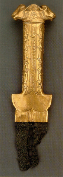

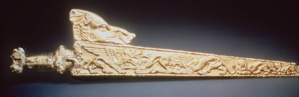

Here are a few examples of Scythian swords that I could find;

Here is a sword similar to one of yours dates to around 1500 BC. found in laristan. (same as yours)
Hope this helps

And to add a little more here is a Scythian hilt;

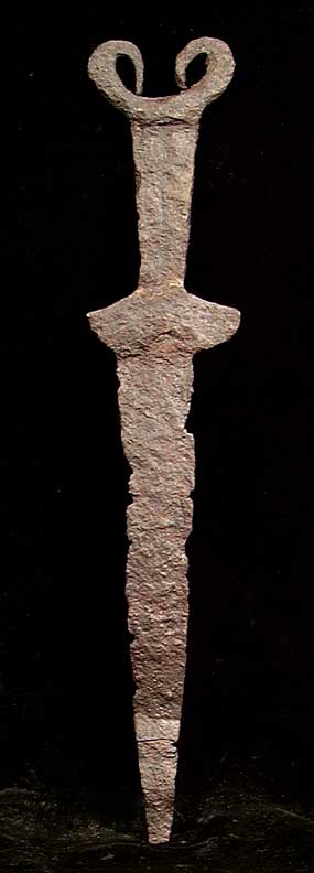

I found these interesting swords thought to be Bactrian 1000BC. Note the ears on the larger one.
Jeff

I just found this one which is thought to be from Amlash. There is a fellow named John Piscopo who posts regularlly on the SFI site that could help you further http://forums.swordforum.com/forumdi...?s=&forumid=12
Jeff

Great job digging this one out. The similarity with Erlikhan's long eared pommel sword is obvious. In order to avoid further confusion, could you please provide the source of this picture, and more specifically the reasons for the dating.
