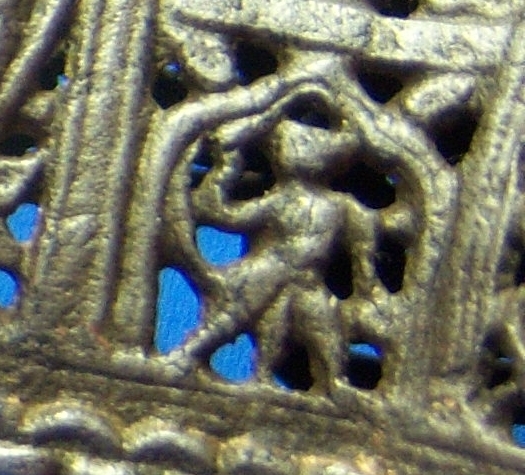

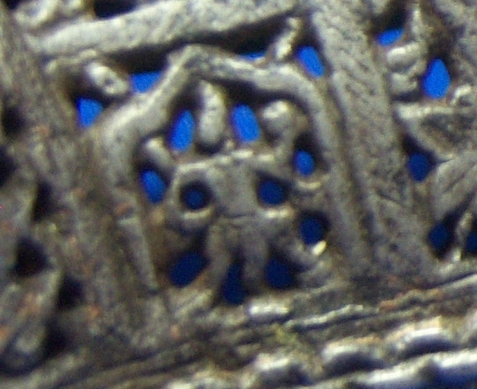

I have zoomed in on the two unidentified figures remaining, and though one is a bit blurry, I hope it is sufficient for you to help with them as well!

The first pic is of 'Hanuman' the monkey headed lord. Assisted Rama in his conquest of Lanka...!!!!
The second ones a lil too blurred however I guess it belongs to Hanuman too.
A little clearer picture should help.

Just my opinion, but the 1st close up bears a close resemblance to 'Vahara' the Boar incarnation of Vishnu. Note the elongated face/snout. As Bhushan has said thouth, the 2nd close up could of course be Hunumaan.

Hi,
Could be but i see a 'tail like' thing which pushes me to believe it is Hanuman.
Maybe a couple of pics could help us get more clarity.
