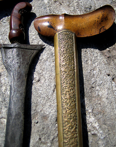

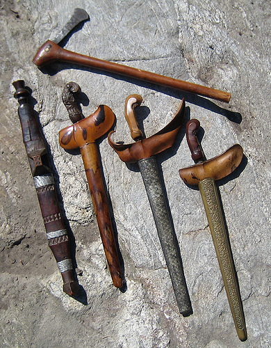

Default My father bought these
32 years ago.
Story goes like this:
My father wich is swedish was working abroud alot before i was born.
In the 70´s he was stationed in Bahrain in the persian gulf for 6 months.
Before he went back home he just bought random stuff, he never wanted to go back to that place so he had to spend all the dinars he had left. He bought these weapons from a dealer with the only knowledge that they were from a Malaysian civilwar, I actually just recent discovered that they were called Kerises.
He was also told that the sword to the left was the most valueble one since it was so old.
Unfortunantly i dont have any other info, i would like to hear what you think!
Time era? Is there any value in these items?
http://flickr.com/photos/27497784@N0...7605522171850/
Thank you!
/ Johan

Hi Johan, welcome to the forum. These are indeed keris. We do not give value assessments on this forum, but we can discuss everything else about these keris. They do appear to be antiques, but they are not particularly uncommon so i think you just must have brought them to the wrong antique dealers.

Hi, all the 3 kerises are Javanese... I doubt that it is used in the Malaysian civilwar (I don't recall there is one(?)).

Good point Shahrial, i am not sure what war he refers to. The one one on the left in the grouping might be from Madura, or it could be East Jawa.
BTW, all your hilts are turned the wrong way. They should be turned 180 degrees around.

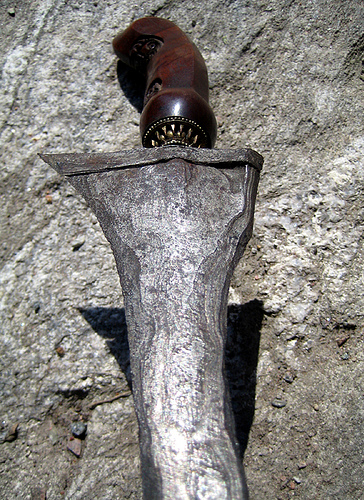

Johan, keris from certain regions can be IDed from a number of factors. Most obvious is the form of dress (sheath and hilt), but the blades themselves take on different characteristic as well depending on the origin. See these difference generally takes looking at a lot of different keris for many years.
Also it is easier to ID origin and age with a blade in hand. Photographs can be hard to read at times.
I think it would probably be safe to say all 3 of your keris are at least 100 yrs. old, but they could be older.
Keris are catagorized in many ways: origin, kingdom (period), dhapur (blade profile), pamor (the forged patterns on the blade), etc.

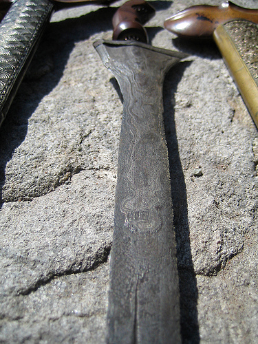

One of your keris (the last close-up shown) has a dhapur called Kebo Teki which is evident from the elongated front area at the base of the blade. Can you see how that area is longer than on your other 2 blades and also has a carved feature that resembles an elephant head/trunk?

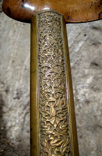

BTW, your Kebo Teki blade is in a Surakarta Ladrang (formal) dress while the other 2 are in gayaman (everyday) dress. The one on the left is either Madura or East Jawa (they are very closely connected) and the other is Dyogyakarta.
Hope that helps you some.
The other sword is from Africa i believe and if you post that over on the main forum, along with that axe, i am sure you will get some interesting responses on those.
