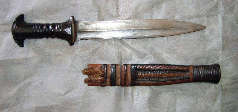

There is a Somali one (scabbarded) on the third photo.

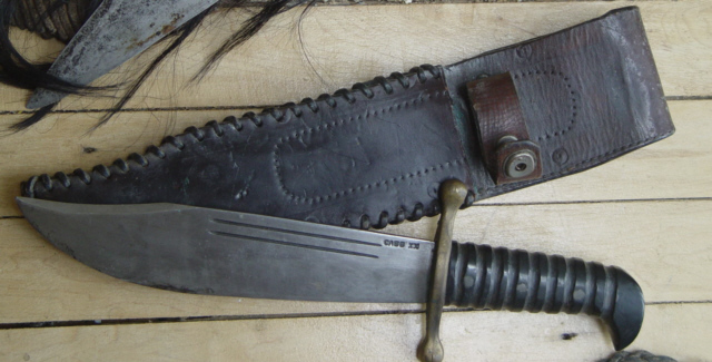

Paul, the khukri is and indian make of the type known as "lion khukri", usually sold in the tourist market, and most probably from the last half of the 20th Century. In the second photo there is an old style bowie and a kind of beaver tail knife, also not very old, but older than the khukri, I could not say. In the third photo, the last one below, looks like a Fairbairn-Sykes british commando knife made by Wilkinson Sword. If it is original and not a copy form other country, it has some value. I can ID the bayonet, latter.

the 'beavertail' knife is actually made from a sheep shear, it's a popular conversion in wooly areas. another thread on them here: Linky
i note that the shear blade was made in sheffield, so it could have come from almost anywhere, US, Australia, New Zealand, etc... one more skilled could probably figure out where the stag for the grip came from.
the bowie accompanying it is made by Case & it's still available today, tho that one looks like an earlier model. here's a more current one:
the older one appears to have had some modifications to the grip by an owner to improve the grip, the originals are a bit slippery when wet.

The dagger in question is of Hausa origin from Nigeria not Somalia.

I agree with Lew, a Hausa dagger ....mid -late 20th C ??

it does look a lot like a beaver tail knife, they were popular with some native american tribes, i seem to recall that the french supplied a lot of the blades.
sheep shears are made of excellent steel as they need to stand up to a lot of abuse while staying sharp, they lend themselves to conversion into knives of differing configurations, as shown in the link i provided. (each shear makes two knives too!) the unusual tang makes them a very distinctive style when you know what they are. crazycrow has a kit for making your own beaver tail knife, or if you are so inclined, you can buy a sheep shear via ebay and experiment, i'd suggest specifying the non-offset style shear.

Looking in Ron Flook "British and Commonwealth Military Knives" these two appear to be; wood handle knife- Royal Navy deck knife, non-magnetic. Still in production for NATO.
The bowie type is a version of ww2 Australian made V-44. Made for AUS and US military and private purchase.
