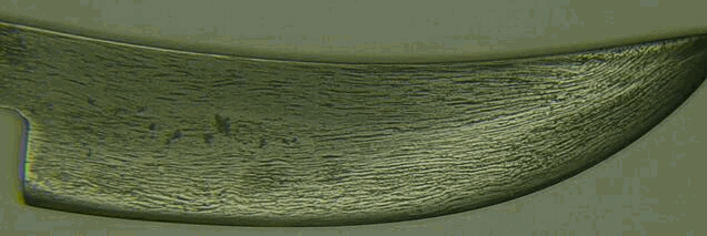

in regards to the sham pattern.. which by my definition is a pattern of straight and course waterings can be produced in hypereutectoid steel.... the way i've done this is through the technique of hammering the steel....
generally when you hammer steel, the face of the hammer has a crown or curvature..... and this dimples the steel causing it to flow outward...
- the hammer face has an effect on pattern
-- if you hammer with a flat faced french hammer... you distort the pattern very little...... and the waterings will be straighter
-- but if you use a small narrow face hammer with a curved crown...it'll give a very busy watering (this is all excluding cutting or drilling grooves for pattern effects)
i aggree with the waterings getting finer the more forge cycles.... since I hand hammer all my ingots by myself..... the few times I was lucky enough to have an apprentice, the pattern was coarse
- at the moment it takes 2days of forging with a 8 or 12lbs hammer to get the ingot to barstock
- as you can see on the net.... most other smiths use powerhammers and presses to make wootz.... so their patterns are usually coarse
- i suspect that in ancient times ...to produce a coarse pattern the master smith would have two apprenti, sledging down the ingot...... reducing the forge cycles dramatically
this is just my opinion
thank you for your post... it is wonderful !!!
Greg
here is a pic of a straight waterings... with the matrix oxide buffed out
Gt Obach is offline   Reply With Quote

Thanks Greg for the info on forging. It is something very important but I have no practical experience at, and need imput from those who do. I would like to know how many man hours it takes to forge a knife or sword from ingot to finished product, using traditional forging methods, also how long it takes to sharpen and clean. For ethno-archaeometallurgical studies this is significant.
A standardized nomeclature for patterns does need to be further developed, but is tricky. I have more details on this and only included a bit here. The characteristion of Sham as hypoeutectic is not my "opinion". It was based on previous peoples characterisation (I think Verhoeven, Sashe, and others) together with metallurgical analysis.
