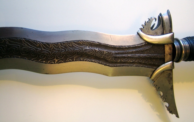

Here is a Sulu, or Malay, Kris we discussed a couple of years ago.
