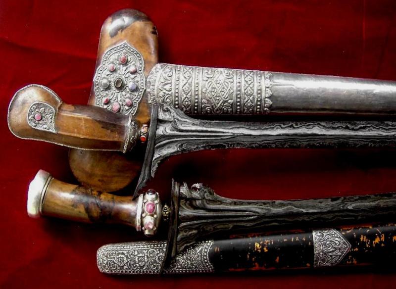

here a pic of kerises bali with pamor on the gonjo.
brekele

Thanks for posting the photo Brekele. When would you say these keris were made. The dress looks fairly recent to me, but i can't get a good grasp of the blades without better and closer images.

Hi Dave, those both keris are old but one of warangka with silver decoration and gems is new made (top) and old made warangka (down).

As Brekele has shown, and as Rick in his original post indicated, the plain black Bali gonjo is not a universal phenomenon. It is common, yes, but it is not universal. Amongst my own keris I have a number of old keris with pamor gonjo, I also have a number of old keris with plain black gonjo. I have two keris of extremely high quality with gonjos lacking pamor, but adorned with kniatah work.

Old 16th March 2008, 02:24 AM   #20
Posts: 7,255
Kai, clearly if something that has added to cost in a weapon exists, then it must have been deemed to be necessary, for one reason or another.Its very existence demonstrates its necessity.
Nowhere have I claimed that the primary objective in weapons manufacture is to keep costs as low as possible.
What I have claimed is this:-
an iron gonjo is cheaper to produce than a pamor gonjo; it was not considered essential in old Bali to have a keris with a pamor gonjo, thus cost of a keris was reduced by fitting of an iron gonjo.
To demonstrate that this opinion is wrong it will be necessary to show that:-
1) a pamor gonjo does not cost more to produce than an iron gonjo
2) it was considered essential in old Bali to have a keris with a pamor bearing gonjo
3) the inhabitants of old Bali had such excess of resources that cost of the production of a pamor gonjo was of no consequence.
If it can be shown that all, or even one of these things is so, then clearly I will need to reconsider my opinion.
An adequately supported alternative opinion as to the reason for the predominance of plain iron gonjos found on Balinese keris will also cause me to rethink this matter.
Old 16th March 2008, 03:06 AM   #21
Posts: 6,441
Originally Posted by kai
Hello Rick,
So, what's your definition of pamor? As long as Pamor Sanak qualifies as pamor I'm deadsure we have pamor with Moro kris, too. At least the twistcore kris are welded of different (iron/steel/alloy)s to make a specific visual pattern. I don't see the point why a certain pattern (or some diversity) needs to be present to meet any qualifying criteria.
Hello Kai,
I guess we could call the twist core kris pattern pamor sanak; but personally speaking I would be more convinced of this if I could see other recognisable Indonesian pamors evident in Moro krisses .
If there is only one pattern present in Moro kris that we can attribute an Indonesian pamor name to I will remain unsure on this matter .
Perhaps a separate thread about pamor in Moro krisses can be brought up in the Ethnographic forum .
I will be gone from the Warung until April fourth; so if I fail to respond to further posts from today on until that date I hope you will all understand .
I will be Hawaii bound at sea (can't wait!) .
Aloha for now and mahalo for your response Kai .
My best,

Hello Alan,
This is the only point/hypothesis I'm trying to keep an open mind of.
Perhaps "desirable" would be preferable over "essential"...
