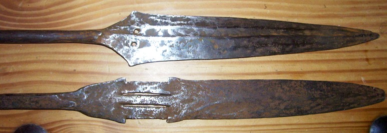

Hi
please could someone tell me the spears origin...I believe from the Congo. Sellers pictures below, interesting handle/spear butt.
OAL 57"-58"
Thank you
Regards David

Nice pieces, David.
The one with the bulbous shaft is definitively from Northwestern Congo. These were found amongst several tribes, such as : Ngbandi, Bati, Benge, Poto, Ngombe, Gens d'Eau.
Although I must say that the blade of this spear makes me think of another origin (So, Olombo and Lokele from Northeastern Congo). But it could well be that a Northeastern blade found its way to another area.
The one with the slender blade looks Eastafrican to me.
The third one is a bit of a puzzle. It has a strange blade. Did you buy these pieces ? If so, perhaps you could send some better pics when they arrive.

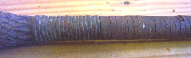

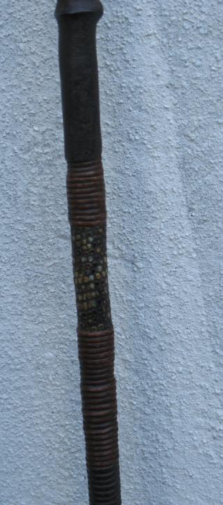

Spears have arrived, very pleased with the thrusting spear, seems quite old. The other Congo spear is of all iron construction, heavy-ish and plain. I assume that this particular one is another thrusting type. The surface patina suggests great age and use, the entire shaft is forged (not re-bar) I can see no evidence that there were any bindings for a handle. The third spear is a nice light throwing spear with a very nice balance, and a nicely patinated wooden shaft.
Below are some pictures of the two Congo Spears.
I wondered whether the carving on the 'smaller' bulbous area had any significance to tribe or status......or perhaps Talismatic.
Comments / suggestions gratefully received
Regards David
Old 20th February 2008, 07:55 PM   #7
Posts: 5,935
Interesting all iron spear, I like very much. It suggests to me a currency spear rather than a weapon. Nice find.

Interesting all iron spear. I have never seen one coming from Congo, but I'm still young (I think )
I looked it up in some of my books and I discovered the following information :
In 'Dodelijk mooi' (Deadly beauty) I found a (bad) picture of an all metal Congolese spear (page 73). According to the author it originates from the Popoi and/or Makere. These are tribes living in the vicinity of the Mangbetu (and also the Zande).
I'm not saying your spear is from one of these tribes, but these are the only ones I could discover who use all iron spears.
On page 51 in the general description of the different types of weapons, the author states : "the shafts (of the spears) are usually made from wood, but some rare examples exist made entirely of metal.
So, David, hang on to it !
In my collection, I have one all metal spear. This piece is from Kenya or Tansania. It comes from the Masaai. It's a spear used by uncircumcised boys when they watch over the cattle.
This spear resembles a long iron rod, with only the top end flattened to form the spearhead. In Christopher Spring's 'African Arms and Armour' there's a mention of such spears on page 112. There it is called 'esururu'.

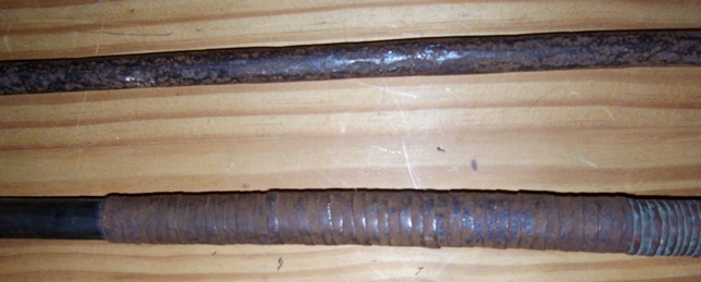

Here are two pics. It's difficult to take a pic of the whole piece. It's about 1m70 long and consist mainly of a metal rod with a flattened head and leather handle.

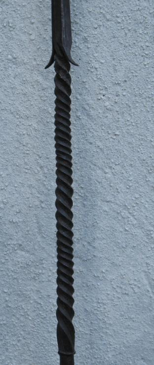

nice spear I have only one more 'all metal' spear which I posted awhile ago. It is one of my favourites.....as it is unusual and nicely crafted. I didn't realise you posted your 'esururu' before ...on the same thread as this 'other' spear.....
http://www.vikingsword.com/vb/showth...ht=masai+spear

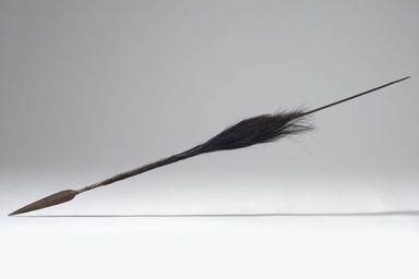

I have now found the possibillity that this one is likely from Angola or nearby .... caption for picture
Culture: NGUMBI(HUMBE, VAHUMBE)
Locale: BETWEEN CUNENE AND COPOROLO-TCHILENGES RIVERS
Country: ANGOLA
Material: METAL,HAIR,CORD
Dimensions: L:108 W:7.3 [in CM]
