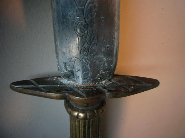

I wouldn't think that SA being Spain Albacete fits in. Would quicker bet on owner's or maker's initials.
Where are these initials placed ? Could you come back with close pictures of those ?

Here is a photo of the initials S(?), A., placed on the base of the blade closest to the guard. I agree that the initials are of the owners. I believe that the engraving was done in the Philippines and not original to the blade. It's what makes it Filipined , thanks B.
