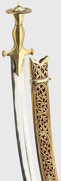

Ariel, here is the picture of similarly shaped brass hilt of late 19th Cent.
Also, it is very nice of you, as an expert, to be asking us for advice on how to clean and etch the blade:-) It makes us feel a bit superior:-)
