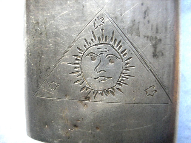

It is indeed rare to find weapons that could be positively attributed to the Katipunan movement. Furthermore, European daggers are often mislabeled as Katipunan relic. Just because it is similar in appearance, it's not necessarily a Katipunan sword or dagger. Instead of guessing, one should look for definite Katipunan marks or symbols before labeling such weapon as "Katipunan".

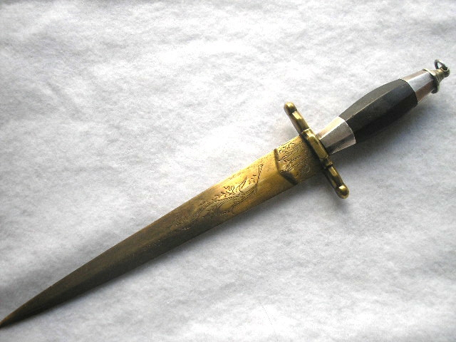

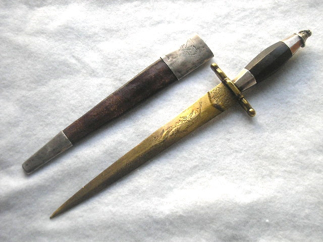

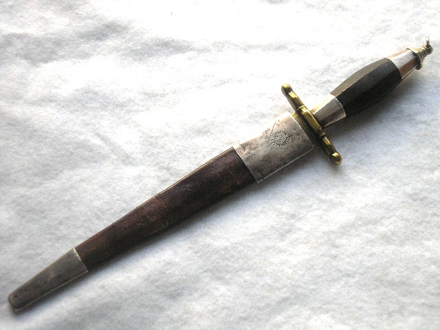

Here are some other pictures of the piece by permission of the happy owner.

Jose, You have one very lucky friend! I really wanted to add this piece to my collection for two reasons. First is its being a Katipunan piece and second is the brass blade. Unfortunately it went for more than my meager budget could afford. Having the engraved sheath is just icing on the cake. Again my congratulations to your friend for getting this great dagger.

It is indeed a beauty of a dagger.

I would have gone for it except that I was sick and could not bid.
Yes it is a unique and beautiful puppy, and my thanks to him for letting me share his pictures with you!
