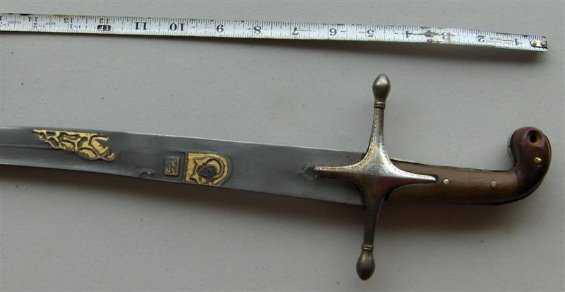

Default Early Islamic Signature

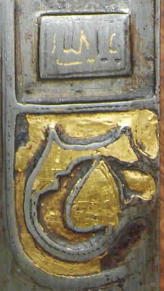

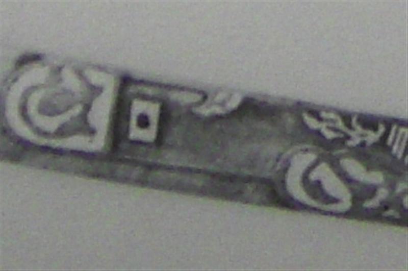

Is the signature or inscription readable? Is on an early Islamic blade.
http://earlyislamicsword.blogspot.com/

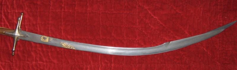

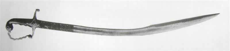

Default Whole sword photo

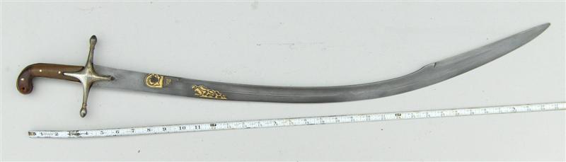

Whole Sword Photo
Overall length 35 &1/4"
Blade length 31"

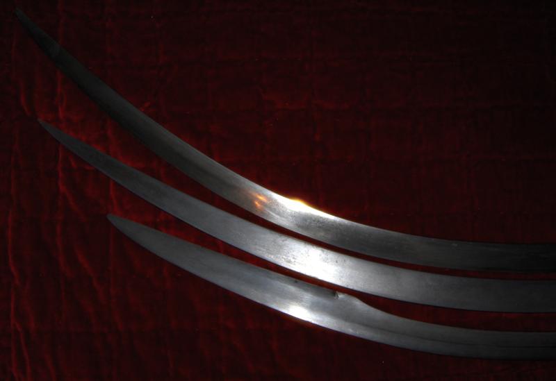

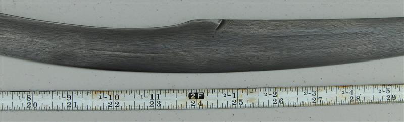

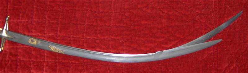

Default Blade curvature photo study

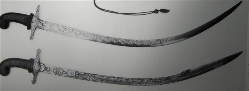

This is a blade curvature photo study of the kilij compared to a very early shamshir blade with a shallow curve. The kilij sword is laid over the top of the shamshir on the bottom photo and the shamshir laid over the top of the kilij on the upper photo. Its shows that the two swords have very similar blade curvatures.

Default Kilij compared to classic shamhsir
In this photo the kilij is laid over a classic shaped shamshir from the period of SHah Abbas. You can see how the curvature changes when the blades near their tips. The shamshir underneath has a very long 35" blade that makes the kilj look short, the kilij blade is 31" in length.

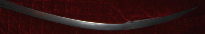

Default Comparison of the three tip sections

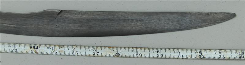

Comparison of the blades front sections side by side

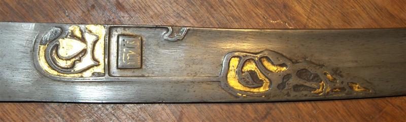

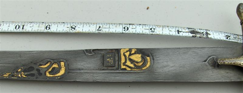

Default Gold overlay

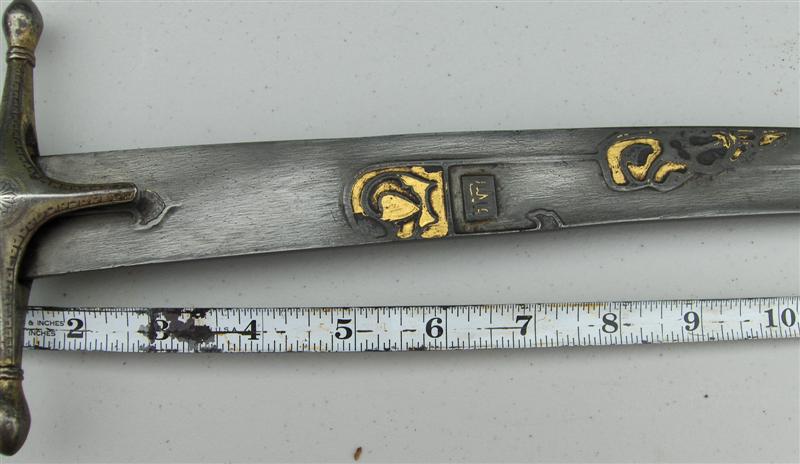

Notice how thick the gold is overlayed in the design,

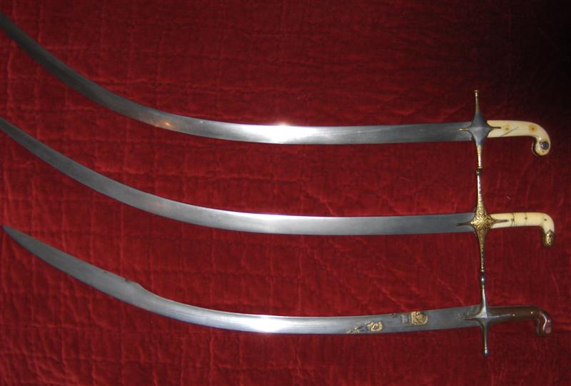

Default Three swords in photo study
These are the three sword in the photo study above.

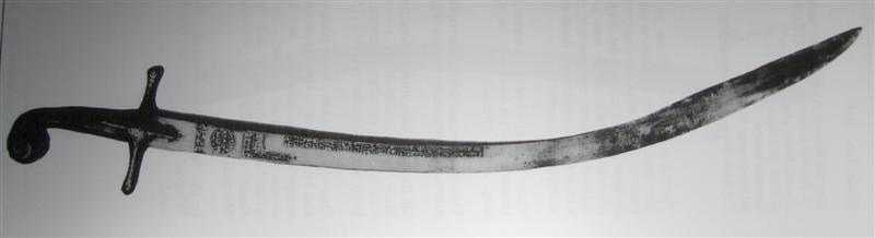

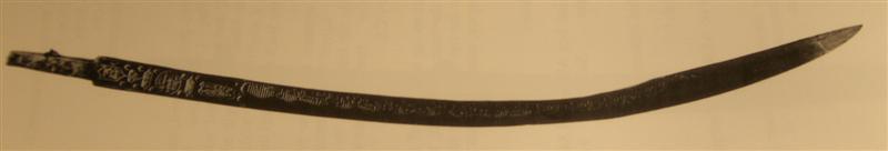

Default Reference for design on kilij
Here is a reference for the design on the kilij, its on a sword at the Metropoliten Museum of Art that was made for Babur bewteen 1500-1526. The black and white photo is Baburs sword and Baburs sword with close up of design on blade.

Default Translation
rand
Have been comparing top inscription to Islamic alphabets and am wondering if its says either "Allah" or " something Allah", your help is appreciated....
rand

One thing to note is that on the raised areas of design the steel is a dark color, in a raised areas such as this you would expect to have scabbard wear polishing the raised steel areas bright. You can see how the wear has even worn away some of the raised steel decoration in places. To me this implys that some has stained the blade in recent years to bring out the pattern in the steel and did not want to risk damaging any of the gold decoration when repolishing avoiding getting close. Will contemplate this over time as it may be something to correct.

rand
Am working on translating this, are there four a's ( one vertical mark for beginning "a" and the three short marks on bottom for middle a's) and two l's?

Default Translation of signature
Thanks to Sancar Ozar and his fellow Turkish Art historian have a translation of the inscriptions.
"Sorry for the late answer. I sent pictures of inscriptions on the kilic to a fellow art historian friend of mine from university who is very experienced on translating old letters. He was very busy and so he could return my e-mail today.Anyway according to his mail inscription in the picture is translated as "Bismillah" (İn the Name of Allah). He only could partially read the second inscription(which is in the right direction in the last picture you posted) because the gold inlay had partially come off. İt is a word, something like "namirun"(well, it is how it sounds when you write in Turkish,I guess it should sound like "neameeroon" for english sepakers). I have no idea what it means."
Thank You again Sancar and friend.....

Default Namirun
Looked up namirun to see if it was Arabic, turns out it is and means tiger....

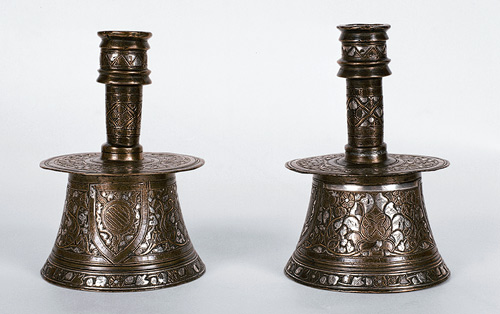

Default Decoration on Blade
Mamluk style places great emphasis on abstract geometrical patterns. Mamluk door panels is an example of absract geometrical pattern and Mamluk/Venitian candle sticks combine the absract with a floral design.
The raised designs on the blade with heavy gold overlay are an abstract geometrical floral design, you can see the vine and leaf if you look carefully.
