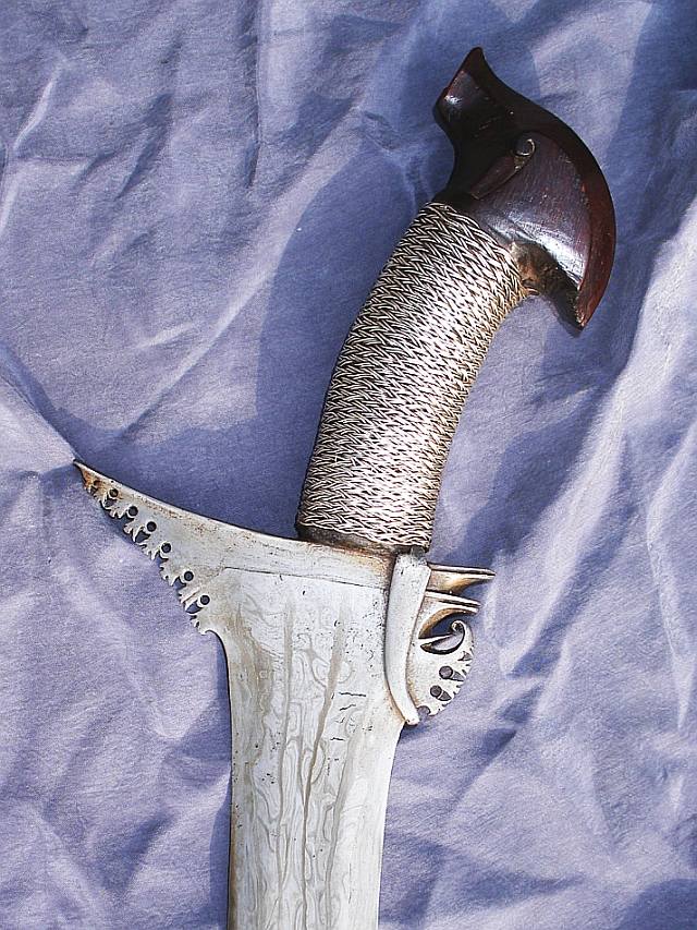

Welcome to the forum Jazz. Very nice kris, especially for that money...however, i sincerely doubt it is older then late 19thC.
For some reason none of your close-ups appear, but the profile of this blade is nothing like the "archaic" kris from the 1700s.
The inlays look nice. As for the inscription, perhaps you could re-post your close-ups. Very doubtful it would be in Jawi though. The scale pattern is not one we haven't seen before and i am sure you will see a few posted by other forumites. I don't see anything particularly rare about the kakatau, but again i can't see the close-ups.
It certainly is a fine weapon and i would be excited to own it myself (especially at that price), but i am afraid it is not particularly odd or rare. Congrats on a great buy though.

I must agree with David. This looks like a late 19th/early 20th C kris with an even more recent hilt. The hilt was probably made in Mindanao, but the blade may be Sulu.
Nice kris at a very good price. Congratulations and welcome to the Forum.

I agree with Dave and Ian. I also suspect that the hilt wrap is a later replacement for missing bands - it is missing a silver ferrule to at least match the silver top. Try your closeups again please.

Also, another telltale sign would be the ukkil decorations on the handle.
Going back to this kriss's age: my assertion of it being from the 1700's were based on the size of the sword, which is 'diminutive' compared to the later ones; and more importantly, the rare transitional pommel style which is a cross between the 'ancient' type cockatoo and the more 'modern' type which tends to have a longer beak and flared out plume, albeit narrower in total width.
to be continued...

It's possible that the handle is not original to the blade, but I would dare say that's highly unlikely. Another evidence that this was an older sword is how the length of the handle is smaller than the more 'recent' krisses. Yes, there's a possibility that it could be a boy's kriss, but one must remember that people a few hundred years ago were slightly smaller than their present day counterpart, not unlike us compared to our predessesor in this country a century or so ago.
Now here's the best part: the inlays on the blade. I have seen some of the more common designs and patterns in this forum, but I can't find a single pattern similar to the one on this kriss. I'm preplexed as to what it signify, half guessing that perhaps it represents the scales of a snake.
But what's throwing me off are what's on the tip of these inlays. Please note that it's not in mirror image on both sides, a common trait with decorative inlays, rather it's two different designs altogether.
I'm not really familiar with the native writings of that era, but i'm half guessing it's either jawi, and if it is, it's someone's name (original owner? sword's name?), OR some type of symbol related to the beliefs of the culture at that time. Another curve ball is the fact that if the blade represent a snake in motion, and the inlays are scale, then why would the handle represent a bird's head, as we now take for granted? As far as I'm concerned, there are no mythological creature of this type in Moroland, a half snake/half bird creature. This is where I would like to hear everyone's opinion. From what I've seen and read from previous posts, there seems to be no shortage of intelligent members in this forum. Perhaps, by posting this here, it could be analyze or even identified by the house experts. I would really appreciate on whatever else comments that any of you can add.
Otherwise, I think that it's a real neat sword, far cry from the replica and cheap swords that I ever own. Although this kriss is much lighter, I'm just amazed at the balance of this deadly weapon, still sharp from all these centuries. I realize that this is not really my field of expertise, so whatever I've written are purely my opinion, but nevertheless, I hope I haven't offended anyone with my writing. Thank you for reading my first post.

Thanks for everyone's welcome! That was my first guess, that it's a late 1800 sword, when I saw it the first time, but there's something about the way it handles. Also I forgot to mention that the length of just the blade itself is 19", smaller that the typical krisses that was common during the revolutionary/phil-am war and later era, when these swords were more flamboyant and bigger.
As far as what you mentioned Bill, in regards to the smaller cockatoo pommels; that's exactly what I was trying to say, that the smaller ones (smaller that what I have) are truly archaic, perhaps late 1600's/early 1700's, and at some point there has to be a transitional period and I am assuming that this type of cockatoo pommel are the missing link. That is just my opinion , though. And yes, I have etched this, and a few 'marbled pattern' appeared, but I've decided to leave it as it is, since I don't really see the point of the pattern over-riding the inlay pattern. Btw, can you tell me more about the inlay? The Indonesian angle is a possibility as well, but I really don't have any provenanced example to compare it with.
As far as what you mentioned, Battara, the handle wrap is old, and again, I would assume it's original to the sword rather that a rewrapped in the later period.
David, could you please explain what an archaic kriss profile would be? I would like to compare this with what I have. Thank you in advance.
Ian, I was under the impression that later hilts were bigger and more flamboyant, therefore I would respectfully disagree that the smaller ones are recent.
Again, thank you for everyone's assessment, More comments would be truly appreciated.

Jazz, if you own Robert Cato's book Moro Sword you can find examples of the "archaic" form of kris which he would date to the 1700s. I don't personally own one of these so i can't post one, but they tended to be less wide and with less and deeper curves. They were probably used much more as a stabbing weapon than a slashing one, more like their Indonesian keris counterpart. Though you cannot see the full profile of the blade i believe Rick's second posted kris, with the ivory kakatau, would be an example of this type. Note also how the line of the gangya goes pretty much straight across on this blade as opposed to yours or Rick's other example where the line takes a 45 degree turn. This is usually another sign of an earlier blade.
Now that i can see the close-ups i am not sure what it is that you believe is writing (Jawi or otherwise). I think that all the inlay is just design features and not intended as writing.
As for the size of your blade, i own 2 kris which date to not earlier than the late 19thC that have blades under 20". I don't think this is a reliable factor in determining age. It is true that the "archaic" forms are generally smaller blade (around 18"), but certainly blades in this length range were made into the 20thC.

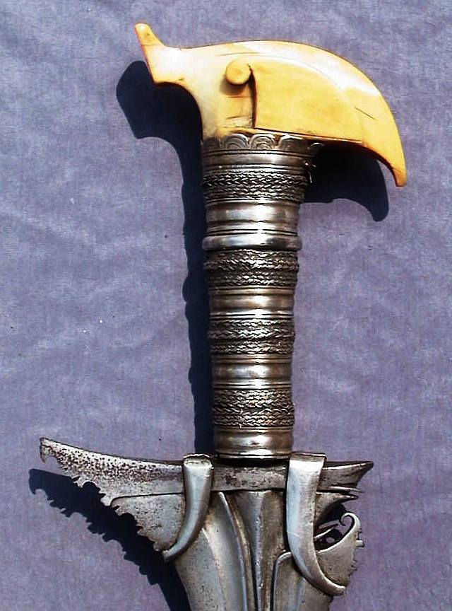

At first glance, I thought it was a Sulu piece, but upon closer examination, it's actually Maranao. What is so intriguing about this is the fact that it's an older Maranao blade (1700's) based on the elephant trunk, which was made cruder compared to the later ones (1800's to 20th century).
I do believe that this really is Sulu style rather than Maranao: AFAIK, that "Maranao bulge" isn't decisive - it needs to be accompagnied with a mouth parallel to the gangya to point to a Maranao origin. I'd guess it to be 100-150 years old.
Even with the non-traditionally rewrapped hilt a bargain. Congrats!
The pommel is genuine and has some age but it's next to impossible to verify wether it's original. Smaller pommels were utilised into the 20th c. AFAIK, so they don't help much with dating a piece. Some Sulu (and Indonesian) kris seem to have small hilts (with narrow grips apparently intended for small hands) - including later examples.

Bill, it appears as if the pommels on our kriss is identical; as a matter of fact, it is!
Just quite - there are subtle differences in both!
As far as the Maranao bulge: this kriss is interesting in that it's angled enough to be mistaken as Sulu, but yet the small bulge (see picture above) kinda threw it off, hence my theory that this is an earlier form of a Maranao bulge, IMHO...
It seems to be the other way round: the angled mouth/beak makes it Sulu - (regardless wether there is a bulge or not: it seems that the Maranao modified an already existing design). However, like in all things Moro, there will be probably exceptions...

I'm with Kai on this - this is a Sulu blade.
Also the inlay I agree is probably snake scales, but near the top is not jawi but okir decoration - very common on these in this way.
A very nice piece. Shame some of the inlay is coming out.
On the "elephant" I have seen the exact same thing on those of early 20th century pieces (I even had one once).
As far as the pommels are concerned, it is the very small ones that seem to be older in general.
