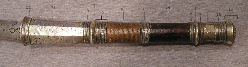

I finally took detailed measurements of two of my dha of this style. The first is the one in your first post (DRI #0049; HOS #250).
Blade length: 50 cm
Handle length: 31 cm
Blade Width (height)
at base: 10 mm
at narrowest point (about 8 cm from base): 26 mm
at widest point (essentially at the tip): 40 mm
Spine thickness
at base: 10 mm
at 1/3 length: 4 mm
at 2/3 length: 2.4 mm
1 cm from tip: 1.5 mm
As you can see, the blade taper is very dramatic at first, going from 10 mm to 4 mm over the first 1/3 of the blade, then quite gradual for the rest of the blade.
Then I went kind of crazy and made detailed measurements of the handle sections, noted in the photo below (all measurements are in millimeters).

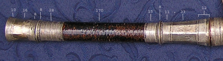

Here are the measurements of the second one (DRI #0066; HOS #248). Another one I have (DRI #0067; HOS #249) has very similar dimensions.
Blade length: 44.7 cm
Handle length: 26.5 cm
Blade width (height)
at base: 26 mm
at narrowest point (about 6.5 cm from base): 22 mm
at widest point (about 34 cm from base): 32
Spine width
at base: 9 mm
at 1/3 length: 4 mm
at 2/3 length: 3 mm
Again you see very dramatic tapering at first, decreasing by over 50% over the first 1/3 of the blade length, then a much more gradual taper to the very thin tip.
Here are the details of the handle, all measurements in millimeters. NB, the two wider rings within the two silver sections have a triangular cross-section; the 8 mm measurement is of the base.

PS: regarding fittings, the wide bell-shaped ferrule at the base is often polygonal in cross-section (I forget the number, but I can check), though sometimes it is circular.
PPS: I have been tabulating these various measurements to see if I can detect a pattern, but I have let most of my research idle this last year, unfortunately, so it is not yet complete.
