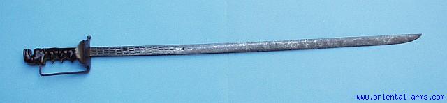

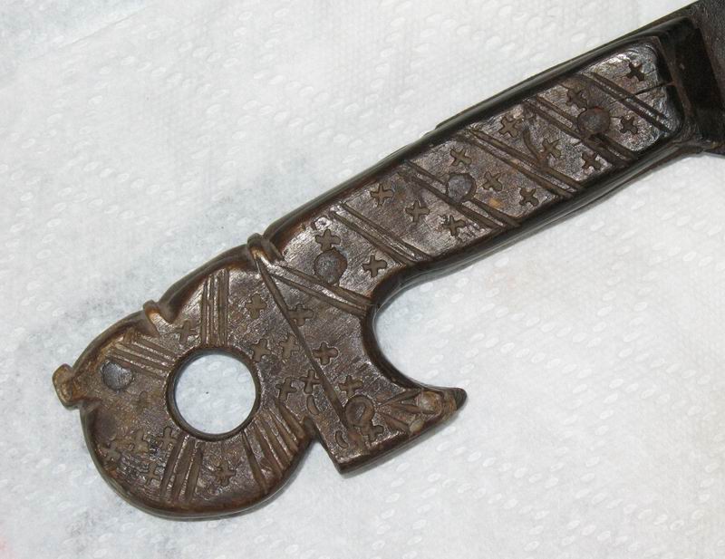

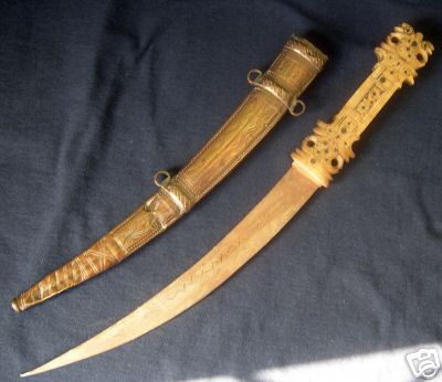

Searching the forum, I was able to find a shula, posted by ErnestoJuan, with hilt decoration quite similar to the decoration on the hilt of my example - note the little crosses. Here is also a close up of the hilt of a sword sold by Oriental Arms, and its inlay to me looks similar to the inlay found on the hilts of certain daggers from Mauritania. Although the Latin initials certainly complicate this theory.
Finally, I have attached a photo of a sword, Artzi had identified as originating from Spanish Morocco. Jim, is this what you were referring to as most likely coming from Cuba?

Excellent Teodor!!!
The bottom sword is exactly what I was referring to! Although I have seen examples of these provenanced distinctly from Mexico, in a discussion with a distinguished author on Spanish Colonial weapons, he informed me that years ago these were identified as having come from Cuba during Spanish-American War.
I think it is important to remember how much maritime activity there was between the Maghreb, Cuba and the ports in Eastern Mexico as well as in Florida. These were all in the vast Spanish colonial sphere, so it becomes difficult to confine particular weapons to specific geographic area, except in cases where the volume of examples found would support the assessment.
