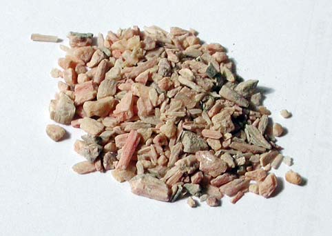

hello Tatyana
when you buy warangan its have to look like the warangan one the picteurs
you can buy many warangan but you can not use every warangan to clean your keris some even don`t work
regards semar

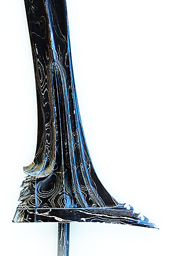

Over more than 30 years I have purchased and used traditional warangan in Solo.
It has never looked like any of the examples I've seen photos of here.
The warangan that has been available in Solo over the last couple of years has been very inconsistent in producing satisfactory results.
Since the early 1960's, and predating my use of Javanese warangan I have used laboratory grade arsenic tri-oxide. This has invariably produced very satisfactory and very consistent results.

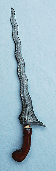

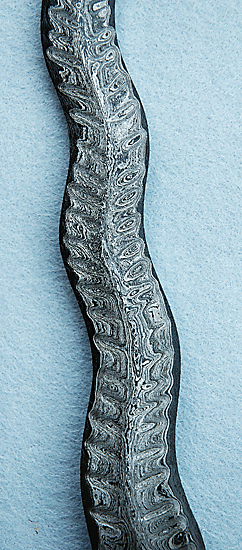

Here are examples of these results:-

this warangan that i show you
comes from a friend of my from surabaya
mij friend cleaning the keris for a living
and i think whem you cleaning the keris everyday
you know wich warangan works the best
regards semar

Old 10th August 2009, 03:17 PM   #15
Posts: 7,229
Semar, I have not purchased warangan in Surabaya.
Please re-read what I wrote so that you will understand clearly what I am saying.
I will repeat my message in the most simple terms possible in order that there can be no misunderstanding:-
1)--- the warangan that I have purchased in Solo, and have used, over a 30 year period does not look like the photos of warangan shown in this thread.
2)--- the warangan currently available in Solo is unreliable in producing satisfactory results.
3)--- since at least 1962 I have stained keris with laboratory quality arsenic trioxide; the results I am able to obtain with this are consistent, and in most cases I get a superior result to that which I am accustomed to seeing from professional blade stainers in Indonesia.
One thing I did not say in my previous post is that I pay to have approximately 100 blades stained during each 12 month period; I normally have to return half of these blades to the tukang because they are unsatisfactory; of the half I return I normally have to return about 15 or 20 blades a second time; of those blades I usually have five or so blades to stain myself. I use laboratory quality arsenic trioxide on these failed blades, and my staining is always successful.

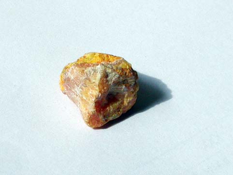

than you have Realgar, red to orange AsS, easly bought in mineral shops. The mor red the beter, is what people say.. i got a big chump here of maybe 300Gr red to orange colour.. it works. Just when you make the bath ready.. pulverise the realgar realy good, i use a farmacy mortar to grind. A big hammer does the job too . and piut the stuff in lime juice. I never put it on a filter.. let the fiber rot.. good for the acid value (PH). En my best tip.. let it stand for atleast a year... other wise it wont work properly... limjuce i white/yellowisch... i should become dark red to black sollution... you will know when you see it when its ready.
The pinkisch mineral, i have seen it. But never used it my self.. And dont know if its a mixture of compounds, or a seperate mineral, cant find anny info about it.

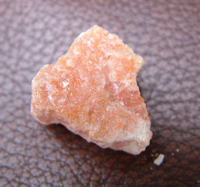

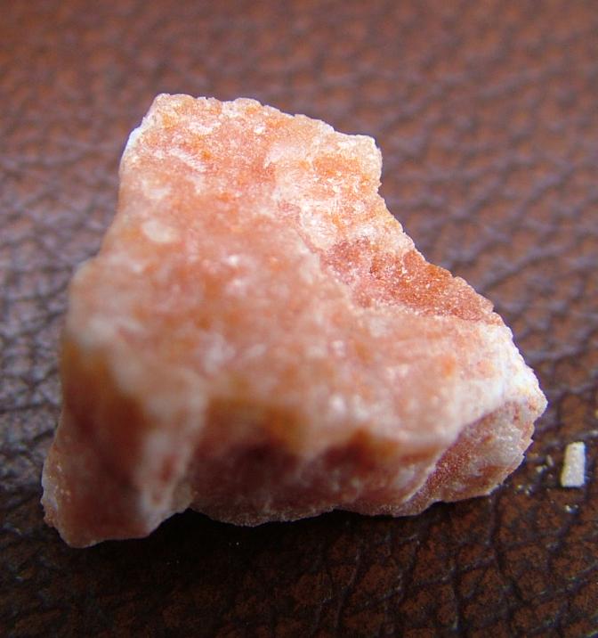

For those who what to use realgar i wish we could come to some agreement as to what color is best, because we are all over the map here. I have heard that purple is best, red is best, pink is best, orange is best and yellow is best. Well, only one can be best. If i were planning on using the mineral form i would be very confused right now.
Old 12th August 2009, 06:55 PM   #23
Royston
Join Date: Mar 2008
Location: Poole England
Posts: 445
Gents
For my sins I was once an aspiring Geologist. It was a long time ago but one thing about minerals sticks clearly in my mind. They differ in composition and colour a lot. If the relative amounts of arsenic to trace elements is important for the etch to work there is no saying that this will always be the same colour. Often other trace elements will alter the colour, sometimes a lot.
The result of this is that a good "etching " realgar may be red in one mine but may be yellow in another.
Roy
