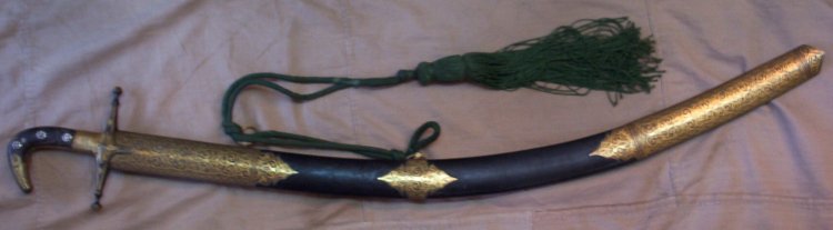

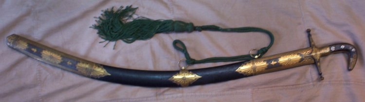

I could not help noticing new coftgari (typical and contemporary Syrian work in my opinion). The blade is claimed to be of Damascus steel, and no close-up was provided. Sorry for asking guys: why this sword received so much attention, thus high valuation, am I missing something?

I was troubled by the lack of blade close-up as well, but overall this struck me as an exceptional sword.
The winner is a sophisticated collector (and a member of this forum), who may comment further.

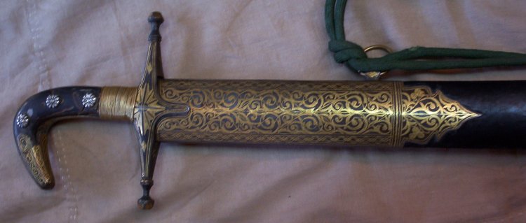

Although way beyond my pocket it does look jolly impressive. I personally cannot see any problem with the blade or its decoration. I like the scabbard and guard very much. I am bothered by the repair to the hilt. The brass/copper wire and clumsy lump of solder seem to show a recent restoration.

An interesting sword...ornate but not 'over the top'. Have to agree with Tim about the wire work...it looks 'out of place'.

My main argument was the fact that the gold coftgari and stamps look strickingly brand new. I've seen similar stamps being offered for $100 each in Damascus. The fittings obviously look old, and typical for the era. Perhaps there is something we did not see on the pictures, i.e. nice wootz pattern and/or old coftgari on the ridge of the blade.

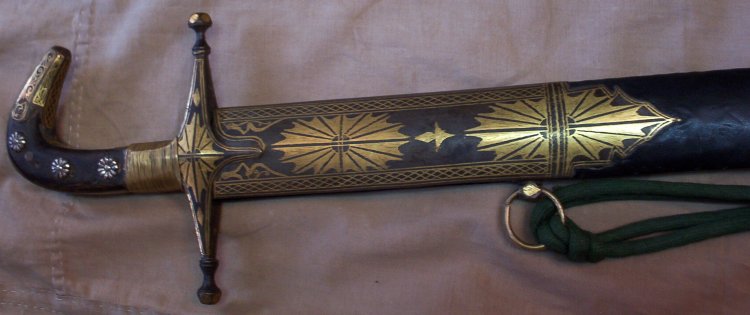

This sword was a bit of a gamble on my part, but was also a well reseached one. I had asked the seller for detailed pics of what she described as the "damascus blade", and apparently she thought that meant the koftgaried areas, and the pics were not so good, primarily because of the camera.
The one thing that did strike me though was the consistant uneven darkness of the blade, making me think it was, indeed, wootz. The koftkari was never really my #1 priority; the blade composition was.
The sword arrived today, and I was pleasantly surprised. It is very good Persian wootz. I have my suspicions about the koftgari as well, but it is not as perfect as one might think from the pics. I'd say it is at 90-95%. It does not have the clumsy thickness that new Indian koftgari often has, but I must admit I am not familiar with newly made Syrian work. Whatever the story with the koftgari, it was definitely not done "yesterday" as the whole blade is covered in a thin layer of sticky dried oil that clearly has been there for some time. This leads me to believe that Ariel may well be right...this blade may have been sitting in that scabbard for a very long time. The outside fittings are clearly original, and the silver koftgari there is a very impressive 85% or so, quite unusual on such fittings. The wear to the scabbard leather is puzzling, but almost all on the "saddle" side. The leather is dry rotting, but not too badly.
The outside repairs are quite clumsy and rapidly done. This leads me to believe that the repairs were hardly "restorations", but more like "fixes" by someone not familar with a better, more asthetic, technique.
All in all I was very pleased. The sword will take a little clean up, and light polish, but has a chance to be a real keeper.
Price-wise I was actually shocked that I got it. I am sure you are all aware of the sky-rocketing nature of shamshir prices by sellers and at auction houses. Had the seller made clearer, more detailed pics of the wootz blade, I dare say I would not have had a chance.
I look forward to sharing pics of the sword with my fellow forumites as soon as I have had a chance to clean it up a little and etch the blade.

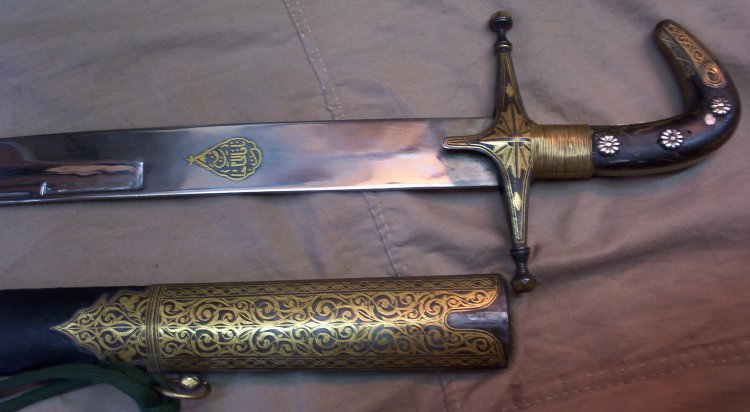

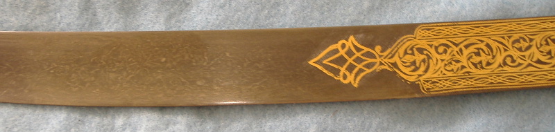

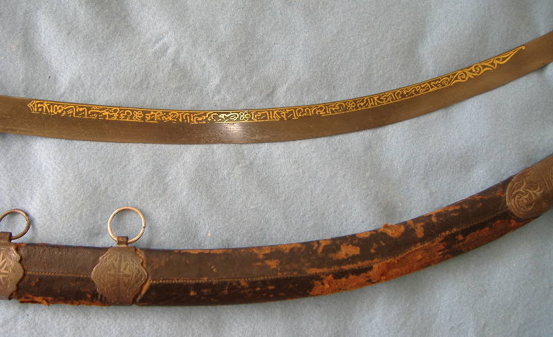

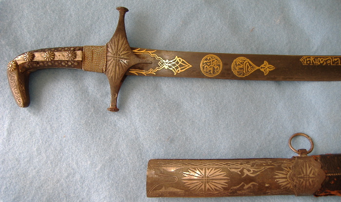

Here at last are some pics after a simple etching, not a full polish. The hard part was getting all the goo and hardened oil/grease off the blade.
The blade shows a nice pattern. The koftgari is in good, but not perfect condition.
The koftgari to the fittings is in remarkable condition, as this is easily lost on most of this type.
Now the question of course is the age of the koftgari. Alex has mentioned he believes it is not original to the sword. The slightly crudish cross hatching makes me suspicious. I am not sure, but even if it is not original to the sword, it surely was not applied "yesterday" based on all the gunk I had to get off the blade.
Alex, my guessing about the blade's wootz was based much more on the pics the seller sent me, than on the listing pics. Those pics were slightly better than the listing pics. The charcoal gray blade, with clear irregularities made me suspicious. Thankfully I was right.
Any help with koftgari translation would be appreciated.
Comments and opinions are welcomed.

Yes, I can see it now Ariel
Charles, looking at your close-ups, the sword looks much better than what seller showed. Nice pattern! I must agree - the coftgari does not look THAT new, especially on the blade's ridge, and the quality is definitely of a high grade. Again - congratulations to you! This sword is well worth (and well over) of what you paid for it.
The stamp closer to a hilt reads: "O Sham, God protects you". The word "Sham" in this case means Syria. The long inscription means the following: "Do your best to do good deeds in life. The deeds the man does in his life stay in history even after his death. The generations which will follow will read what he/you did in his/your life".

The cross-hatchings do not look unusually crude and long (based on new close-ups). The reason I originally thought they're new was because I saw very similar work in Damascus, i.e. large and clear stamps, and no visible loss to gold. Now, after looking closely at your pictures, it is NOT that obvious. Next week I'll show them to my coftgari-maker friend and he'll be able to determine the age. He's quite good at it. I'll let you know.

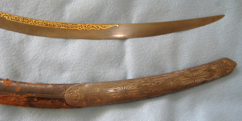

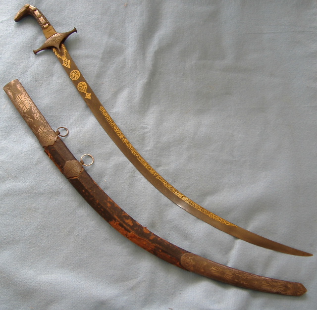

I finally have some info for you. The sword was made in Damascus and one of the local swordsmiths remembers it !!!! Moreover, he claimed it was made by his father probably in 1920s (I am talking about the fittings and coftgari of course. The blade is 18/19 cent). He showed me another of his father works, but with later Indian blade (I attach the pictures, and the coftgari and the stamp look quite similar). Now, when I told him the price you paid, he almost cried, and offered me way more. This quality of work is no longer produced in Damascus, and, if found, is very expensive. Anyway, I just wanted to share the info with you and to demonstrate that you're a clear winner with this wonderful sword. Congrats again.
