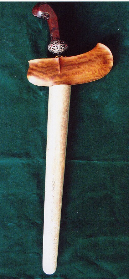

Here I put the photo of sarong
Old 17th April 2007, 04:08 AM   #18
Posts: 7,255
This pic demonstrates well what I was talking about.
The wood in that wrongko is superb.
The workmanship is probably as good as the wood. Difficult to judge in only one dimension, but from what I can see, this is top quality work.
The pendok is difficult to read because of reflection, but it appears to a Solo engraved bunton in silver. Even if the quality of work is the lowest quality available, you are still looking at very heavy money.
The selut is probably silver, the stones I cannot comment on, however, if they are intan and mirah, which is likely, because of the quality of the rest of the dress, then you have moved to a new dimension.
The handle could be tayuman, but if it is not, it is more than likely that it is good quality , old.
The dress on this blade is good, and being good, is expensive.
By any measure, this would not be a low priced keris.

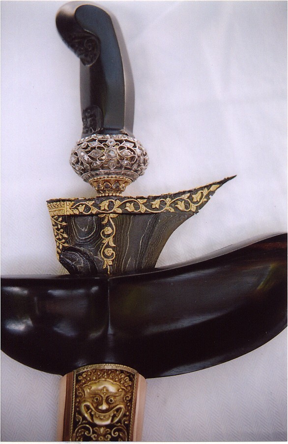

About price: the keris of this thread costed money seventeen time up of the keris that i put in the bottom. I could buy it about ten years ago because there was, in Indonesia, an unannounced very bad economic crack (about 1 $ = 18.000 rp instead of 1$ = 3.000 rp).

I like the second keris better Marco. The kinatah looks thicker and finer. (To my eyes that is) But i think its over stained. Is the mendak and central pendok panel gold? Congrats on a very nice keris!!

What you have in the second picture is diffently a better photograph which allows us to examine the quality of the kinatah much better than in the first picture. It is hard to say without viewing the entire keris, but i think i would probably prefer this second one over the first myself. Of course, this says nothing about the intrinsic value of either keris, just my personal likes and dislikes.
And yes, that pendok does look pretty cool!

I would probaly prefer the blade of the second keris, to the blade of the first keris, but the dress on the first keris is far and away superior to the dress on the second keris.
Yes, the pendok on keris #2 is skillfully done, but embossing is never the equal of engraving from the point of view of sheer quality.
Actual comparative values could only be determined after close examination of the two keris concerned, but I feel that the actual value of keris #1 could come out on top of keris #2.
I will add as a rider that what I am saying here is purely my opinion. I am not contradicting anything that has already been said, merely providing my opinion, based upon my experience.

Regarding the keris #1, well, the gold (if it really gold) certainly new and badly executed. But the blade isn't easily judged from the pictures. It could be old. A newly made keris of this quality from Madura should deserves better kinatah. If not, it only wasting the work of the pande/tukang potong. The dressing, especially the warangka, or more specifically, the wood grains, is good, if not superb. Fragrance sandalwood with Nganam kepang grains (or ndaging urang ?)
About the pendok, as Alan said, embossing is never equal of engraving in the sheer quality. Surakarta tends to prefer the engraving (or 'cukitan') while Jogjakarta prefer the embossing (tatah) technique.
On the pendok #2, Marcokeris has what it called 'tatah wudhulan' (Haryono in his book probably refers it as 'pendulan',(?)). We should have what it seems as a 'rough' surfaces, but should be very 'clear' and details. To achieve this, the craftmen use at least 3 embossing process, first from the face, then from the back and then from the face again. Thus, it is important to have a separate 'center plate' (slorok). Unfortunately, no craftmen today is able to produce the same quality as the old pendok shows. If it really made of suasa and gold, it would cost you somewhere near $1,000 (1$=Rp.10,000.), if you could find one.

The gold work of keris n. 1 was really beautiful (one of the best i never seen) but the quality of photo is bad and does not show the work.
Yes, the pendok of keris n. 2 is suasa with gold - plated silver (openwork)
The stone of selut are cheap martapura diamonds
