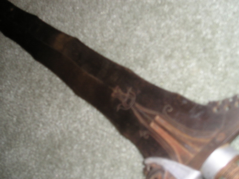

It appears that my original post lacked clarity. I apologise. Perhaps I should have been more specific and also included a picture of what I meant. However, to be fair, my understanding is that, in this forum, the word 'KRIS' (as used in my post heading) is reserved for what I refer to as 'Keris Sundang' (sword-type keris traditionally from Northern Borneo- Southern Philippines) and that 'scallop-edge' is a term commonly understood by 'sword people'. If I misunderstood, I again, apologise.
In any event, broadening the scope from 'kris' to 'keris' should elicit more response and hopefully, increase the benefit.
BTW... I have attached a photo I just took of a scallop edge. Please forgive the poor quality.

I believe the type of scalloping as seen in the picture started in the late 1930s. This also the time when lamination on these types dissappeared.

I think Battara is correct. These forms of kris are most commonly seen post-WWII, having their origin somewhat earlier. The "scalloped" edge results from stock removal, rather than forging a wavy blade. Many of these have rather poor quality, thin blades of doubtful functionality as weapons. It seems they were produced for sale as sourvenirs, especially to foreigners, rather than as weapons within the indigenous culture.
Many of these kris and punal/gunong appear to have been made in the Lake Lanao region of Mindanao (mainly by the Maranao people), which is still a prominent site of manufacture of swords and knives today.
