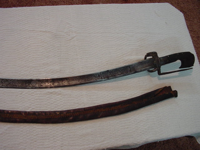

Hi,
I just got these pics from a friend who would like to sell this sword. I thought I would show you the pics, just for sharing though. I would also like to know what you think. I think that the blade is european, locally etched. The marks on the blade are the most interesting thing about it. There are some amharic words on it, which would mean an ethiopian provenance, but we never knew that these swords were found in ethiopia (I think)?! There is also a star of david sign on the forte, which would mean that this sword belonged to a jew, which would be reasonable as there were many jews in ethiopia and Yemen. This could also be an Ethiopian blade remounted in Yemeni fittings.

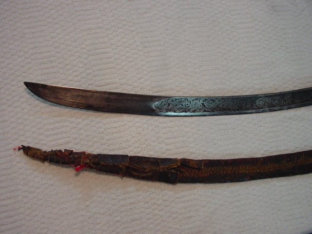

A couple more:

The blade seems to be from an Ethiopian saber it may not be original to the hilt? The scabbard seems to be Ethiopian made also?

I was under the impression that most of the saif with the ring on the hilt like this came from near Dar es Salaam or Zanzibar. So if this is from Ethiopia it would be an interesting find. I want to say I have seen similar markings on a gurade ( and Gurade is the amharic word for sword ) I will look and see if I can find it again.
Maybe Mark or Jim will chime in on this, in another place Mark stated this about ethiopian blades
There has been extensive trading for centuries across the Red Sea between Ethiopia & Eritrea (and the various small kingdoms that preceeded them), and the Arabian peninsula. The highland tribes of Ethiopia (such as the dominant Amhara, the Tigrinia and the Gurage) and coastal tribes such as the Danakil, the Afar and the Issa, are in fact Semitic peoples, indicating close ties with Arabia. It is not unlikely that a blade could make its way to the southern peninsula, perhaps via the port of Djibouti which is directly opposite, there to be re-fitted.
Isnt amharic also spoken in Eritrea ?
And I have been told there are Jambiya with Jewish blades so it would not be out of the realm of posibilities for there to be a Jewish blade in a saif

Thanks for the replies, Louie, David, Rhys, and Tim. I must confess, I never really knew what the hexagram really stood for in any of the three faiths, Judaism, Christianity, and Islam, which they all used throughout history. I must also admit, that I know very little about Ethiopian ethnicity, culture, and symbols, which are one of the most interesting in the world. Thanks for the link and pointing that out David, very interesting to see a hexagram with a cross in the middle of it.
This blade is most probably European, made for the Ethiopian army, but found itself in Zanzibar or Yemen. I have seen many hexagrams on european sabre blades, especially wilkinson's, but never really understood what they stood for
As to Yemeni jews, they probably only worked in silver, their work being referred to as "ibri" by arabs, which means hebrew, and regarded as the best.

The six pointed star found on BRITISH blades has nothing to do with Judahism and Solomonic Dinasty. Has it been copied from the Star of David? Is it a coincidence? That I don't know. I do know, though, that it is quite simply the simbol used in Great Britain as a quality trade mark by the best blade makers. It indicated that the blade is of British origin. That's all. I'll try to get the inscription transated. Yes, Amharic is also spoken in Eritrea, just as Tigrinian is spoken in parts of Ethiopia. Both languages share the same alphabeth.

Now I am REALLY intrigued.... There are two sets of writing, as shown in the pictures. The clearer one does not make any sense to me (yet?), but the one that shows out of focus is easily readable and it says: GEORGE 5th, SWORD MAKER, PALL MALL, LONDON. Which is, OF COURSE, part of the inscription that Wilkinson wrote on his blades. The full inscription should read: Henry Wilkinson, sword maker for King George 5th, Pall Mall, London. So, is there more writing that doesn't show in the pictures? At any rate, considering all this and the general apperance of the sword, and the fact that the floral etching seems to be a poor imitation of the Wilkinson pattern, I'll venture to say that someone tried to emulate the appearance of a Wilkinson blade, down to the six pointed star. This makes, again in my opinion, a FANTASTIC find, if not for the intrinsic value of the sword, which may be not that great, for the historical value attached to it.
