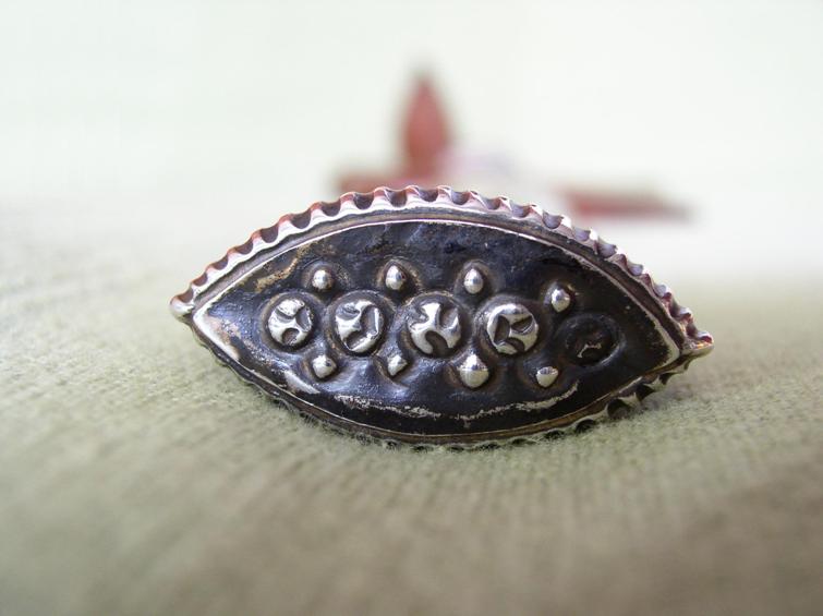

Hello Rasdan,
Thanks for the information. Then it must be providence that Adni acquired another keris Melayu from a different source, with a different sampir form, but with an extremely similar silver pendok made by a different silversmith. We were joking that the 2 kerises were brothers and had an agreement to arrive in Adni's shop at the same time, from different places.
Hi Alan,
I didn't test the pendok for silver, but when it was acquired, it had a yellow-brown patina on it. I used a silver cloth to polish the pendok back to it's current shiny state.
Old 30th January 2007, 09:09 PM   #7
Posts: 7,255
G'day Kai Wee,
reason I asked is that I have seen several very similar pendoks, and pendoks with a similar standard of embossing that look very, very much like silver, but test as mamas, or some similar alloy.
I actually bought 3 or 4 Sumatra keris a few years ago with this sort of pendok. I was sure it was silver, and paid for them accordingly. When I tested, I found they were not silver.
In my experience, the patina on dirty silver tends to blackish, rather than yellow-brown. If I see a yellow-brown patina I immediately think "mamas".
Still this pendok might be silver, but I would definitely be inclined to test it. I test everything I ever get that looks like silver. The last bottle of silver test I bought cost me $12, and has lasted for years.

Hello Alan,
Thanks for the advice. I'll go look for a bottle of silver test!
Come to think of it, there were some black coating on parts of the pendok that were a bit difficult to clean off, but best to test it for sure.
Btw, I've never heard of the term mamas. What is it?

Thanks for the info. I think I know what mamas is. I have had a few pieces with metal parts which looked like silver, but looks harder and not so malleable.
I found a part on the pendok which I did not polish; just a few wipes with the silver polishing cloth. It looks black enough.
Old 1st February 2007, 01:06 AM   #12
Posts: 7,255
Yep, it does. Almost a bit too black. I've had stuff in my hand that I would have sworn was silver. Only way to know for sure is to test.
