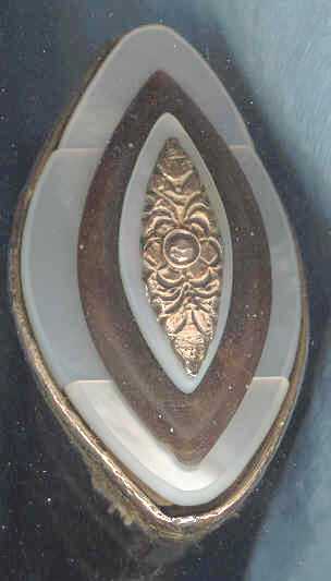

Regarding the nails, I have seen them used on older pieces, and what we would consider "crudly" made ones at that. Glue for something on top would not last long. Most plates I have seen use nails. Not uncommon from what I have handled and seen so far. An observation is that from the ones I have personally dealt with, the majority seem to be Maguindanao kris that use nails or wire connectors overall.
The picture I have is the earliest one I have that uses 10k gold over copper nails to keep the gold/turtleshell/mother-of-pearl in place. This kris goes back to around 1900. Only one of the nails shows in the middle (the rest are underneath the middle gold part).
