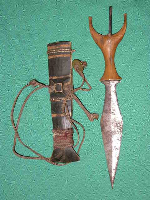

Last week, I was able to buy an entire collection of African weapons. Among these pieces was this dagger.
In my (humble) opinion, it is from the Luba-tribe. I found a dagger with a similar blade in one of my books.
I hope you can see on the pics, this knife has a well forged blade. The wooden handle has been embellished with some copper strips. At the top of the handle, an iron ring has been added.
Total length : 36 cm. Length of blade : 25,5 cm
As I'm not at all sure of the origin, I would appreciate any 'input' from the other forum members.

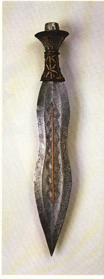

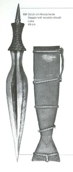

Hi Freddy, on Westerdijk's book there are two drawns of similar daggers-short swords in the XIII Groep (2-3) lulua-songye-luba. Something that could be similar with your piece is the sword on Fischer-Zirngibl, but is attributed to the Tchokwe ( ). On Waffen aus Zentral Afrika there is the most similar and is attributed to the luba. So it's clearly of the southern area of Congo
