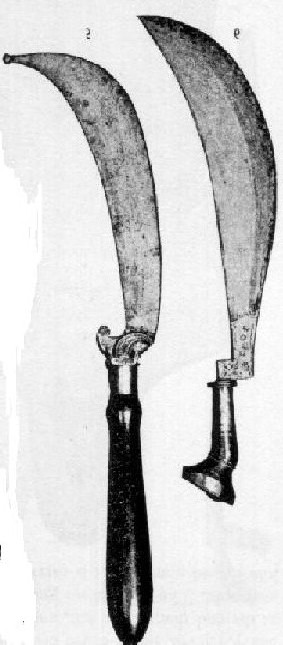

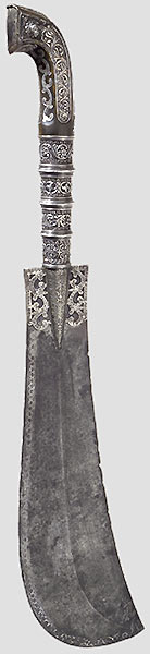

Wouldn't you know it, Artzi's just put one up for sale:
http://www.oriental-arms.com/item.php?id=2384
Also, compare it with this example:
Joe is offline   Reply With Quote

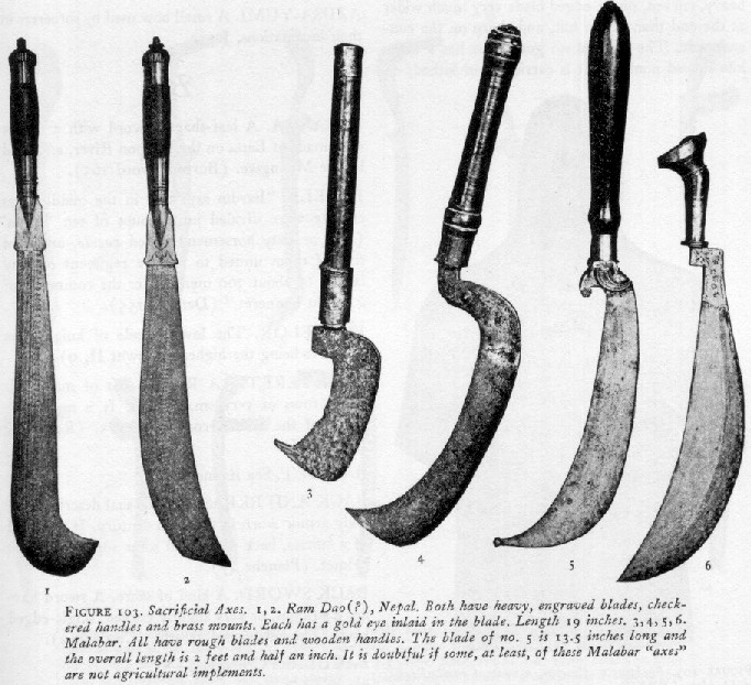

link http://www.vikingsword.com/vb/showth...hlight=Malabar
Old 20th December 2006, 05:21 AM   #9
Joe
Joe's Avatar
Join Date: Sep 2006
Location: McDonough, GA
Posts: 48
Very unusual for a weapon to have this many variants........
There's ones with forward curves, with backward swept blades, ones with sickle-like ricassos, and some with plain handles that look suspiciously Moro....
The floor is open.
Old 20th December 2006, 08:50 PM   #10
Posts: 7,407
Well, Joe, there really is nothing Moro about this, though you have a good point about so many variants.

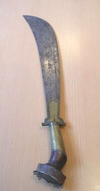

Arrived today. An absolute POS! (Piece Of S***)
Asking for a refund. Totally tourist junk!

Thanks, guys, please see this thread for better pics.
http://www.vikingsword.com/vb/showth...3825#post39159
Maybe I am just feeling a bit moody today. Had some business problems. One of my rental houses burned. No injuries. Don't mean to take it out on this seller if the piece is worth having.
