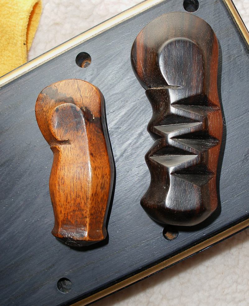

Maybe you choke up on the handle?
See pics:
Included is a pair of Bondolan type hilts; one new and one old; the smaller handle is 3.5 inches long and usable.
How many of the old (19thC. and older) handles are large; I don't know.
Looks like a visit to Tammens is in order.

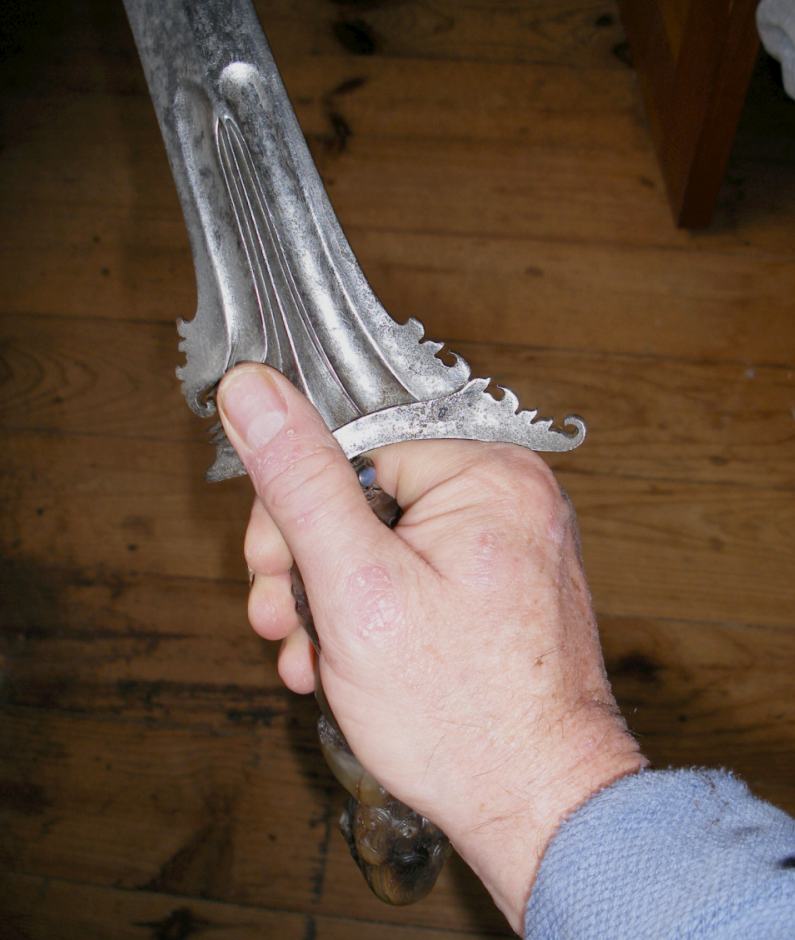

I have a few Balinese keris and it appears that the saber grip is the only comfortable way to grasp these keris.
