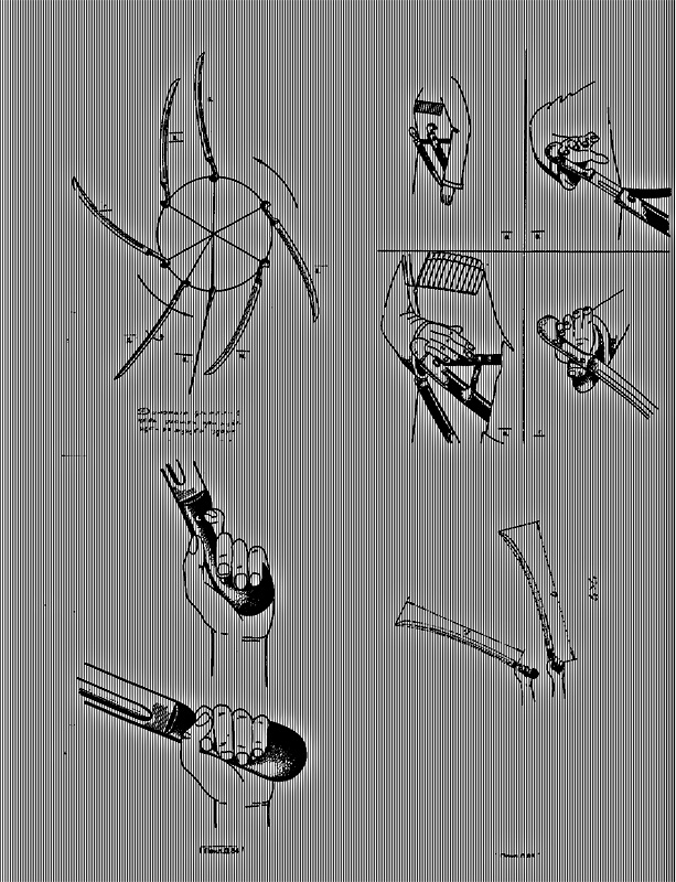

Well, If one wishes, one can raise many counterpoints to this study, starting with the fact that he did not train with shamshir and therefore might have misundertood the nature of shamshir fencing. However since there is not a single person alive who "really" knows how to use shamshir (i.e. studied under Shah Abbas or something), I guess this comment can be applied to any study of shamshirs.
Attached are a few drawings (c) by Nakov - unsheathing shashka, circular cut, correct way to hold the grip.

BTW, where did you get the shashka drawings? What is the difference between the two styles of gripping the handle( fist vs. pistol-like)? Which one is correct? I would guess the upper one is good for true swordplay, whereas the lower one mainly for swinging cuts.
