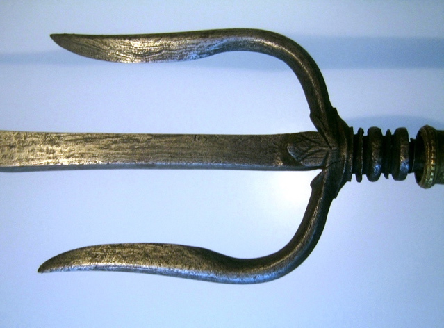

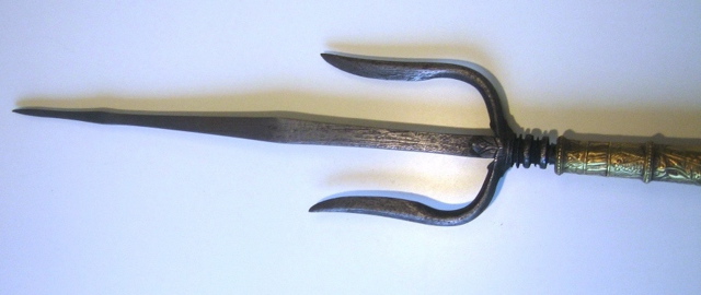

Default Trisula of unknown origin

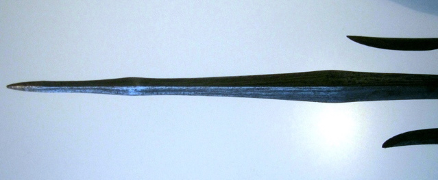

It's not a Keris but I think it's Keris related so that's why I choose to post it here instead of the other part of the forum.
I have tried really hard to find the origin of this Trisula spear.
I have discussed it with several people experienced in Tombak but so far I have only got indications, but no definitive opinion, of its origin.
Hopefully someone here recognise something on the parts of this spear to give me a clue on where to search further?
Maybe some of the motifs or other small details that you have seen on other weapons from a specific area?
For earlier opinions and more pictures:
http://www.kampungnet.com.sg/modules...view_album.php

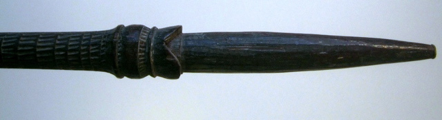

Hi Michael what a very nice trisula this one is from java 17 centh

Hi Ben,
What elements of this trisula suggest Jawa 17thC to you ?
Old 25th November 2006, 09:25 PM   #4
Posts: 7,217
This is an interesting opinion Dajak.
Will you please tell me what the specific characteristics of this tombak are that allow you to be definite on a 17th century Javanese attribution?
I would most especially be interested in your interpretation and specific classification in terms of tangguh of the metuk.

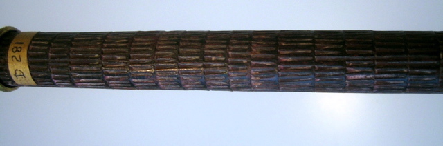

The wood is old style java with the little carving in it and trisula point is 100% from java late 1600 early 1700

Old 25th November 2006, 10:55 PM   #6
Posts: 7,217

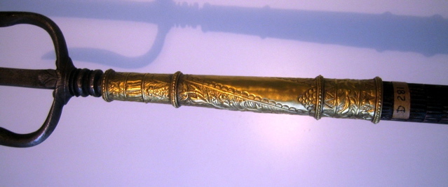

Thank you for your response Ben.
I'm not so interested in the landean , or sopal, although I must admit, to me these look Sumatran, but that is only a gut feeling I cannot substantiate. The fact that there is no tunjung I find an anomaly.
What does interest me in the extreme is firstly the metuk. I have never encountered an attribution to Jawa for a metuk such as this. It is similar to a metuk that was on a tombak in the Sydney Museum of Applied Arts and Sciences. This tombak was attributed to "Malay", and that museum was replaced by another many years ago. I place no reliance at all on the "Malay" attribution of this Museum.
Secondly the material is out of stain, and displays very little weathering or erosion.In fact, file marks can still be seen on the surface of this tombak The grain of the metal I find difficult to relate to any Javanese classification, and the fact that it is out of stain makes the reading of the material, most especially from a photograph, extraordinarily difficult.
Looking at the individual sections of each component part of the three blades we have a square or rectangular cross section in the base of the central blade, we have a diamond cross section in the front part of the central blade, we have the side blades formed from round bars with the forging out to an edge only on the inside edge, not the external edge; the overall proportion is elongated and rather narrow, not at all pleasing to the eye if looked at with a Javanese standard of evaluation. There is some unusual file work and ornamentation in the base of the central blade and at the point where the side blades spread. I cannot relate this to any Javanese trisula I have seen.
Comparison of the overall form of the blade with a Surakarta Pakem book has revealed nothing even remotely similar.
Comparison of the overall form of the blade with tombak and trisula of known Javanese origin has revealed that similar characteristics to the ones that exist in this trisula cannot be identified.
Because I cannot positively identify this trisula I am not prepared to say that it is definitely not Javanese, but I am prepared to say that in more than 50 years of collecting I have never seen a trisula similar to this that has been given a positive Javanese attribution. Nor have I ever seen or handled a tombak or trisula with similar characteristics to this this one, that could be given a positive Javanese classification.Added to this I can find no reference in print that would allow even the hint of a possible Javanese attribution.
If anybody were to state positively that this is Javanese, such a statement should be backed by justification in terms of classification of material, metuk, and overall form. Other than this, eye witness verification of the actual manufacture would remove all argument.
I just reread what I've written above. The "eye witness" thing sounds as if I am being sarcastic. It is not intended that way. What I had in mind was that it is entirely possible that manufacture of this trisula could have been witnessed. If, say, it was commissioned by some Dutch colonial, in Holland it could have a family history that grand uncle so and so ordered it when he was stationed in Semarang.Some documented history such as this would put the lid on any debates based on tangguh.

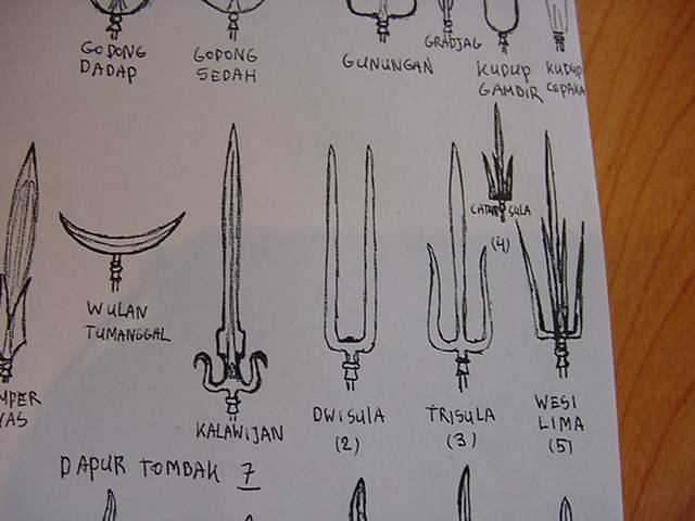

On the shape of the Trisula spearhead I found this old reference picture on the Internet.
To me it seems as if the upper Trisula has some resemblance to mine of the spear head design and proportions?
It doesn't have any further description than it's Java.
But the Keris on the same picture is of course from Madura?
Old 26th November 2006, 08:27 PM   #8
Posts: 7,217
I'm afraid I cannot see a real lot from that picture, Michael.
Yes, either of the top two tombaks could be considered to have a degree of similarity to yours, in one way or another, but personally I would not be prepared to make any comment as to relevance , based upon that picture.
What I have been taught, and what I have observed, is that the two overwhelming indicators for classification of a tombak are material, and the metuk.
In the case of your trisula, the material is almost impossible to read, and the metuk is so far divorced from any type I am familiar with that I simply cannot even offer a wild guess.Looking at what I can see in that trisula, I would not be prepared to say more than "South East Asia".
Regarding the tunjung.
I have yet to see a Javanese tombak landean that does not have a tunjung. Even simple village quality ones have some sort of tunjung. What I can see on your landean is an area of ornamental carving where there should be a tunjung. The tip of this length of carving is scuffed, which would seem to indicate that there has been no tunjung there for a very long time, and possibly there never was one.In fact, since the end section of the landean swells between its tip, and the area of bulbous and foliate carving, it would be difficult if not impossible to fit a tunjung, so I think we must assume that there never was one.If there never was a tunjung, one must ask why. Is there some area of SE Asia where tunjungs are not fitted? I don't know the answer to this question, but I do know that I would expect to see a tunjung on any Javanese landean.
The material of a tunjung in an ornamental landean will normally match the sopal, but in an old weapon quality landean, it will most often be iron, and the sopal will be replaced by iron bands and cord binding.

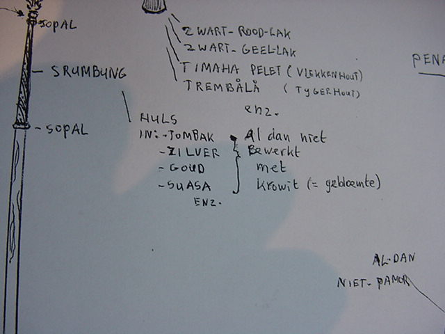

Hi The chairman did make a study about this subject and publish this on 8 nov
2005
the metuk has seen in java in silver gold suasa with or without krowit (flower)not al tunjung are in iron
Batang landeyan can be found in palmhout rozen hout enz
He says defenitly this is Java (I don t like to insult any one but the most knowledge about the keris and Indonesian weapons from the past can be found in the Netherlands In some private collections and museums we have more than than can be found in Indonesia the knowledge about these things
that we took from the early time that we been there was al written down
by the Dutch Germans English the Indonesian people by that time 1600 had not much interest in how the keris was made or develop that has also to do with the fear they had for it only a few High stand Indonesian people did have some knowledge the rich ones . who looses a lot off their stuf by gambling or mismanegemant so we get a lot in the Dutch hands .
In the early years In the Stone you can read the Dutch pandhouses have an formula to see if it is an bad or good keris.
The most study about pamor can be found by the european books.
An famous Tammens did make a big study about the kris .
He did have some krisses that are famous and one that had bring unluck to a few people not an story but al proven I see this keris and did not want to touch it becuase they cal this one the car damage keris
the story about this can be read In the book from H.W.M.J. Rijnders geloven in bijgeloof an very nice book that goes about goena goena black and withe magic demons etc.)
In the Stone page 629 is the same it says java I think we have to look what was in the past and not look how we call the parts now to avoid mistakes these weapons are from the past not from 25 years ago
Ben
