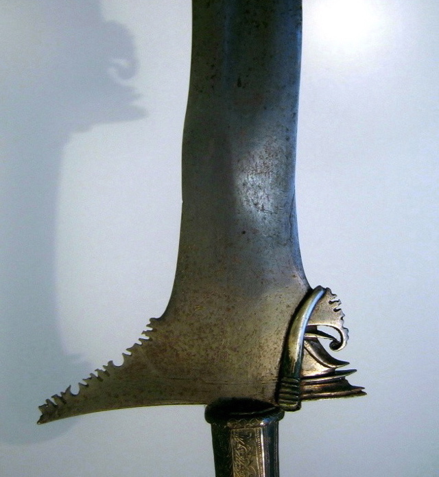

Posts: 4,706
Michael:
That Kalis Sulu is beautiful. The ivory kakatua is considerably smaller than most. Do you have any idea where this one originated? I'm wondering if it came from Brunei or Malaysia because it is somewhat atypical for a traditional Moro kris.

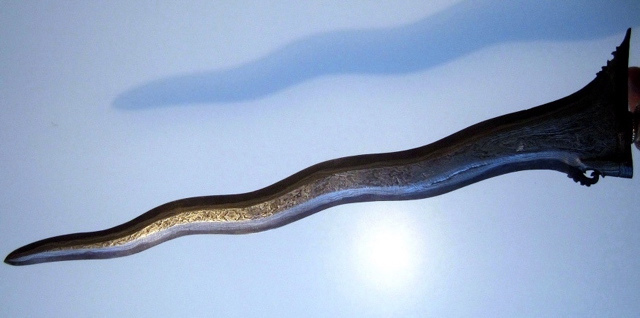

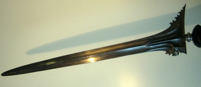

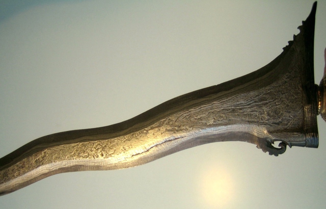

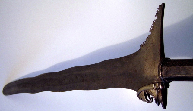

Here are some additional blade pictures. They are in the same order as above. In case you want to watch them "the proper way" please go to Kampungnet or turn them in your viewer.
PS Something strange happened when uploading?
The order is now Sajen, Bugis, Terengganu, Bali and Sulu(?).
Last edited by VVV; 31st October 2006 at 04:17 PM. Reason: Something went wrong with the upload

I suspect that it maybe could come from NW Borneo based on the motifs on the silver band. But that's just a guess and I still think it's Sulu.
Please convince me if that's not the case?
Hi Michael:
The reason that I think it is odd for Sulu (that is, Moro) is the hilt: a smaller than average kakatua and the continuous silver wrap to the hilt which has an octagonal "tubular" apeparance. The usual form of Moro silver hilt dress would be circular or oval bands of silver that overlap. Also, there is a small "lip" to the silver handle sheath just above the gangya -- not commonlty seen on Moro weapons.
That said, there was a lot of interaction between the Sulu and Brunei Sultanates, so some diffusion of styles each way probably occurred. Indeed "Sulu" has sometimes been used to include Brunei, so we may be splitting hairs.
None of which alters the fact that it is a lovely kris.
Ian.

Thanks Michael.
What I meant to say is that an octagonal hilt, per se, is not rare on Moro kris, but a continuous silver "sleeve" as shown in your first example above is something that I have not seen before. Perhaps I have just not seen enough high end beauties like these.
Your second example looks more traditional and appears to be a Mindanao kris, most likely Maranao -- the "elephant trunk" area is of the Maranao form (according to Cato). The octagonal handle is wrapped with silver wire to conform to the underlying shape of the handle, although the small band holding the baca baca is circular. The ivory kakatua is small but of traditional shape -- probably late 19th or early 20th C. but could be earlier. The scabbard fits with a Mindanao kris of around that period also. So this one looks a typical Moro kris all round, perhaps redressed around 1900 +/-. The blade looks considerably older than the hilt and scabbard.
The one at the top of the post still has me baffled as to where it originated.
Ian.
