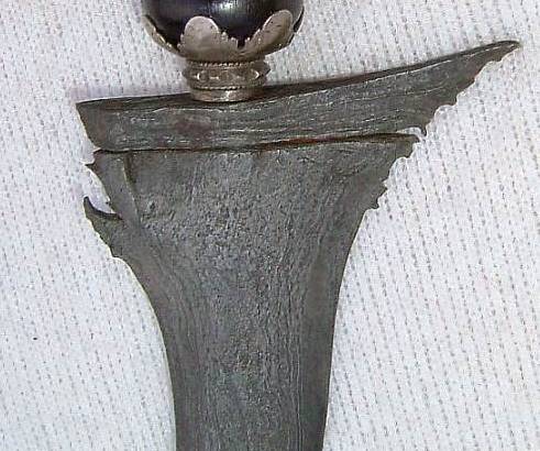

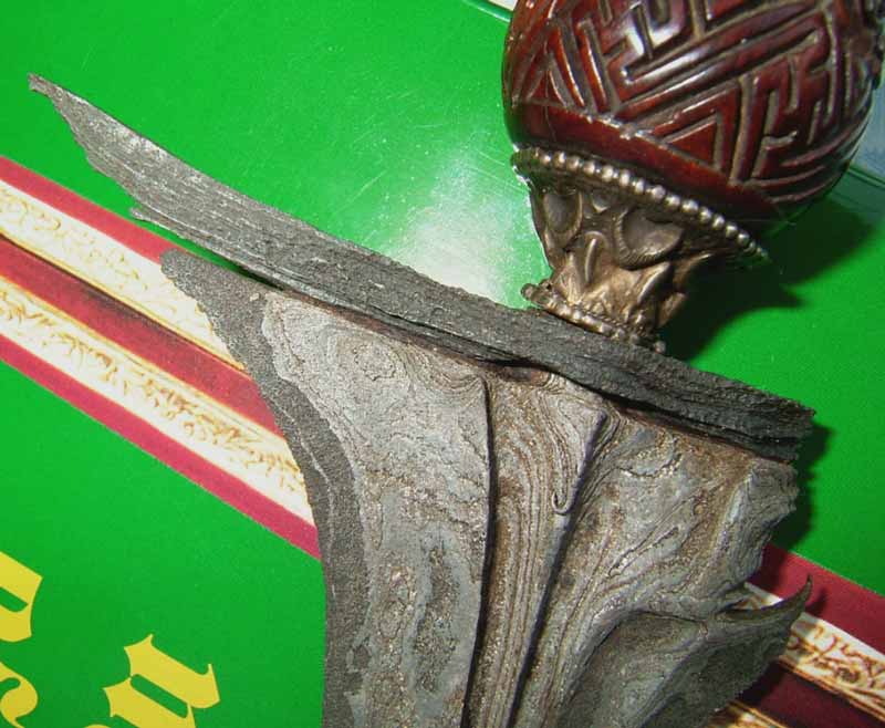

Often I see a feature on some keris which has puzzled me for some time now .
Why are certain gonjos lifted away from the wilah at the tail or greneng end ?
This feature must have some meaning or be of a certain style ; can anyone help with the how and why of this ?

Hi Henk ,
That's something to consider ; but also when you look at the ricikan (correct term?) of both kerises they are similar even though one is Javanese or Maduran and the other seems Sumatran (cross pollination?).
About the lack of pamor on the Jawa piece; it is a very old blade and if I recall correctly from a past discussion of this one possibly from the Sultan Agung period; also again if I recall correctly there was some mention of a prohibition during that time of pamored gonjos or of openly displaying the pamor of one's keris .
Could this be a feature of dapur; or does dapur not cover the area of the gonjo ?

There are perhaps as many answers to this question as there are keris which display this feature.
In the two keris that Rick has shown, I would suggest that perhaps we are looking at two different cases with different causes.
In the first there is absolutely no doubt whatsoever in my mind that we are looking at the effects of time.
Plain, simple erosion.
In the second, what I can see is a pretty substantial gonjo that does not display an unusual amount of erosion, moreover it is a fairly recent keris.
Possibly this gonjo was not very carefully fitted in the first place.
It does take a lot of time and effort to achieve a tight, neat fit of gonjo to blade, and if a keris being made to a price, the maker is not going to waste time on something that will not recompense him at an adequate rate for time spent.
This gonjo has probably been fitted by the gonjo around the pesi being punched . I feel that a key in keyway fitting would not have been used, and even if it were, I believe there would be evidence of the gonjo hole being tightened by punching. When the gonjo was punched down, any imperfect fitting would show up by the gonjo lifting away from the blade. Another possibility would be that the tip of the gonjo has been subjected to force.
If this second keris belonged to me, and this opening bothered me, I would apply gentle heat to the gonjo with a propane torch, and tap it down to fit.
Yes, heat could cause a gonjo to distort, but how and when would this heat be applied?
When a blade is heat treated, the gonjo is not subjected to any heat at all.Gonjos are not welded into place, they are mechanically fixed.
Long term deflection, caused by the weight of the blade being suspended by the gonjo?
Perhaps some of our engineers could supply the figures that would tell us what sort of deflection we could expect and over what time period, taking into account such factors as the time that the blade was actually freely suspended, temperature variation, relief of stress when the blade was not suspended , or was withdrawn from the scabbard.
I am not saying that long term deflection could not occur, but I rather suspect that requirements for any noticeable amount of deflection to occur might be so extreme as to completely remove this cause from consideration.

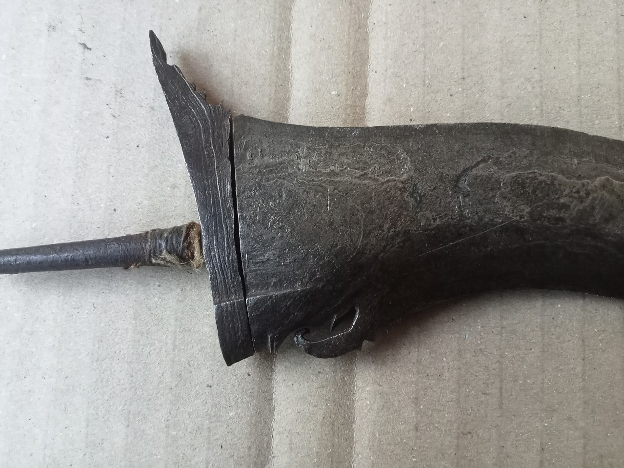

Thank you for this very informative post, answers a question and points me towards a solution to a problem I have.
David R is online now   Reply With Quote
Old 15th December 2023, 08:06 PM   #14
Posts: 7,218
What is the problem David?
I cannot see any real problem in the photo.
Yes, there is a gap between the blade body & the gonjo, this is not at all unusual in older keris, and even in recent keris which have not been carefully made.
By dismounting the gonjo & refitting it this gap can very probably be reduced, but this is not a job that should be undertaken by somebody who does not possess the necessary skills.
In Indonesia, the modern approach is simply to fill the gap with two part epoxy + black artists powder + iron filings. This is not an approach that I approve of or recommend.

The gonjo has actually become loose, separated even. I will not rush into dealing with it, but concentrate on getting the blade dressed for now.

David, the gonjo needs to be fixed in place before you try to get dress for the keris.
You're not looking at a big job just to fix it into place, ten, fifteen minutes tops.
To demount and refit in order to eliminate the gap, you are looking at serious time & committment.
But that gonjo must be tightened up before you think about dress, finding suitable dress could take quite a while, depending on where you are.
