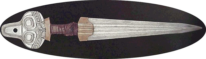

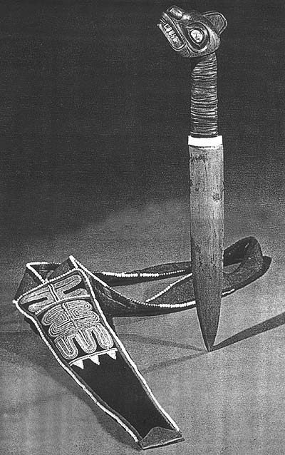

Perhaps this is more of what you are looking for. It is one of two daggers made of meteoric ore and is said to go back 10 generations. I believe it is currently in the hands of Harold Jacobs, a Tlingit cultural specialist whose family had been the caretakers of this piece for some time. It was recently returned to his tribe by a museum.The dagger, called Keet Gwalaa (Killer whale dagger) is 27" in length. The copper binding the hilt is on very tight. It appears to be made in two pieces joined at the hilt.

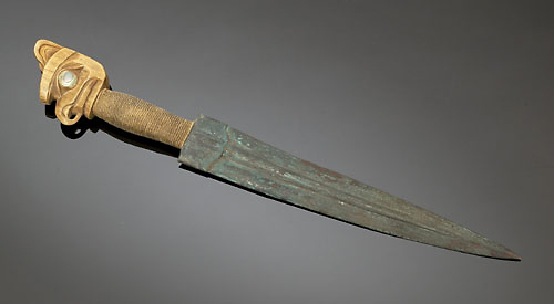

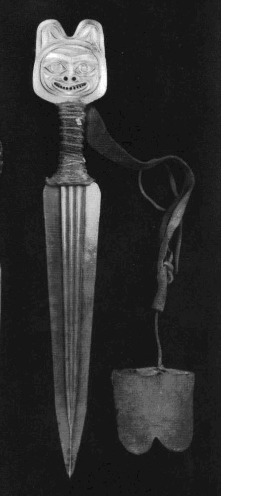

Here is another Tlingit dagger, this one made of copper. I am afraid i know less about the origins or dating of this one. It seems to many that you can find many Tlingit blades that are trade blades, but i believe the two examples i have posted were actually forged by the Tlingit.

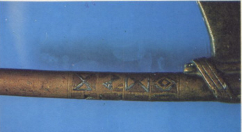

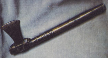

This interesting axe is in the Museum Of America, Madrid well worth a visit. Bronze from Peru, with what looks like silver, tin or lead inlay. Bronze implies considerable metallurgy rather than working in copper as bronze is an alloy. So smelting was not an unknown activity. I like the way it mimics a stone axe, I would imagine this was an exceedingly special object, as it is today.

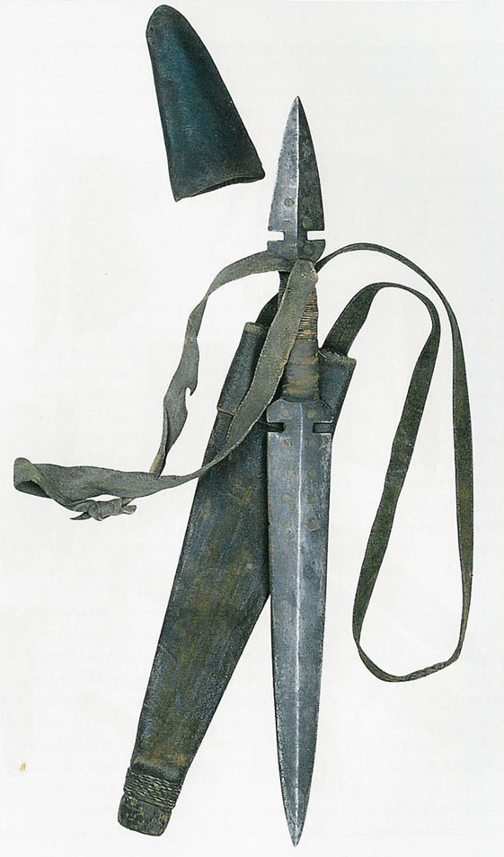

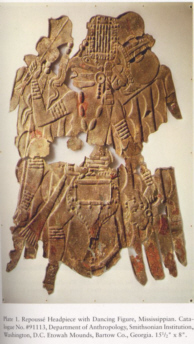

This is also from the Americas museum in Madrid. I think this is most interesting as it has the same method of attachment to a halft as the axe I post earlier from Wisconsin except this one is bronze. It is 11cm long and reminds me of axes from South Africa. If one is to work on that well trodden path of like forms means it came from somewhere else. Then Zulu sailors went the long way round, or round the cape of good hope and then cape horn and settled in the Andes . I prefer to think that some objects are universal and the design comes to a mature form that does not alter where ever one comes from.

The last one, double blade, is simply beautiful!!!!

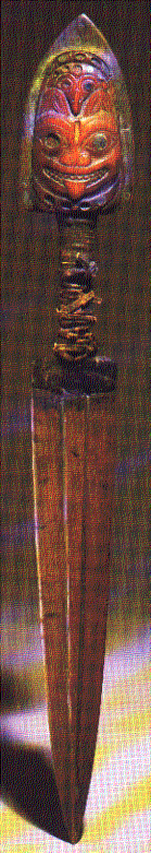

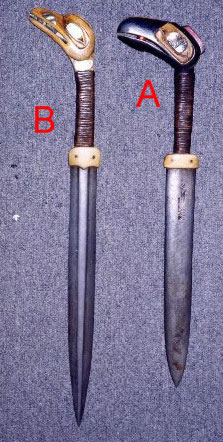

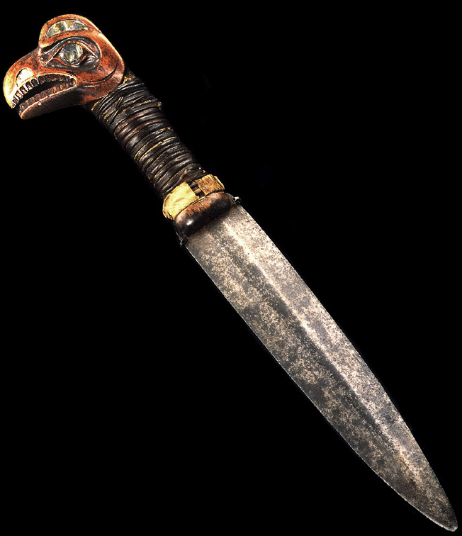

Here's another dagger from Angoon. This was isn't as old as the Killer Whale Dagger. This one is called Xoots Gwalaa (Brown Bear Dagger). It has abalone inlay in the eyes. It was returned to the Bear Clan by a museum in 1999.
Yanyeidi is offline   Reply With Quote
Say, do you suppose if someone had their geneaology mapped out well enough to trace their ancestry back to medeival times, they could start knocking on the doors of some of the European museums with big arms collections and demanding the return of their cultural heritage? "Yeah, I want that billhook, targe, claymore and dirk, they were all looted from my people after Culloden...."
FenrisWolf is offline   Reply With Quote

One might have to be a little more sensitive to these matters when it involves art works from communities that live in the same country/nation rather than trophies from foreign wars. I am not from the give back camp in latter case.
Tim, daggers like the Brown Bear dagger Yanyeidi shows and the Killer Whale dagger i posted early may very well have been considered "trophies of war" by the Europeans who originally collected them, however these daggers were never meant nor used as weapons of war. They are ritual daggers with deep spiritual significance to their people which i can only image were looted since these daggers would never have been sold or traded to the European invaders. It would indeed be interesting to find out just how they ended up in these museums to begin with. I would not be as quick to advocate giving back battlefield pick-ups to their nation of origin. These daggers fall into a completely different catagory, don't you think? I comment the museums for having the frame of mind to do the right thing in these cases.
