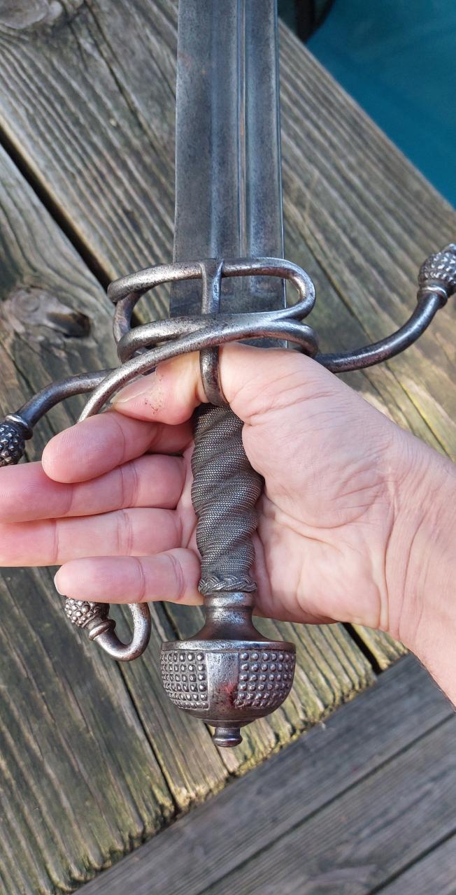

The auction site listed this as "contemporary" and referenced "artificial aging". However, my assessment is that is is a true 16th (or early 17th) century Dusack, despite the less than expected hammer price.
I still need to take my standard measurements, and the pictures below are the seller's, but it was listed with the following dimensions: 8.5" Width (Quillions) x 4.25" D x 35.0" Length.
I think it is nearly all original. The grip wire looks a bit too perfect to be original, but if replaced, they did a wonderful job.
Michael D. Long has a very similar piece on their site (it is sold, so I hope it is OK to link to it). My piece has more a decorative pommel and finials. However, the blade is identical (albeit with different maker marks).
I would love to get your impressions of this piece. If it is indeed a reproduction (as the auction company stated), the amount of hours that went into making it are staggering because i don't see any evidence of modern techniques.
It is heavy (again, I'll post stats like weight, dimensions, point-of-balance soon), but it is well balanced in the hand.

It's modern. 19th century or younger. No need to be an expert to see this. Just compare it with originals. Plenty of subtle differences.
Still a nice piece.

The example of Michael D. Long is also not good. The whole hilt looks replaced, instead of only the wiring.
Modern looking on the example of OP:
The ricasso
The bars in the hilt.
The pommel
Dot decoration
The blade and false edge also look off, but I need better pictures.
Compare the Hilt with pictures from users. Similar design, but original.

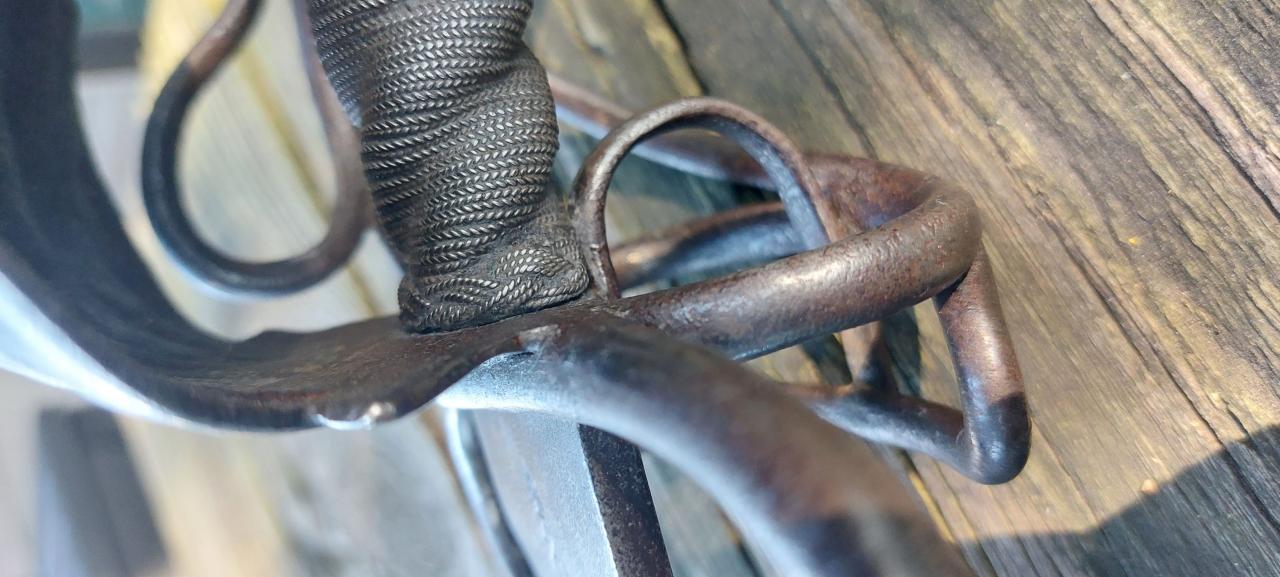

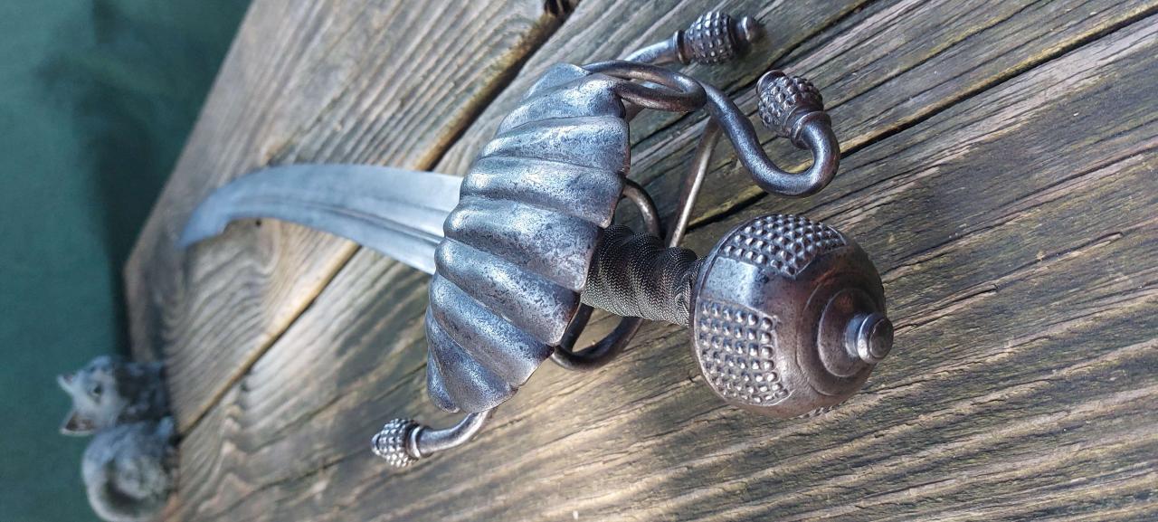

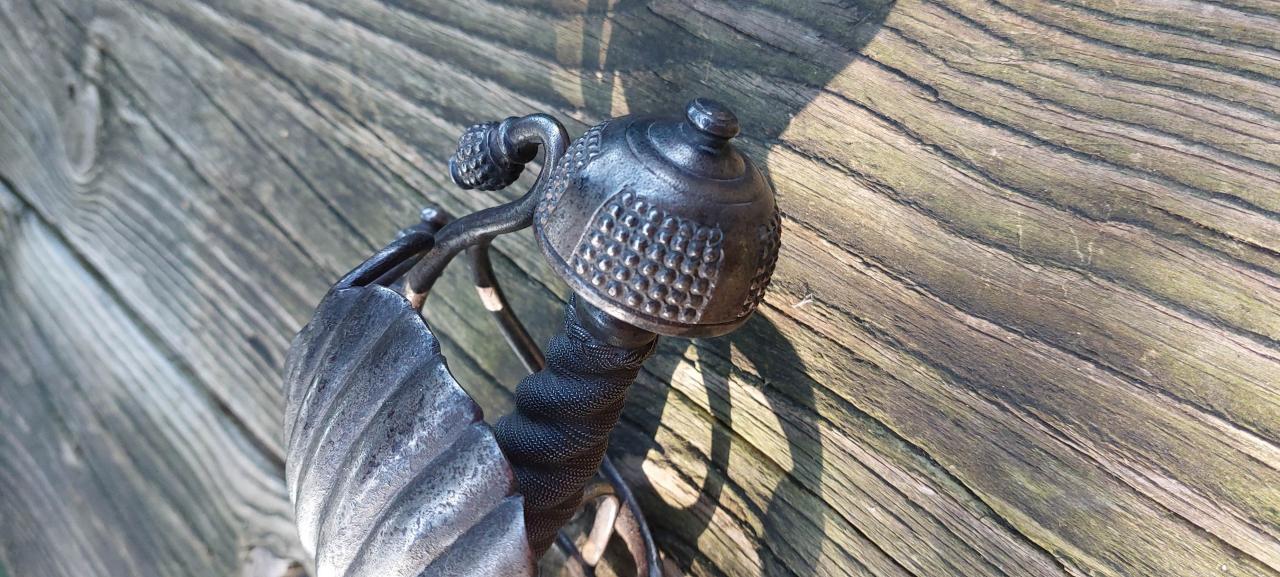

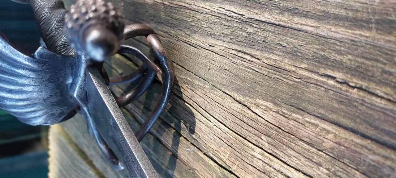

Join Date: Mar 2017
Posts: 451

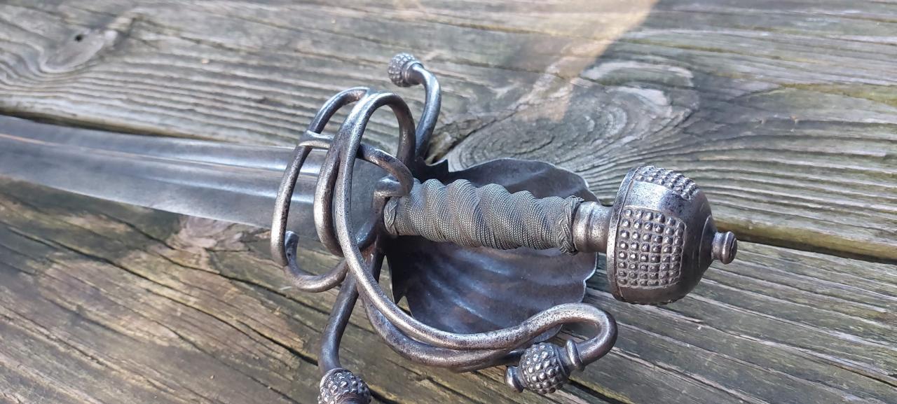

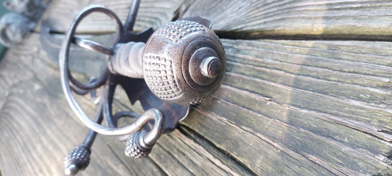

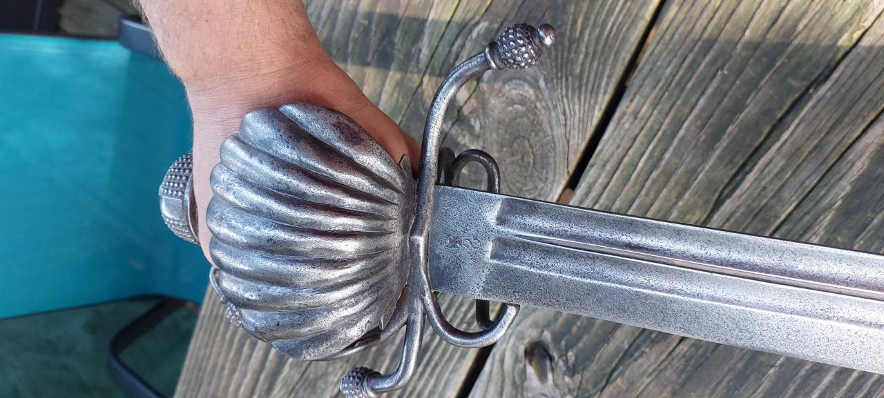

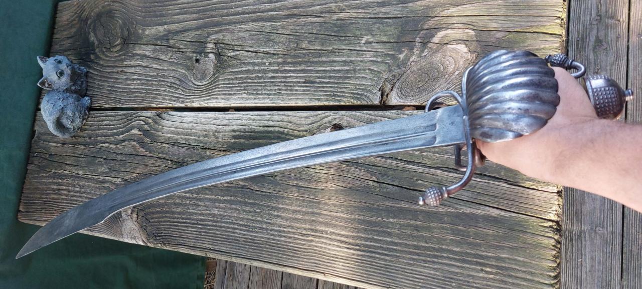

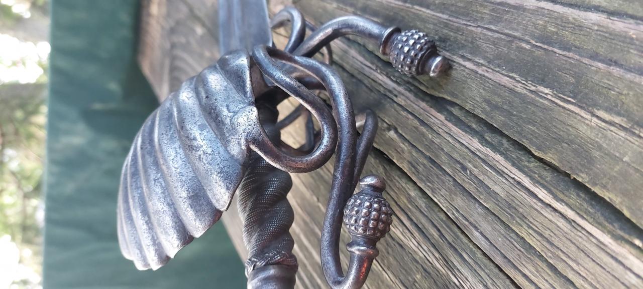

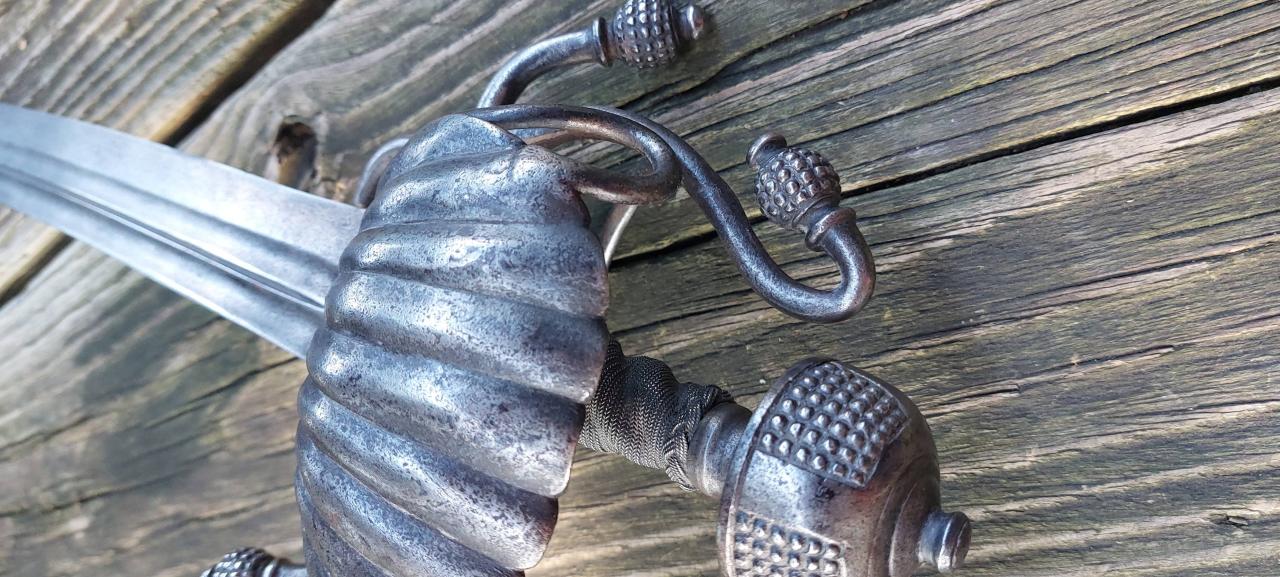

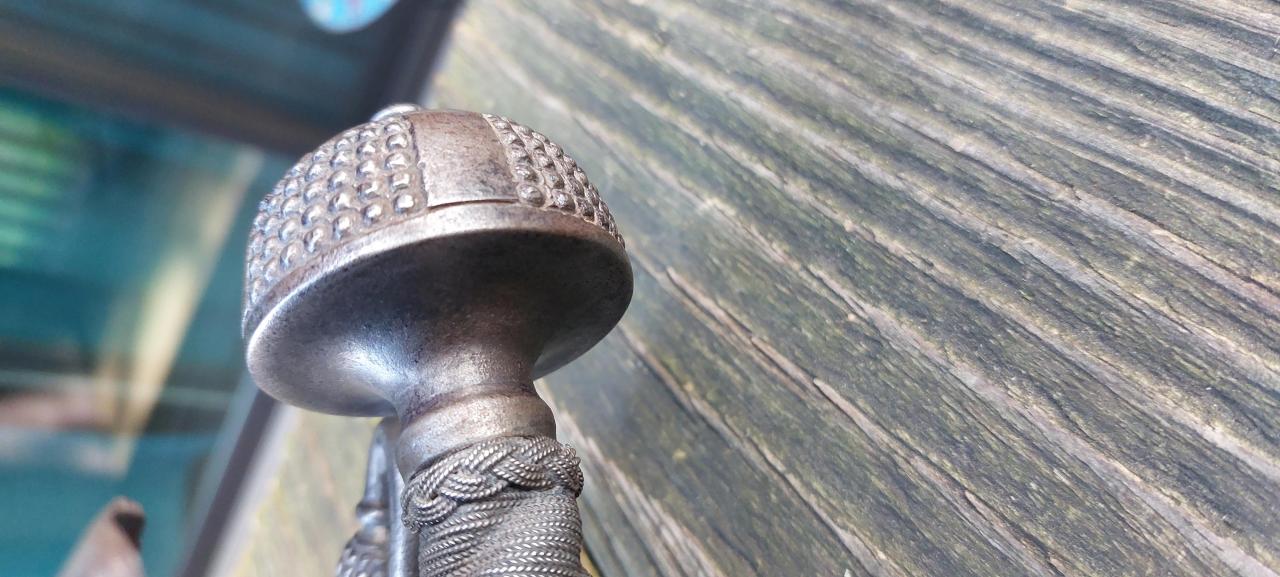

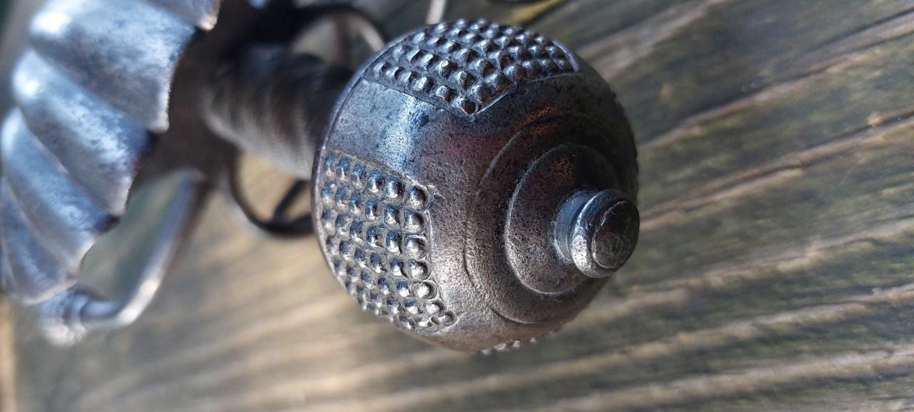

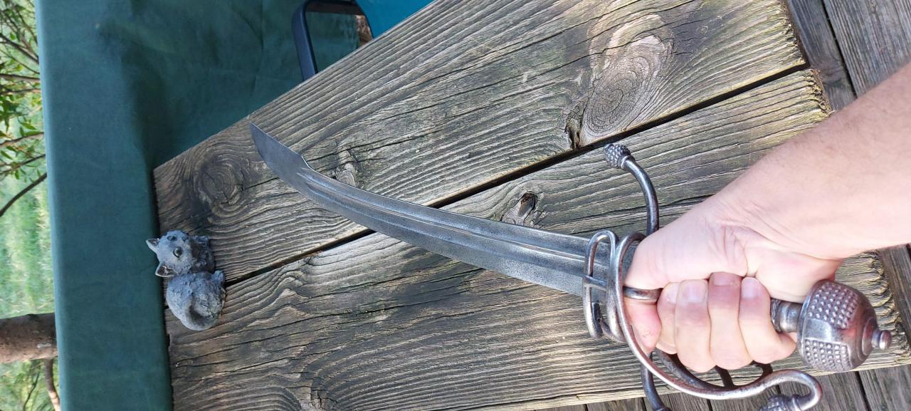

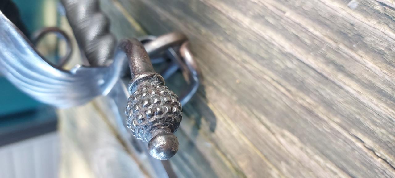

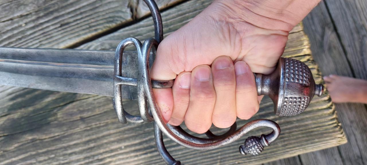

Default Some additional pics taken by me
Here are some photos I was able to take in decent lighting Sunday

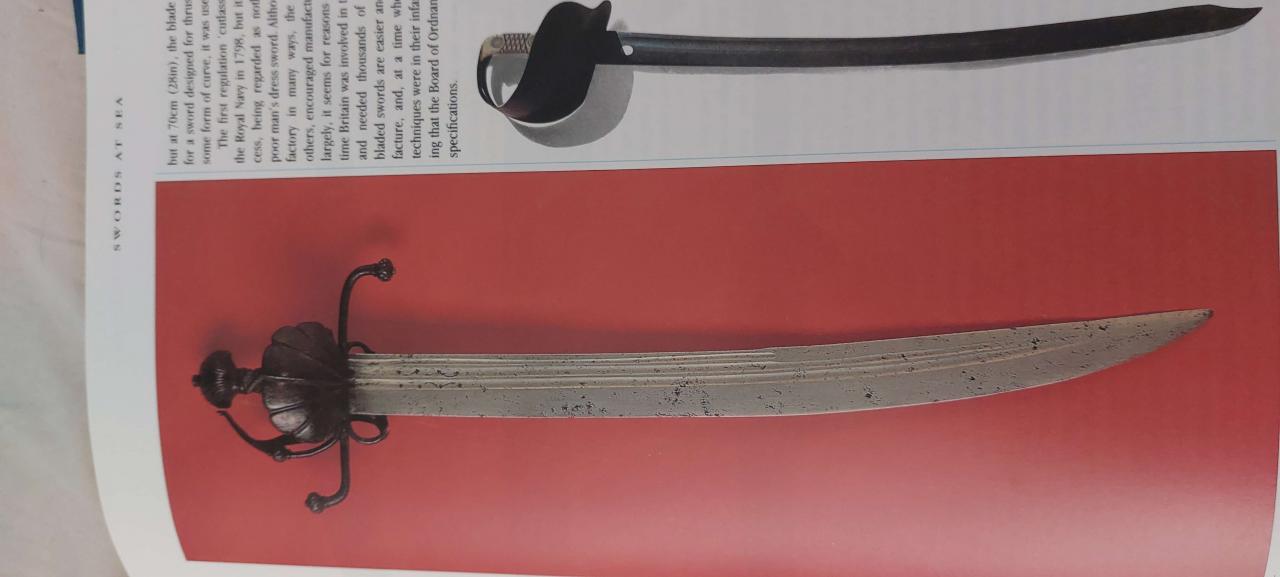

Default additional pics

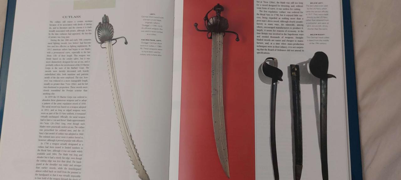

apologies if any pics are posted twice. I also included a reference from a book (Weland's 'Sword Daggers and Cutlasses', 1991) that shows a representative example that I used to compare before bidding on the piece in question. Besides the Michael D. Long example, I had found another previously sold piece and I'm looking for that link, now.

Thank you for the pictures. They are much more clear then the first pictures. The uniform pitting is a sign of artificial aging. Natural pitting is varied with clear steel, deep pitting and wide pitting. The false edge should be sharp right away and not gradually.
The examples in your books are tricky. They are museum examples, shot from a distance and one dimensional. The blackened hilt makes observation even more difficult.
But even then, you should still see the difference with the bars. They do not have the same diameter along their length.
I stand with with my previous assessment.The blades mark might be genuine from a contemporary smith.

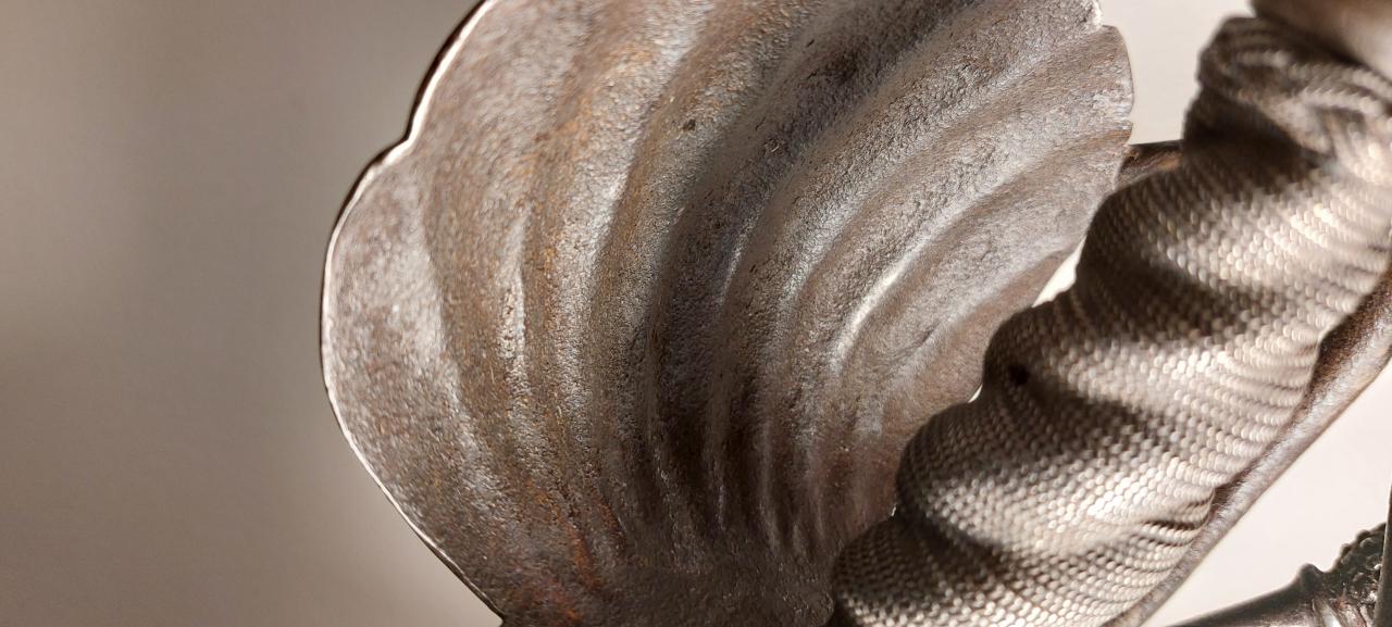

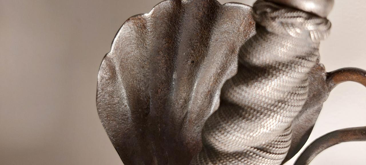

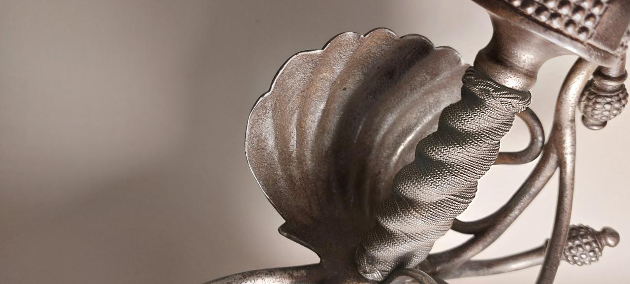

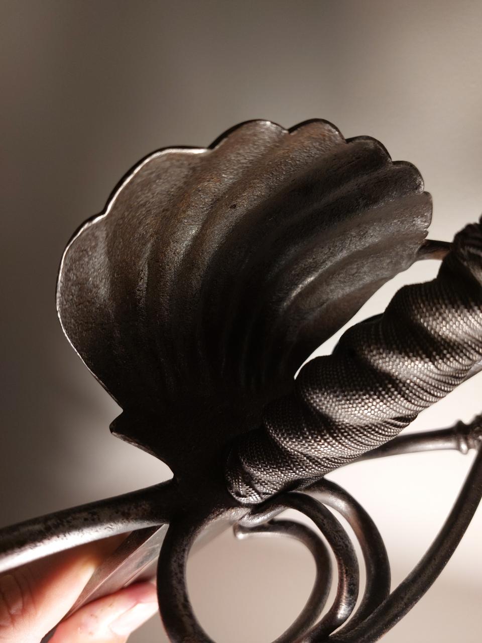

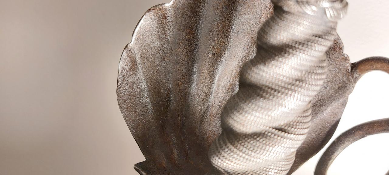

Could you please send an image from the inside of the shell guard?
KR
Andreas
Old Today, 02:43 AM   #14
shayde78
shayde78's Avatar
Join Date: Mar 2017
Posts: 451
Sure thing, Andreas - pictures of the inside of the shell guard
