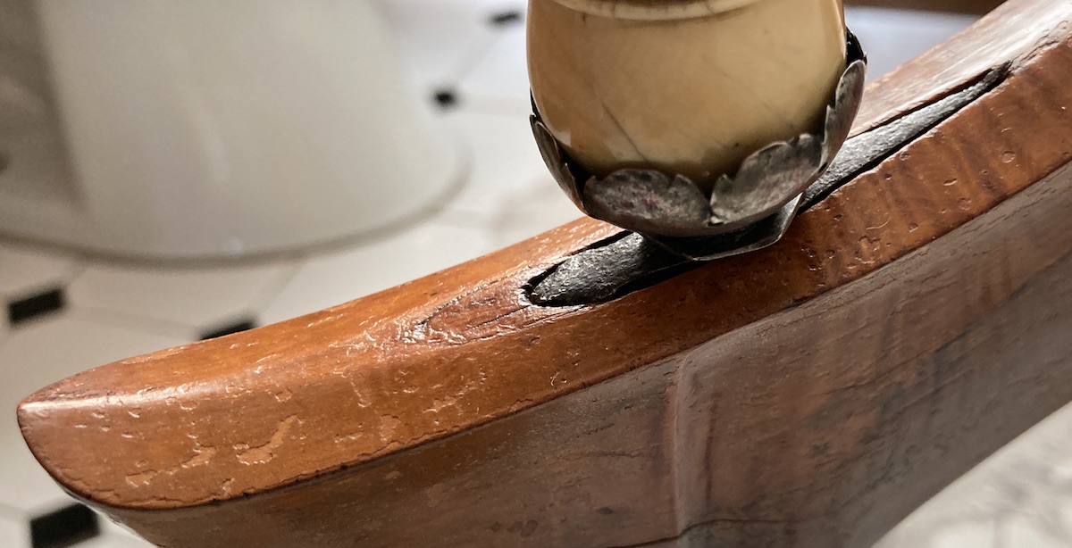

I have cut the wooden plug for the dagu side and it fits well. Now comes the really hairy part, matching the color of the plug to the sheath. This will probably take about a week as I test various agents on pieces of scrap wood and wait for them to dry fully.
The buntut has been covered with a rather opaque stain. I have examined the chip with a magnifying glass and it appears for all the world to be some sort of poplar. The bottom of the buntut (where the stain is less opaque) shows a figure like poplar also. Ideally, I would like to fit a wood piece to fill the chip but that looks like it might be tough to do. I’ll give it a shot but, if I fail, plastic wood will work.

A chip such as the one to the buntut of your keris could most certainly be easily repaired, but my choice would be to leave as is and to make it look like old damage.
If I felt compelled to repair that little chip, I would square the irregular surface of the chip to permit a tight, straight-line joint. Then paper off the entire buntut & hit it with black japan spirit based stain. I would use tinted 5 minute Araldite as the adhesive, make the patch oversize reshape and paper back. Araldite can be tinted with artists powder colour. I would not use plastic wood. Ever.

Here are photos of my efforts to modify the sheath throat and repair the buntut. Thanks to all for your advice about what and what not to do with the sheath.
Sincerely,

Hello Rob,
Very well done! Congrats, a good repair/restoration.

Nice job Rob!

Rob, for a first attempt at this sort of modification, I consider that you have done a pretty fair job.
However, if you are prepared to spend more time on the job --- as your remarks do seem to indicate --- I suggest that you have a look at Post 16 & Post 17.
If you were to completely line the mouth with a contrasting wood, this would turn the minor defect of poor fit into an enhancement.
Yes, it will take time & care, but it will look a lot better than just taking up the space in front of the gonjo with a piece of wood.
I have found that the easiest way to do this job is to fit a plug of wood into the mouth of the wrongko first, I use tinted 5 minute Araldite as the adhesive.
The mouth of the wrongko can be enlarged a bit first but be careful to follow the shape of the gonjo.
After the new wood is in place and the adhesive has cured I drill a hole in the middle of the plug and line that hole up with the tang of the blade --- you place the blade onto the wrongko so that the gandar will accept it, & the top of the gonjo is level with the top of the wrongko (gambar, atasan).
Then you just gradually enlarge to hole you have drilled to accept the gonjo, you smear light oil onto the sides of the gonjo & just scrape away where the oil shows on the new wooden plug.
I prefer a dark wood for the plug, black ebony works well, but it is not all that easy to work with.

I am sure that your contrasting border solution would look far better than the wood plug but it would also significantly modify the sheath throat and that change couldn’t be undone. While it is true that I widened the throat slightly, it was by only .5mm or less on each side so I don’t think that small amount matters. I deliberately glued in the wood plug with a 50/50 mix of liquid hide glue and pine tar which is solid enough to hold the plug firmly but can also be fairly easily undone and is susceptible to heat from a heat gun should some future owner wish to undo my work. The only other change I made to the sheath was to repair the chip in the buntut with a piece of wood. That repair is permanent (I used zap-a-gap cyanoacrylate glue) but it is also invisible so no future owner would even know the repair was made.
I’m pretty sure I could make the border but I’m not 100% certain. The wood for the border would have to be very solidly glued in place before carving out the center, or sections of the border could chip out during the work. If I made a mistake, getting the ruined piece out to start again would be a bear and might damage the wranka beyond repair. I’ll admit it, I’m a chicken.
