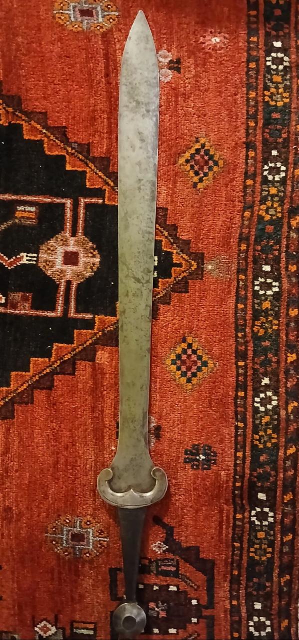

Posts: 298
There are two basic types of jinetas swords, the nazari ones from XVth century, and the battle jinetas, from XII-XIII centuries.
The two described by Nicolle are of the second type.
There are a few others.
One at Alava Armoury, another at Sevilla, in 2024 another one was found in Valencia, in relic condition.
A sword found at Sanguesa (bottom) is a sort of intermediate type.

I find that my sword
Looks a little like these swords.

I remember your Thread, Almonzo. That's a very interesting sword!
I have still to get to the foundational literature on Spanish arms, but I would be a little surprised if that sword was Spanish, or from 13th century Europe in general. However, with that said, you do see small curved guards slightly similar to that in, for instance, the El Puig altarpiece.
