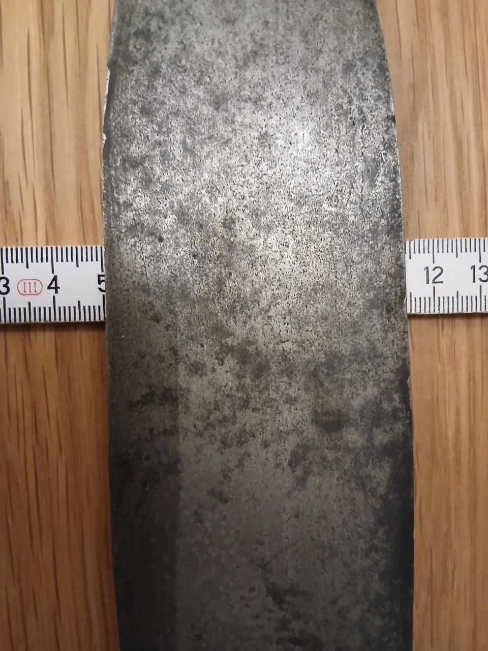

Hello all members,
I'm new here but I read a lot of the forum threads and like edged
weapons.
I have this strange sword to identify please.
For most of my friends it is just a fantasy sword but I think it is good.

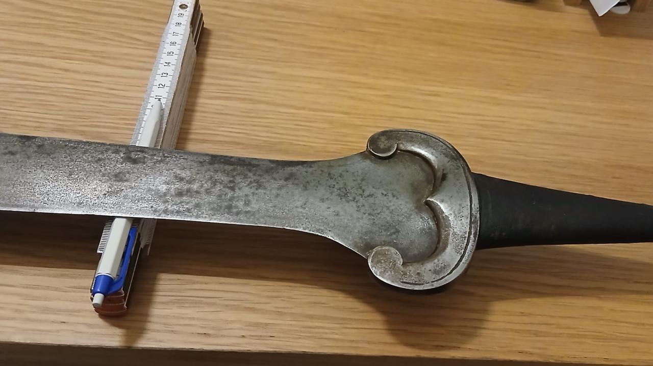

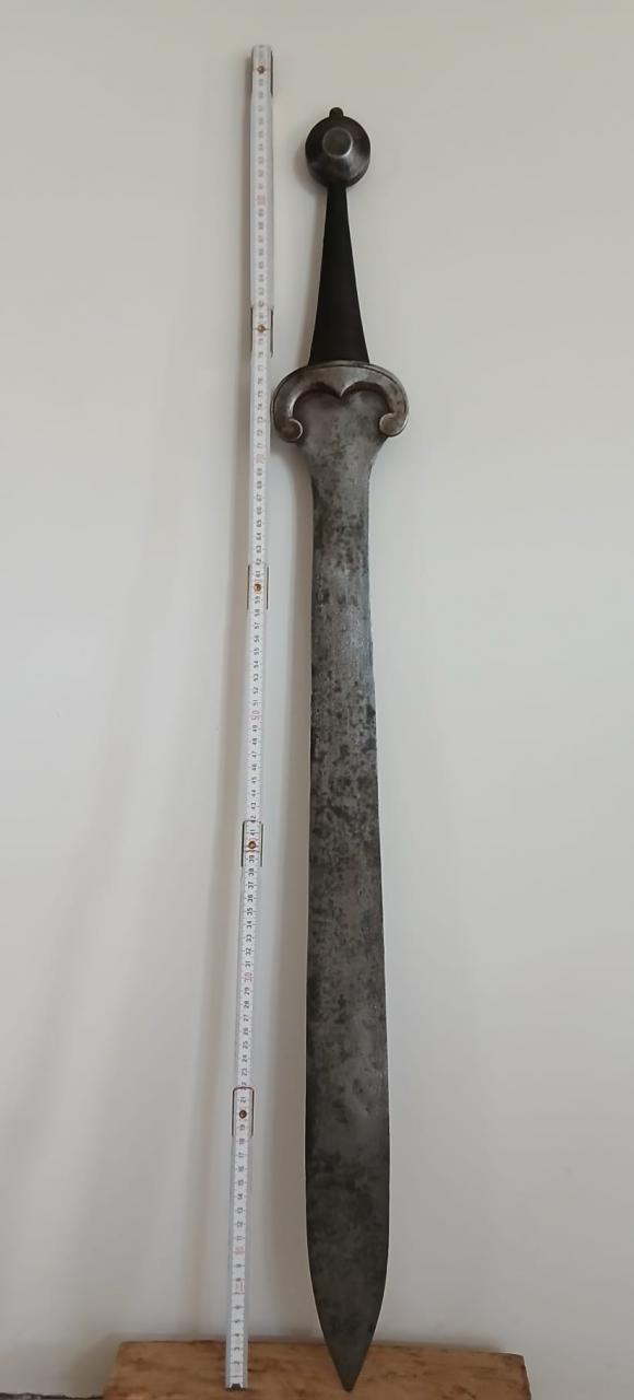

Hello thank you,
I tried , now I hope it will be ok.
Sword is a mix of medieval pommel and hilt with a celtic ? ?
guard and blade
Almonzo is offline   Reply With Quote

Hello, OK thank you !

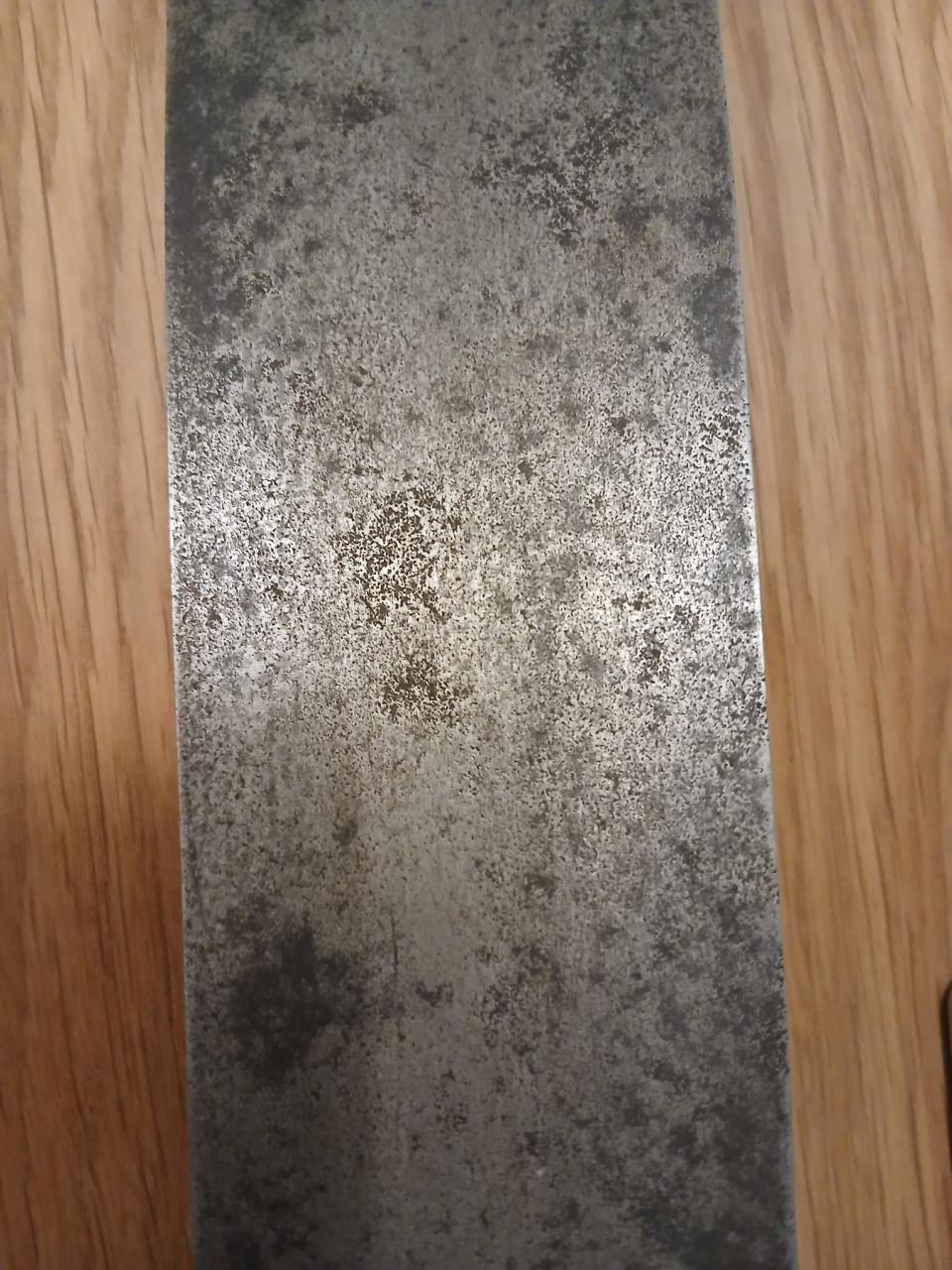

I put other pictures with more light,
The blade is really thin , sharp at edges and 3-4mm at the middle
With no visible central ridge
Thank you

I think that you are correct in your attribution of the styles of the various components. I do not recognize the whole, perhaps something along the lines of an militia infantry sword of the early 19th century, a hunting hanger or a particularly nicely made theatrical prop with some age. Hopefully someone will have more definitive ideas.

My guess would be a 19th century historicism piece, though I can't say I've ever seen another like it.

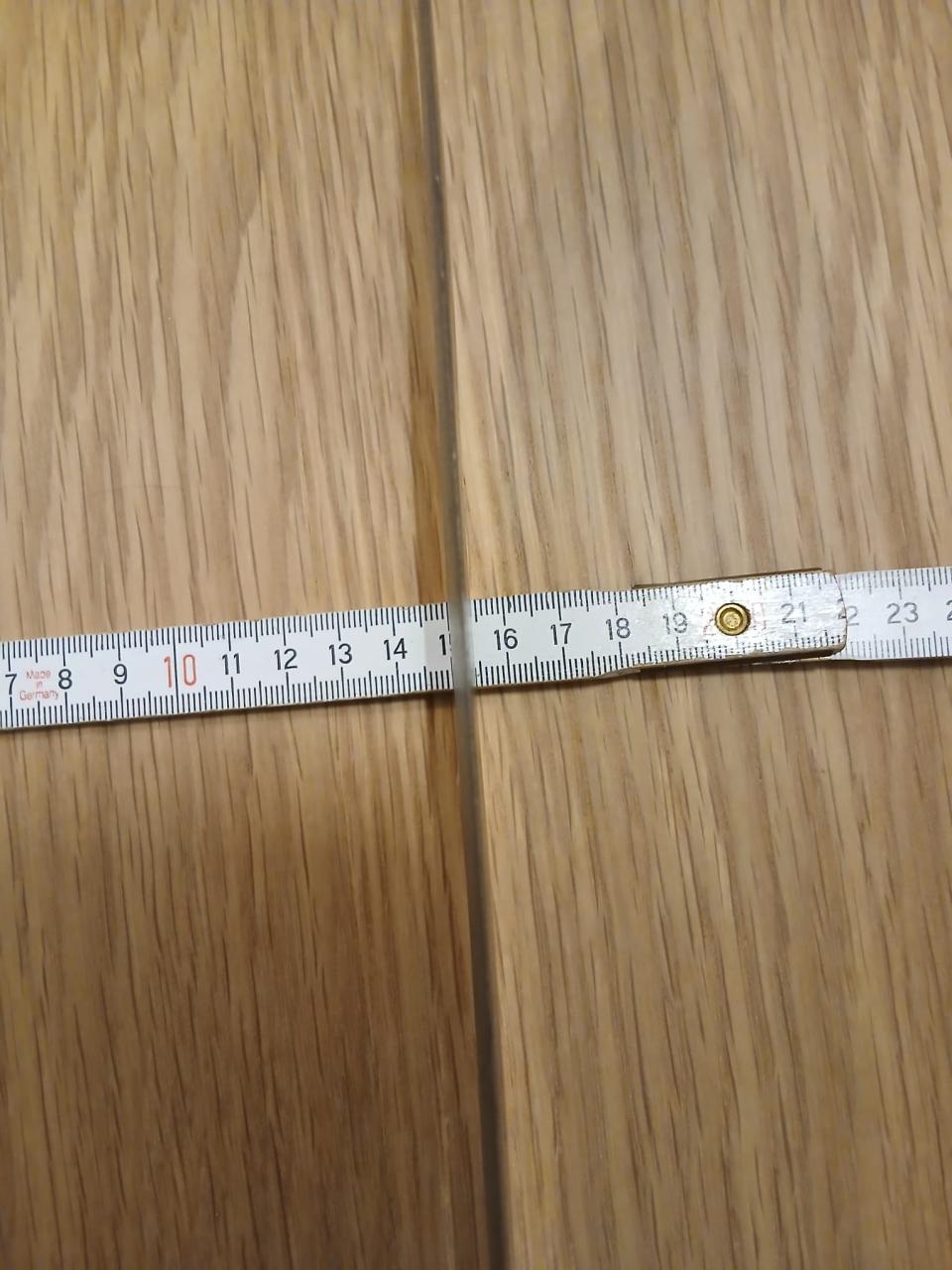

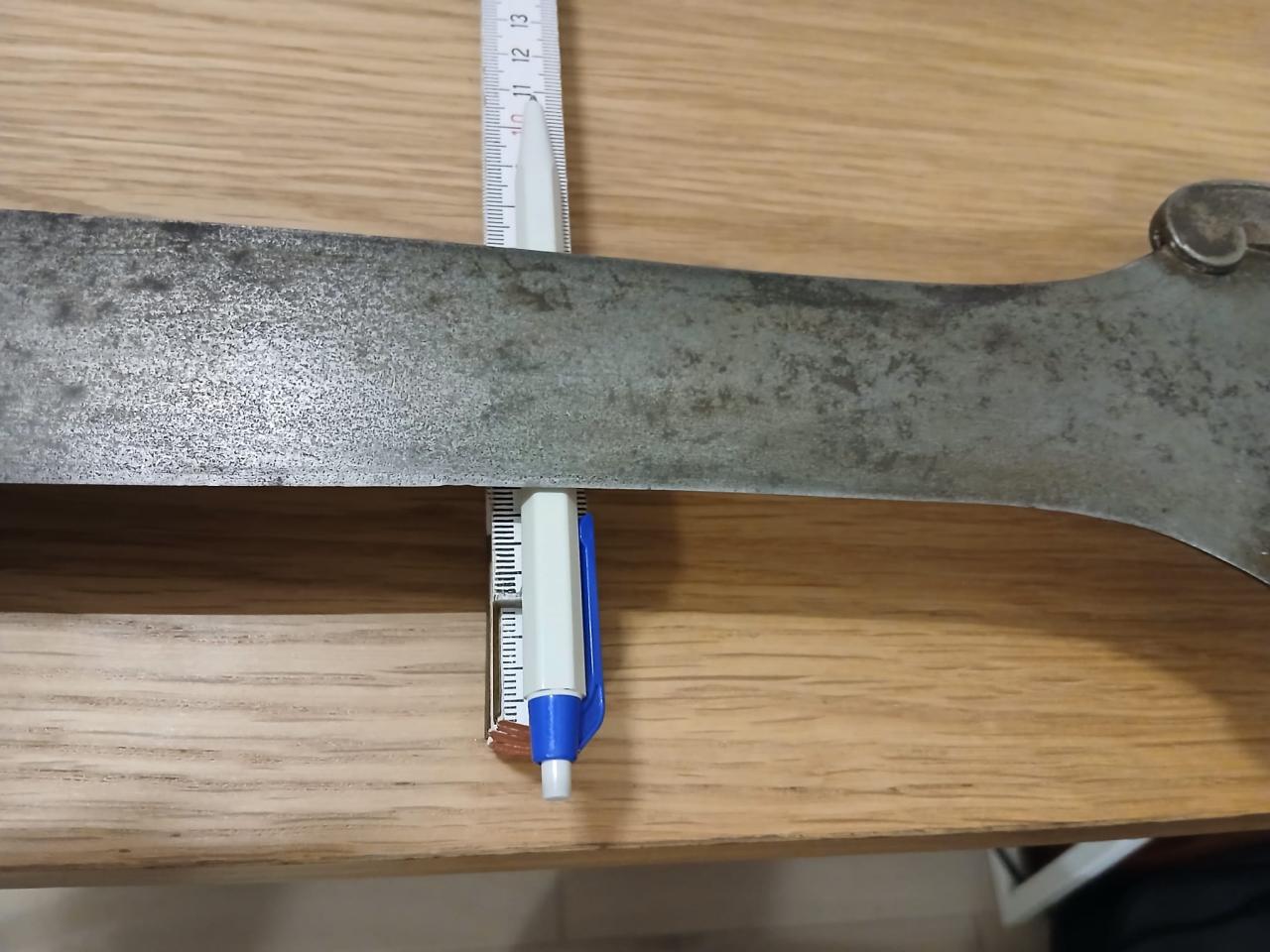

Thank you all members for the messages,
I will look for old European Italian swords .
It is a large sword, I would have mentioned that.
The total length is 97,5cm/ 38,38 inches
Weight is 1,4 kg / 3.09 pounds
Balance of the blade is 16cm away from the guard.
Largest part of the blade is 6,5cm large/ 2,56 inches and really thin ,
a little larger in the middle as I already said
It don't look like a deco piece ,
the blade is really really sharp all around the sword ; except the 5-6 first centimeters near the guard.
For a movie, I don't think it will be the best .

I forgot to write that when I received the sword
It was very rusty and I cleaned it with a lot of baking soda.
I wanted it shiny but maybe it is too much and help to make it seems too "clean'/fake

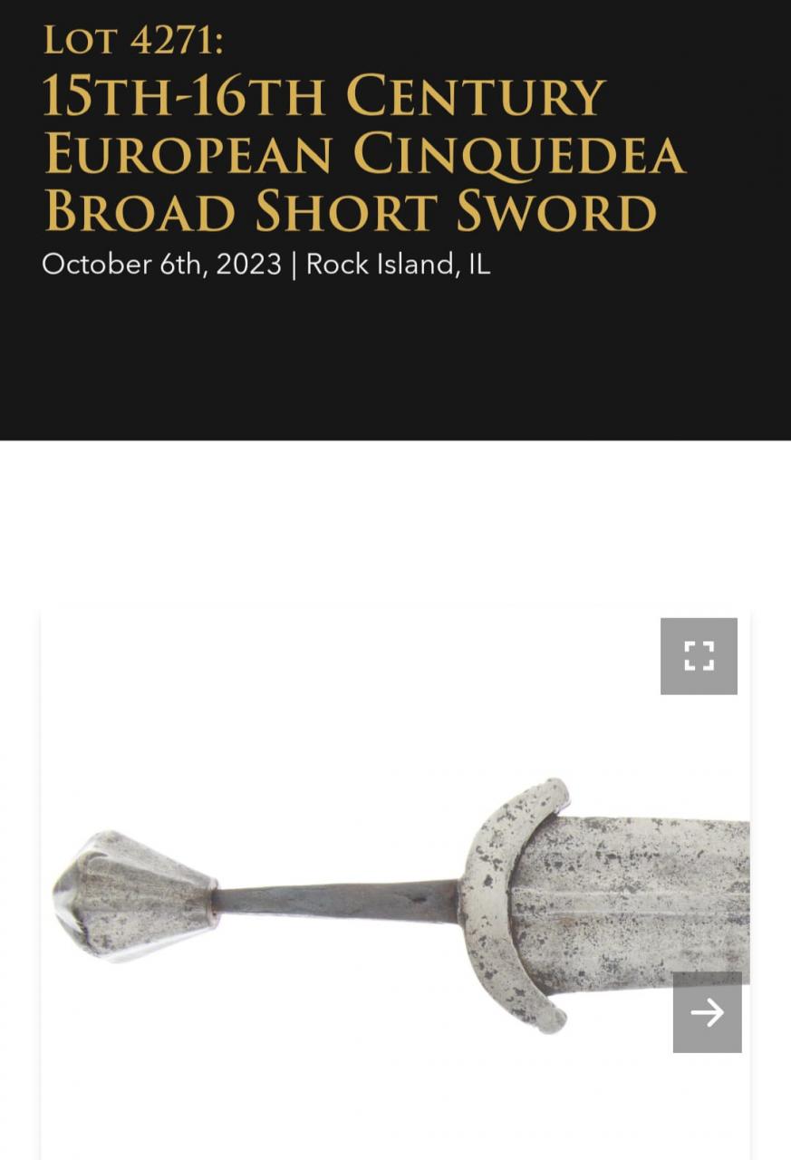

I found , thank you ,
this 16th large cinquedea sword who don't looks older, guard is +/- look like
The pommel is as unusual as my wheel medieval pommel.
Maybe this one is recent too ?
I wonder if there are old steel leaf blades for comparison ,
The ones I found were all bronze made,
Sure iron/ steel avoid humidity and turn to rust then dust
but it is srange that since antiquity,, laTène period.
no celtics or just leaf blades steel models have been kept with care.

I do like the sword, but IMO the proportions are off for an original. The grip is much too long for the overall size of it and it doesn't have the length for a longsword (although it does have about that weight). Proportion wise it actually reminds me a bit of Conan the Barbarian's sword (which is not a slight, as that remains my favorite movie sword).
And the fact that none of us know of any originals that closely resemble it is also a clue. That should raise a red flag IMO.
It may be a composite of original parts, but I think it is 19th c or later, perhaps in emulation of bronze age celtic swords.
