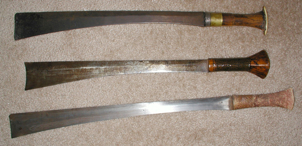

It's a nice dao. It’s not necessarily Naga. There’s a tendency to lump together as ‘Naga’ many of the weapons of the hills of India’s northeast. That form of dao appears to originate with the Kachin/Jingpho and the Khamti but is found among the Lisu, Eastern (northeastern) Naga, and others. In general, the Naga had limited access to iron/steel and often purchased it from outsiders, including the people of the Assam plains, English tea planters (famously using old hoe blades), but for metalworking and the creation and trade of dao blades, eastern tribes like the Kalyo-Kengyu and Konyak seem to have been foremost. But most Nagas carried rather differently shaped daos; this type seems to be fairly rare in photos at least. On average, Naga dao blades look cruder than the typical Kachin dao as well. It seems that much technological innovation among the Nagas came from the east, including crossbows.
Kachin/Khamti-type daos have flared pommels. It seems that on many Kachin and Khamti daos, at least, the pommel cap is of ivory, with Khamti examples often having squared-off ends of the ‘flare’ (similar to the hilts of some Adi and Mishmi long knives). Other examples often have plainer, more rounded hilts/pommels of all wood. This could indicate that it belonged to a different people or was made for harder or more utilitarian function or represents some simplification over time or even wartime scarcity of materials (I too have one that I am convinced is a simple WWII bring-back, likely from Burma). One type of Kachin-type dao blade is pattern-welded in the manner of many Tibetan sword blades.
Written sources and photos would suggest that they could be found in the general area where these people above meet, perhaps in northernmost Burma, around the Dhemaji, Dibrugarh, Tinsukia and Sibsagar districts of Assam, the adjacent portion of Nagaland, the Tirap (Dirap) District of Arunachal Pradesh, and perhaps as far south and west as northern Cachar.
Three varieties pictured below: one with ivory pommel cap and brass ferrule (grip wrap missing), probably late nineteenth century; one with lacquered wood grip with lozenge-section pommel, early/mid twentieth century; one long (28-1/4”/72 cm) example with fiber-wrapped hilt and “hairpin” laminated blade.

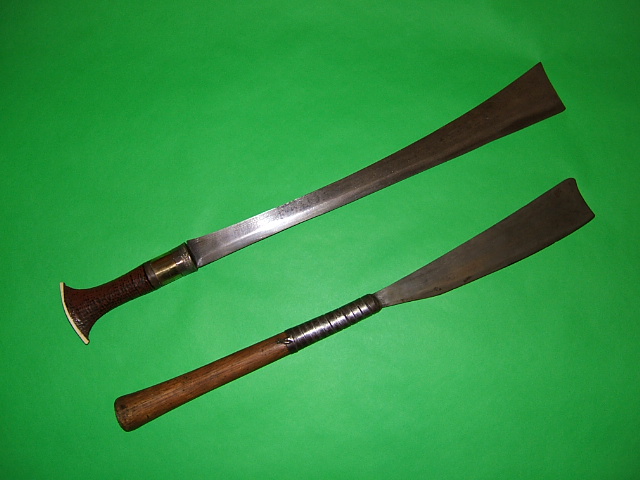

Here are two of mine the bottom one is axe like is it Kachin or Naga in your opinion?
Lew
Old 29th July 2006, 01:59 PM   #6
Posts: 4,748
Hi Lou and Dennee.
Pardon my intruding but the weapons of this area are a particular interest, especially in relation to the Kachin (Singpho) who appear to have borrowed several styles of dao and dha from their neighbors -- the working dao of the Khamti, and perhaps the sword-dha from the longer versions used by the Assamese and nearby groups.
Dennee has made some excellent points about the tribal differences and interactions in weapons styles of the N.E. India/Assam/Nagaland area. Lou's two examples highlight a couple of those differences. The top one being a Khamti/Kachin dao (worn in an open faced scabbard) and the bottom one is a typical Naga dao (worn in a wooden frog over the right buttock).
An excellent reference for this area is Ian Heath's Armies of the 19th Century: Asia. 3. India's N.E. Frontier. Foundry Books, Guernsey. 1999.
Ian.
Old 29th July 2006, 03:27 PM   #7
Andrew
Andrew's Avatar
Location: USA
Posts: 1,725
Great post, Dennee, thank you.
Ian, I agree that Lew's bottom example is a Naga axe dao. The blade/handle proportions are a bit unusual to my eye.
Old 29th July 2006, 03:44 PM   #8
dennee
Location: College Park, MD
Posts: 186
Ian is, of course, correct. The bottom one is Naga as suggested by the longer haft and its consistent section--usually round, sometimes rounded square, etc., but while the Naga haft may taper, there is usually no pronounced flare or distinct pommel--except for on some Kalyo-Kengyu and Chang almost-all-steel examples. Naga hafts are usually longer than the blade or head, although there are later examples in which the reverse is true. Naga hafts may be decorated with dyed goat hair, but they usually don't have a distinct, wrapped grip as do the Kachin type (although one of the photos in Jacobs's book shows a Naga dao haft with a pair of plaited rings at the grip). Naga daos simply have a rattan wrapping to hold the haft around the base/tang of the blade. I have sometimes thought that while the Kachin/Khamti type might rightly be called "dao" ("sword"), perhaps we should refer to Naga edged weapons as simply axes because of the differences between them. Lew's Naga example is perhaps the closest in form to the Kachin/Khamti type and yet there are all the differences cited above as well as in the blade shape. The latter has a pronounced concave back to the blade and more or less straight edge and the former typically has curved edge and spine (and often a raised bead near and parallel to the spine on the same side of the blade as the ground edge). And while both are clearly chopping weapons, Lew's Naga weapon really shows that these were both weapons and, even more important, tools. There are a lot that have clearly been used a great deal and re-sharpened. I have seen the Kachin/Khamti type with dings in the blade, but I haven't seen one with such signs of use, suggesting that some of these, at least, were closer to pure weapons and status symbols (as might be suggested by the more fragile ivory pieces on some), at least within, say, the past century and a half. Of course, Naga blades are deeper to begin with, with the edge representing a smaller proportion of the depth of the blade. The chisel-ground edge of the Kachin dao, while it varies somewhat from blade to blade and within the length of a single blade, can be nearly half the width (or depth) of the blade, but is generally about a full third.

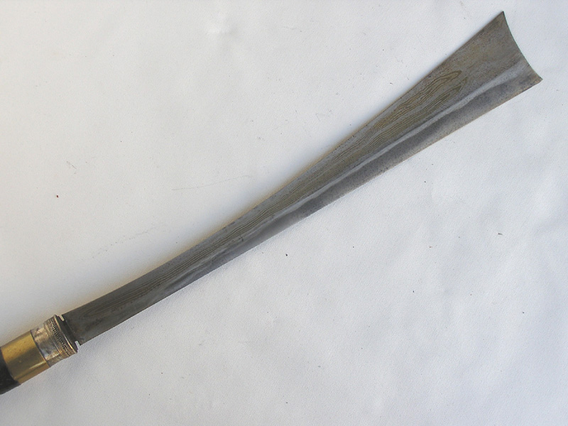

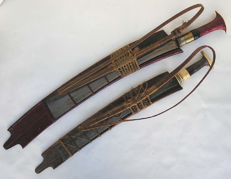

Here are a couple references to Kachin dha that I have found.

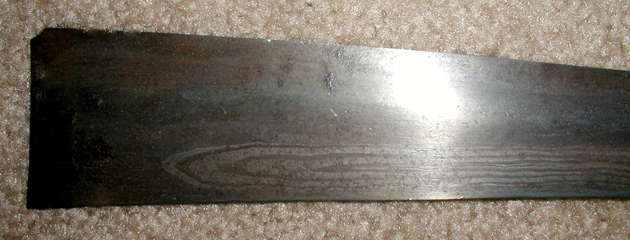

... some of the Hkahkus make what may be called genuine Kachin blades. These are about eighteen inches long, broadening from the handle outward. They are never pointed, as in the Shan dah. There are at least four varieties, of which one with clear, wavy streaks of steel running down the blade, is the most valuable and appreciated. This sword was carried especially by Chiefs and persons of importance.

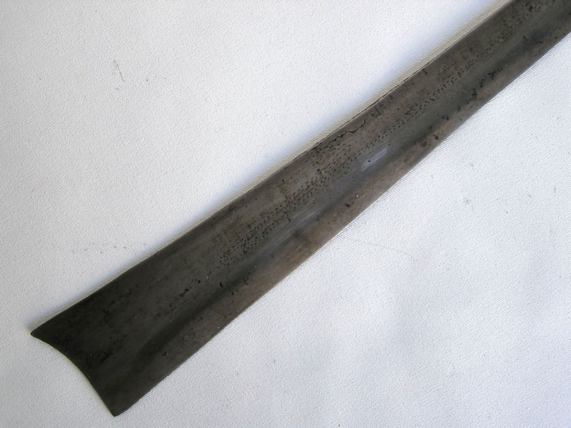

Hanson, "The Kachin, Their Customs and Traditions" (1913), p. 76 (italics added). The first photo below is on the facing page, and shows a group of Kachin men, some of whom carry dha as described. The second photo is of a couple in my collection, the top one of which has the wavy streaks Hanson describes (see third photo). The lower one, which does not have the pattern in the steel, is interesting because it has a punched decoration of wavy lines in the blade that I think is meant to represent the wavy pattern of the more valuable variety (the dot pattern in the fourth photo).

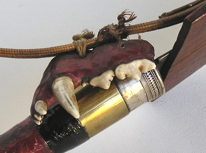

A dha in its half-scabbard, fastened to a bamboo hoop, decorated with charms, such as the canine or molar of a leopard or tiger, and suspended to a red cloth band ornamented with cowries, is also slung over the right shoulder.
Anderson, "A Report of the Expedition to Western Yunnan" (1871), p. 121. The top dha in the second photo has a talisman such as Anderson describes, a jawbone probably of a leopard (see fifth photo).
