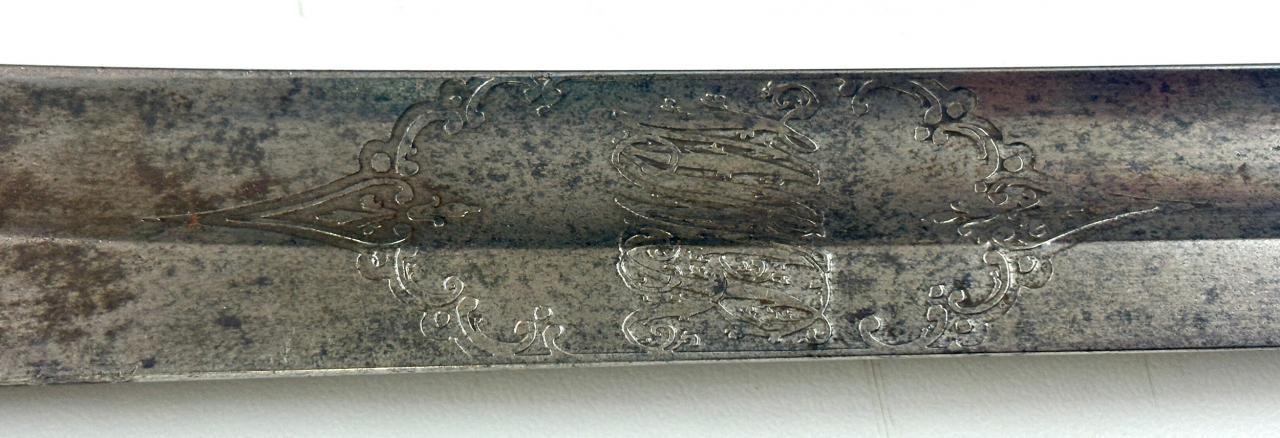

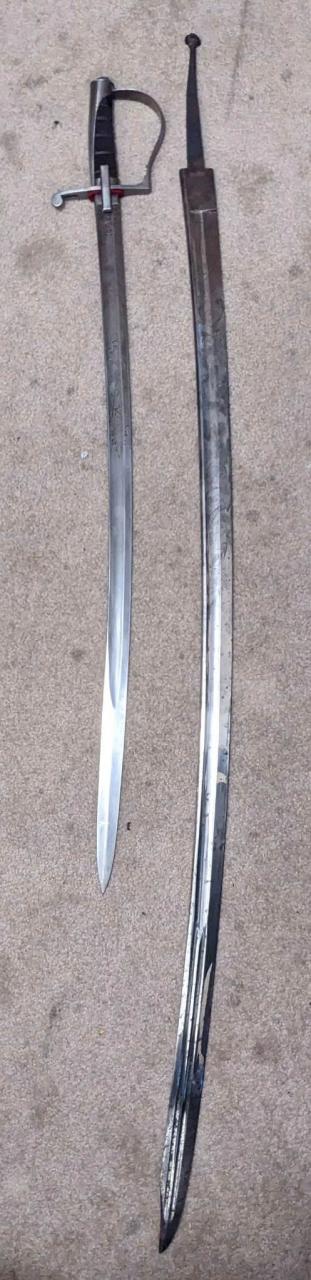

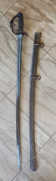

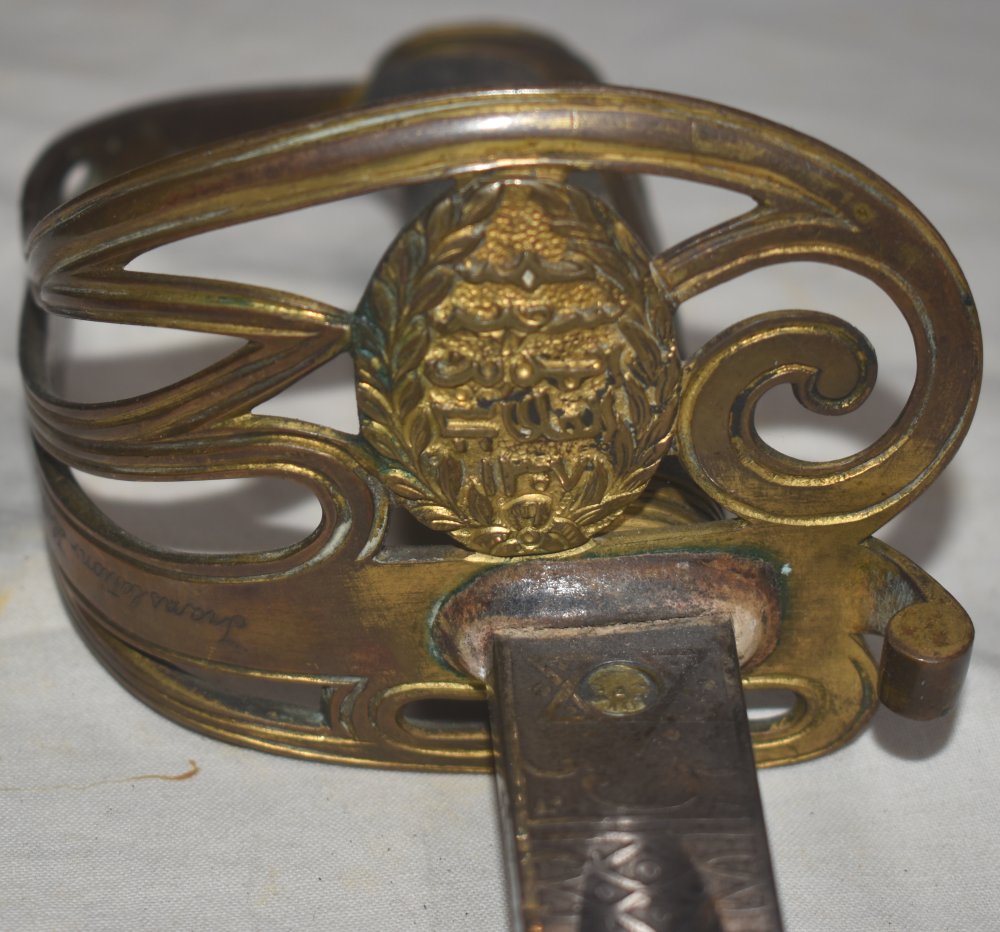

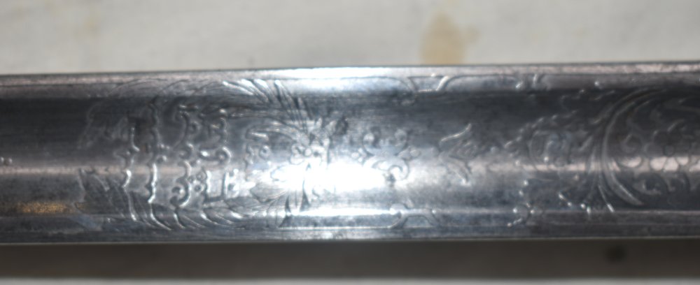

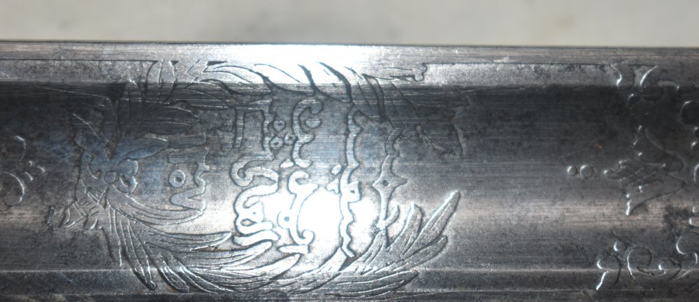

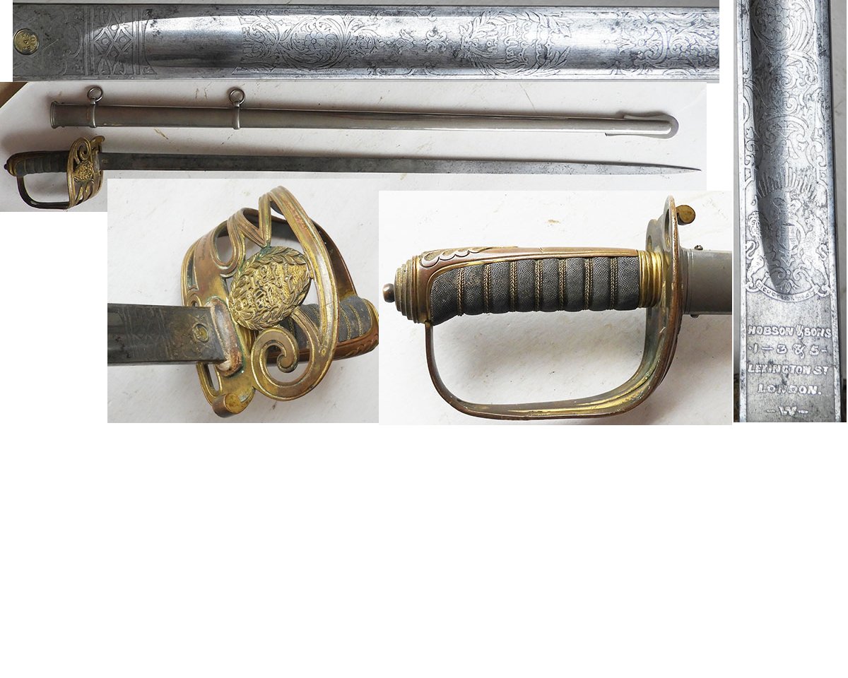

Hello, I hope everyone is doing well. A bit unsure where to place this sword, but as it is a European form, I feel this is the best place. Apologies for the photos, they were given to me by the current owner/seller and are all I have to work with.
Earlier this year I came across an unusual British pattern 1892 sword. Even without the mysteries below, it is in extremely good condition for the price I paid. It is mine as soon as I can arrange its shipping from NZ. So far, I have not gotten very far in the research.
Why is it unusual?
-The 1892 pattern was only in usage from 1892-1895 broadly. And since officers were not obliged to buy a new sword that utilized the same type of hilt, many did not. It is the least common pattern of sword. Off topic, but you actually see a larger amount of 1845-95s, in which officers who were obliged to upgrade the hilt simply rebladed their current sword and didn't even bother with changing to an 1897 hilt
-Both the blade and the guard have a customized Arabic script, identical on both. Custom etchings on blades are quite common, but I have seen relatively few customized brass guards. Variations for general officers and for other nations are observed, but as I will get into later, the plate here does not appear to be indicative of a specific unit affiliation or monarch.
-The sword or at least the final assembly was made by Pillin, but retailed by Hobson & Sons. The specific address was in usage from 1886-1901, which is within the bounds of the pattern. While some customized swords were purchased from tailoring outfitters such as Hawkes or Hamburger, Rogers & Co with strong military affiliation, it is unusual that one simultaneously not unusually fancy but is unusually different wrt a custom plate, appears to have been ordered from a tailoring outfitter instead of going directly to the cutler. I am unsure if Pillin ever had a storefront location like Wilkinson where well heeled individuals could get very custom things.

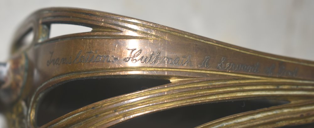

-At some point, someone with an engraver chiseled out "Translation: Huthmath, a servant of God"
What does the engraving even say?
That is the part I am trying to understand. After slowly bouncing around finding polite ways to ask people "does this look like Arabic to you?" without sounding racist, I ended up emailing my college professor of Islamic history. Turns out I had translated the date at the bottom wrong. The date is 1307 in the Hijri dating system. This roughly correlates to 1889-1890 in the Gregorian system.
So we can assume that the sword post-dates the reason the sword was commissioned.
According to my professor, most of the text translates to "Hamd Sa’id Ahmad bin al-A’ali (the highest)" and potentially something like 'shaykh,' as he was unable to fully translate it. According to him, the format of the naming is close to Omani naming conventions. As of my scant research, Faisal bin Turki bin Said Al Busaidi was the ruler of Oman at this time, taking control in 1888. I have had no luck finding anyone of the name on the guard and blade.
My questions or goal are to solve:
1. What is the 100% correct translation of the guard and blade
2. Who is the individual mentioned on the guard and blade
3. What or why is Huthmath?
Further more, even if I am able to find someone who can fully translate the text on the guard or the blade, I have found no sort of provenance. I am well and truly stumped here. If you have any suggestions or advice, I would greatly appreciate it. Thank you!
Magey_McMage is offline   Reply With Quote

Well well well!!!!, Yes its Arabic and likely to be of Omani provenance. I was in the Omani Army for 10 years and I can tell you that this sword is well worth looking at and researching ...Pillin is one of the better sword makers. The wording is peculiar and may just be a complete error, thus the english word TRANSLATION appears. You might get some sense out of The National Museum of Oman in Muscat... or even by contacting your Embassy and they might play ball and forward your request ...With a date mark on the blade plus the maker...are there any numbers on the blade on the back edge near the hilt ? Just a wild guess I would say a high ranking official purchased this ...in London... and it may be traced to either a high ranking Officer or dignatory of some stature...Either that or it could be some sort of gift from one country to another...ie to or from Oman who knows?
I am just about to get busy with pictures and research on British Infantry Officers Swords of the 19th C ...Please see British Infantry Officers Battle Swords in the 19th C...and up to 1914 this is essentially a variant of one of these... I would be delighted to see this placed on that thread in addition... Many thanks for showing this one to Forum.
Peter Hudson.
Note; I agree that this sword probably joined the system in the Reign of Faisal the Ruler from 1888.

Excellent and well informed input Peter, as would be expected with your remarkable field experience in Oman, and I can see why this amazing sword piqued your interest. This is a fascinating example, and well presented by Magey with impressive research and background already set forward.
As already noted, there was a considerable network of cutlers and military outfitters in London that had evolved through the 19th century who often tailored officers weapons on the commissions placed. With Great Britain's profound colonial presence in various spheres, there were cases of some of these having outlet offices in locations in India, Egypt and in Arabia, where the British Protectorate was centered in Aden, if I understand correctly.
Wilkinson has been well known as having been most accommodating customers and clients with customized hilts and engraved blades, which in some cases were in other languages, though unusual. With the retailer/outfitter noted situated in London, it seems likely the present incarnation of the sword in entirety was also completed there.
The sword was apparently updated at some point with translation engraved by other than a sword outfitting location, so probably by a jeweler and for the owner at the time.
The hilt is of what is known as the 'Gothic' style, which was introduced actually in 1822( I believe) for infantry officers and of course in brass. The same pattern continued and was altered in 1845 (again if I recall) to add a folding inner guard portion. Magey has well researched this pattern evolution already, so mentions the intricacies of some of the nominal alterations in the style, which was superceded in 1897 by the sheet steel guard forms.
As noted, officers had a degree of latitude in their choice of weapons, especially those with long service who held to their traditions.
These 'gothic' style hilts were often made for other colonial interests by Wilkinson, with various emblems, cyphers and monograms as required for other countries and their militaries, so while unusual, not surprising to see a customized hilt made on request as seen here.
The overall character of the sword with these inscriptions in Arabic (but as noted apparently following Omani convention) suggests this sword may have been diplomatically oriented, and possibly of course related to the Aden based protectorate in Arabia. Naturally, the details of this situation are the somewhat perplexing conundrum of this outstanding sword, so I look forward to further research!

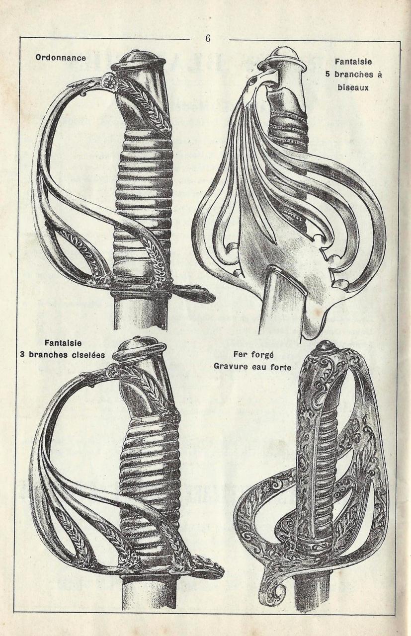

Old 1st December 2025, 07:17 PM   #4
Magey_McMage
Join Date: Sep 2025
Posts: 11
Hi Peter, thank you so much for the reply!
I have tried to contact museums before and generally have little to no luck. I will share, as a gift to the forum for all the help I have received so immediately, one of the rarest or most unusual things I possess, an extremely unusual Italian 1855 blade. I had won it from Czernys and reached out to multiple Italian museums for any advice but never received any feedback. It is, in all dimensional measurements, almost perfectly 1.5x the size of a standard 1855. It has a 121cm blade that is ~45mm wide and about 12-13mm thick. It weighs around 2150 grams, or about 4.8lbs. Made by a Solingen blade factory like most Italian blades were. It is engraved, not acid etched, but that is common for a lot of Italian swords as well. The sword featured for comparison is a slightly irregular 1855 with an 84cm blade more in an Anglo-Austrian type of grind. The sword has been heat treated and there is a nice spring tempter to it. It so far is my ultimate Mystery Sword to uncover. I am tempted to commission a proportional guard, grip, and backstrap/pommel, albeit grips were usually ebony and the cost would be high. The other thing I have long been tempted to do is extend the tang another 5-8cm out, still have a grip made, but have a complex hilt made and have the mother of all "swiss sabres." Just as a physical piece of steel, the length and thickness of the blade is so massive you could make multiple regular sized swords from it.
Apologies, that became off topic quite quickly, I simply wanted to share an example of one I have attempted to research via museum previously that so far has no results. I will go ahead and begin to research various museums alongside potential domestic (US) academics that may have a focus in this area as well. Should I find any further information I will be sure to let you know. I have loved finding other unusual cross-cultural swords from older threads, the Tulwar with the hybrid tulwar/gothic hilt with an elephant where the VR Cypher would go has been one of the coolest damned swords I have ever seen. It is quite sad how we can find notes and drawings in Wilkinson Patterns & Blade Rubs on all manner of specially made swords for kings and foreign armies, brief descriptors on unusual blades or experimental hilts, but so little of it survives through today. I can only hope that there are others hidden away in private collections that may one day be cataloged and photographed for public knowledge.
I am still on double secret probation and my replies do need to be reviewed first before posting, but I will either link to the thread you mentioned, or copy the text and images over there. Most of my British and French collection so far has been focused on 2 things. #1 is simply to posses at least 1 of every standard regulation pattern (albeit the nicer options) just as a baseline. #2, like the sword that is the focus of this thread, is to find the unusual items. I am quite fond of patent solid hilts. I am well aware of the claims of them being "extra" durable is likely marketing, but in a way that is hard to explain online, the extra mass in the hand and a wider and thicker blade at the ricasso (not always, I've 2 infantry patent hilts and 1 cavalry patent hilt that have wider but thinner blades at the ricasso) allows for a cutler to shape the feeling of the sword with a greater degree of freedom. And THAT is why they are better, in my opinion. They feel livelier in the hand. Regardless, I have been pushing to find non-regulation sabres, especially officer sabres, for my own niche focus. The French, like I mentioned in the other British sword thread, had some truly wonderful designs that pre-date the 1882 pattern infantry sword. The massive one I linked, with a flattened diamond 950x35x8mm blade is my favorite handling sword I own. The balance of it is sublime in the hand, it feels regal, like a knight's lance. I am attempting to flesh out these non regulation swords more with a focus specifically on how they handle. In a time when you had both centuries of skilled-trade craftsmanship but also the advent of the industrial revolution, combining machinery with man and mathematics and science and numbers with tradition, this era of swords interests me the most. Laboratories and tests to find the most perfectly optimized swords. And in that era, when they had things down to exact sciences, people STILL chose deliberately non regulation swords. It is those swords, and why they chose them, that interests me the most.
Some were fashion trends, such as the Royal Navy liking shorter claymore blades, or French infantry officers and Toledo pattern blades. But when the Wilkinson ledger has an officer make specific requests, there is something deliberate there, something they thought would make for a better sword. I dont believe there is ever 1 perfect sword out there, and there is no thesis statement of mine that shakes up the antique sword academic world (beyond Patent Hilts feeling more lively in the hand == a better sword by ease of handling), but I want to have a large enough collection that I can point to general unusual trends and deviations and find what works and what doesn't work on the subjective grading of my own tastes.
Or, in other words, I collect the swords I think I would enjoy using the most.

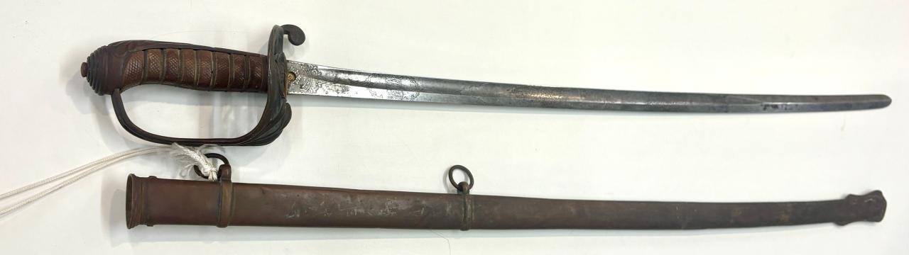

Old 3rd December 2025, 11:34 PM   #7
Magey_McMage
Join Date: Sep 2025
Posts: 11
Thank you for that correction Robert! I did indeed get it backwards not unusual more often these days I fear.

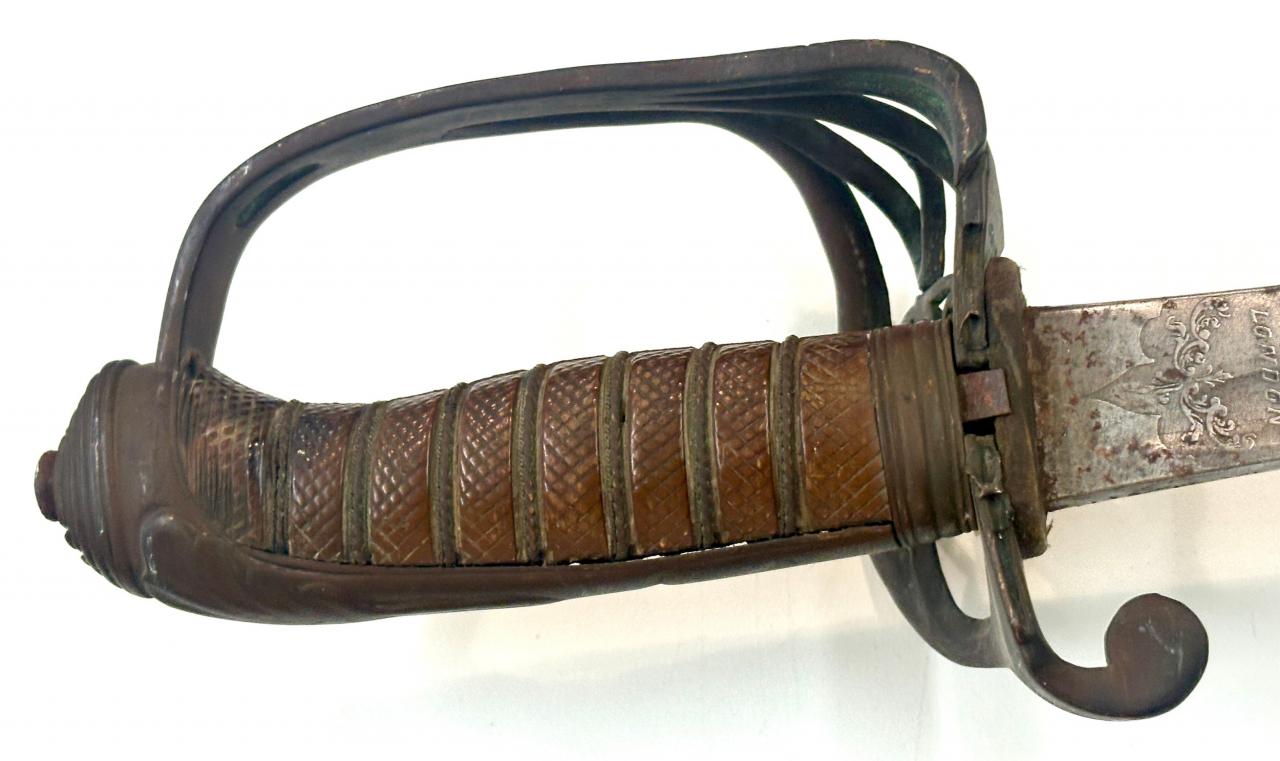

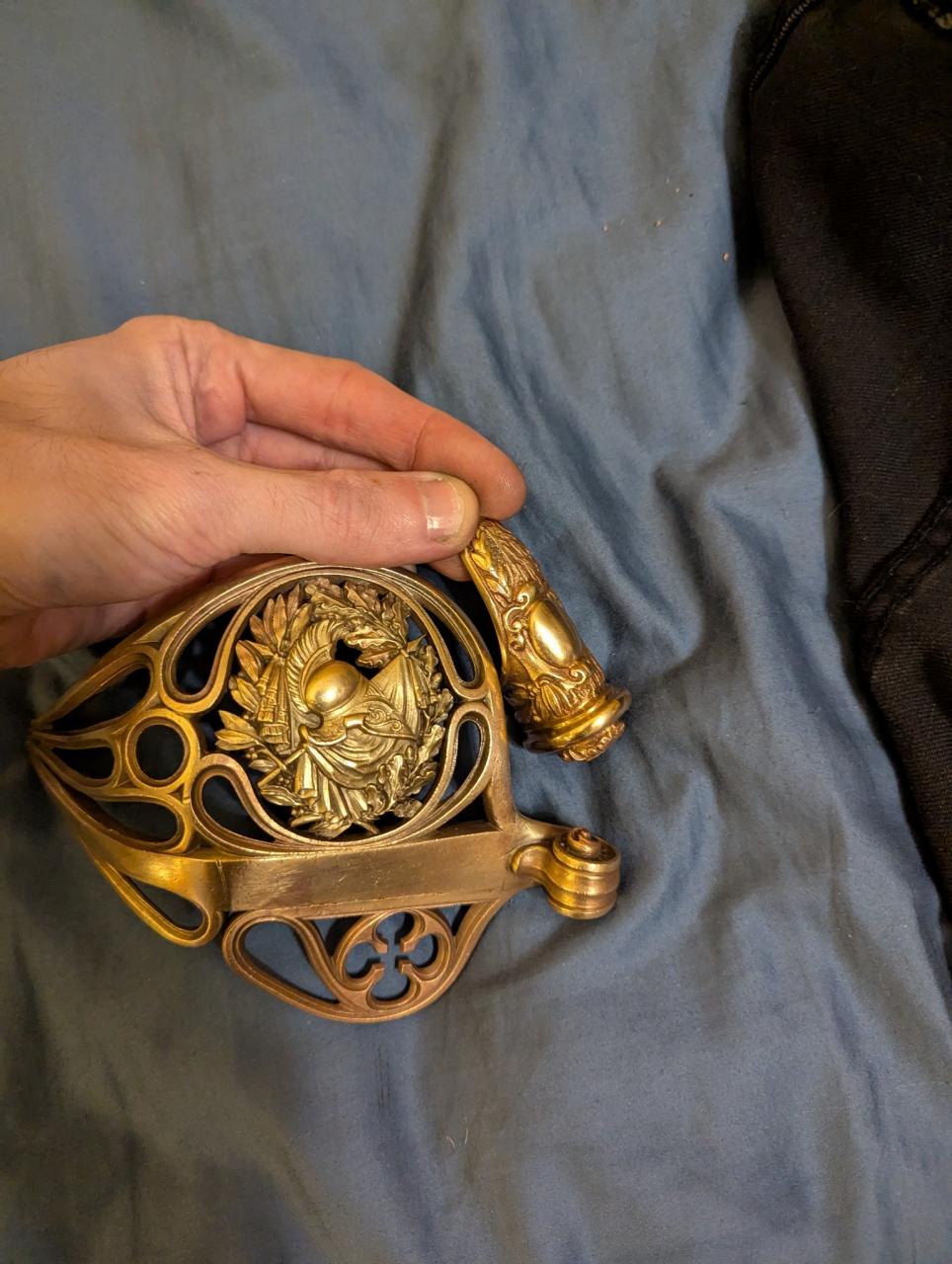

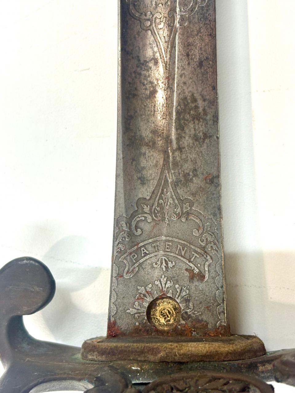

As a fun point of interest, I won this sword mid november. A Pillin (maybe) patent solid hilt retailed by Robert S Garden of Piccadilly somewhere in the 1860s or 1870s. I say maybe as despite the fancy P proof disc and owning multiple Pillin patent solid hilts, I think there is some uncertainty or debate on whether or not the patent hilt blades were made by a white label maker such as Solingen or Birmingham. Regardless, Garden was one of the top outfitters, especially for the most adventurous officers and explorers heading to Africa and India with fine firearms.
But to get to the point, you can see what is the remnants of a folding guard there which is extremely uncommon both for a patent solid hilt and a sword made in the 'middle' Victorian era, with the pin slot and a broken leaf spring exposed. I am unsure on what, if anything, I can do to fix this one but hoping the assembly is threaded like some patent hilts so I can disassemble it. From there, a new hilt (with a folding guard) would be a matter of filing the new slot for the blade to be wider and seeing if the original backstrap would slot nicely. Maybe some mild bending work. Otherwise I would need to at least find a spare folding section or commission a new one and try and find someone who could grind off the broken pin slot and maybe braze on a new one? I don't usually endorse full modifications or defacing antiques but I believe in functionality and fixing broken things and this might be a learning process that may pay off in the future.
I have not researched the officer yet but there are initials, 3 or 4 of them but it is a lot of vertical and diagonal lines and I am unsure who it may belong to. WNR is my strongest guess.

I would not recommend replacing the guard on this Garden patent hilt.
Only a dozen or so Gardens are known.
Disassembly always raises questions of originality and can devalue swords.
An operational folding guard isn't necessary to a display sword.
I have a Garden patent hilt sword and the VR appears to be shot out and I do not plan on replacing the guard. Likely the officer left it as is because of the history behind the damage.
The number on the blade spine is 405, is yours numbered?

I believe so, only inasmuch as 1 of the phots of the flat is just angled enough that I can see indents on the spine indicative of some numbering. That is quite a long ricasso on your example! Am I mistaken or do the longer narrower ricassos tend to be associated with the Solingen trade blades? I know many makers used imported blades but the exact specifics on who actually produced the patent solid officer blades has always been a murkier area.

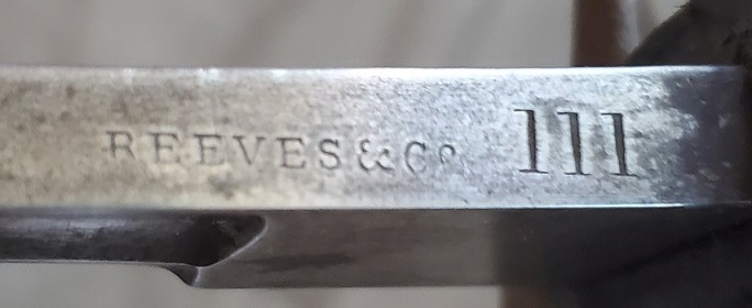

You note numbering on the spine of a sword, and it seems I have seen suggested that often swords destined for East India Company service were often numbered in this manner (Garden & Co. ?).
I have a Reeves pattern 1821 light cavalry saber, which is numbered 111, on the spine. Would this possibly be a weapon in this category?

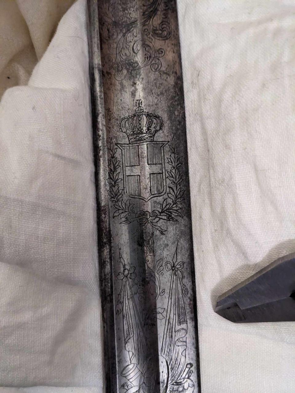

I have submitted an email request for information to the Oman National Museum. This is far outside my scope of knowledge and outside of a few German museums getting back to me once about a very rare NCO blue & gilt "damascus" sword, I usually get nothing but radio silence here.
As other boards on this forum deal with more ethnographic and non-Western based weapons, I would request any suggestions on academic professors, researchers, or other individuals and places to whom I can contact. (I dont blame museums for radio silence, they are far from glamorous and it is elements of the worst parts of public facing civil service, the politics of upper academia and having to follow the current trends culturally, filling out endless grant forms, having to appease your Patrons, and very little actual time getting to researching and exploring antiques)
I do not like to reply without images so the attached is a true mystery to me when it arrives. Saw it at auction, the hilt and blade interested me, but I did not bid. Saw it again some months later and I am quite superstitious in a 'small bits of fate' sort of way so I knew I needed to get it. Whether it is a composite or not almost does not even matter to the central mystery: the guard is of the bataille hilt style from the Ancien Regime through Napoleon, as is the shape of the blade (95cm by my estimates). However, the grip is horn, and the plate on the guard is of the type associated with superior officers, specifically the 6 flags. Image #2 is a half finished superior officer guard of a rare "Gothic" type I got and will one day have finished to be mounted on a NOS superior officer blade (not trying to pass off as truly original, but I've long wanted to take old unused parts and make "new" swords just for myself) for comparison RE the flags. The blade also appears to be one of the rare French types that is etched in a Franco/German style, and not blue & gilt. My current theory is mid century when they had that other fun period of changing governments like women change purses. The ship in the middle there is usually related to Paris.
Searching for answers in books & online has been quite a challenge. There is a non-zero chance it could also be for naval or marine officers. My strongest association is one of the Guard units around Paris somewhere between 1848 and 1853 for obvious reasons/ But there are so many different implementations of civic, municipal, gendarmeries, republican, royal, etc. that accounting for translations being slightly wrong, people mislabeling antiques, and all the various ways a single word change can make the difference between 2 different the Paris national guard, the Paris republican guard, etc. that until some sort of documentation or photos are found, I do not think I can fully ascribe provenance to this hilt whatsoever.
As said earlier, both myself and Mr. Jean Ondry believe there is a solid chance this is a composite, albeit an older composite. The blade is form correct though. Large guards like this were offered even into the 20th century though it seems weird that no examples pop up elsewhere. As an aside, it has me wondering in a regrettable way if many swords purported to be older than they are, such as belonging to the Napoleonic Wars era, are actually later creations and either through ignorance or outright malice, have all been slowly shifted towards an earlier provenance? After 4-8+ owners over a century or more, or sold by a relative or an antique dealer, it would only take a single person to misattribute the sword to an earlier era to make it largely permanent, and you would need to look at all of them with a deliberate focus of trying to prove they are not as old. I cannot speak any French and I do not wish to disturb the waters over on Passion-Militaria enough or even in France proper to ever make any public statements. There is, however, a fascinating world of custom and non regulation swords over there that is waiting to one day be uncovered and categorized more, just by looking at hilts. Last images are of various catalogs in the last decades of the 19th and early 20th century (image #4 is another unused guard I got that was unfinished, has what appear to be guide lines for some fleur-de-lys type of later chiseling, but has again appeared to be a complete mystery for provenance as it does not match hilts seen anywhere. I have a Swedish 1773 cavalry pallasch blade and should I ever find someone who can, I would love to have the hilt decorated and filled out with maybe a central elaborate plate mounted of some sort even just for a personal design, the tongue of this one is quite wide and long at the top so unless it was overcast and meant to be filed later, whatever pommel or backstrap it was to slot into was quite large)
Hopefully I can ascribe a provenance to this sword, I've no intention of selling it based on that or anything, but I find having 'story' swords to be good conversation pieces if nothing else!
