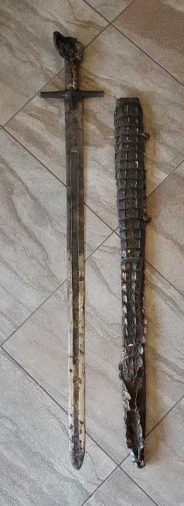

I received Kaskara, I did not create a new topic because I think it is also from Kassala. The blade is very badly corroded, I had to use chemicals to clean it. I will be glad if Edster joins in and gives more detailed information.
Overall length: 1025 mm, blade length: 900 mm, weight: 960 g

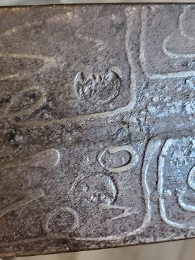

I agree with your Kassala attribution. I know nothing re the maker's mark. Note the Beja/Hadendawa tassel below the pommel.

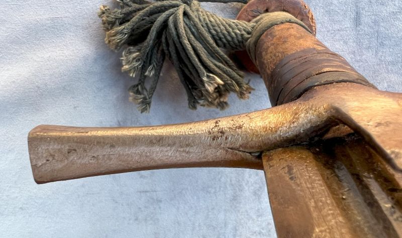

The cross guard shows what are likely incomplete forge welds on the bottom as well as the end of one of the cross pieces. Check to see if the bottom langets look to be bent to shape instead of welded in place. If the above are the case then the cross guard was bent to shape from a flat piece as I noted in the Cross Guard essay and was "invented" c. 1945 in Kassala. Thus, your kaskara took its current form post 1945. I collected one very much like it when I was there in the mid-80s. It's foto is in the essay and shows a noted incomplete cross guard forge weld.

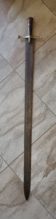

The first, in acid etched thuluth script, with 'dukari' and brass guard, as found in these types of weapons produced at Omdurman post Khartoum. Many other weapon forms were also acid etched in this manner, and taken from the field at the battle site.

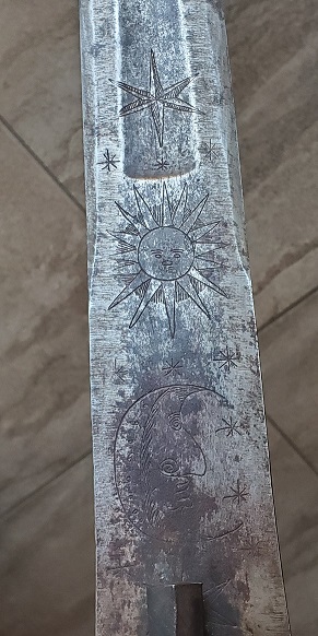

The next is an entirely crocodile covered kaskara, with the foot as hilt, clearly not conducive to combat use, but in my opinion likely to chieftains or holy men as more symbolic. The crocodile as I have been told was revered and feared, and while many have scoffed at these as 'souvenir', most evidence I have found shows this was not necessarily the case.
Note the cosmological motif on the blade.

Here's a 2015 thread that noted half-moons on European swords back at least to the mid-18th C. The styles and details are varied enough for them to be wide spread.
Also, Post #4 has blade engravings much like those on your crock sword.

You are absolutely right, here is a photo of the crosspiece.
