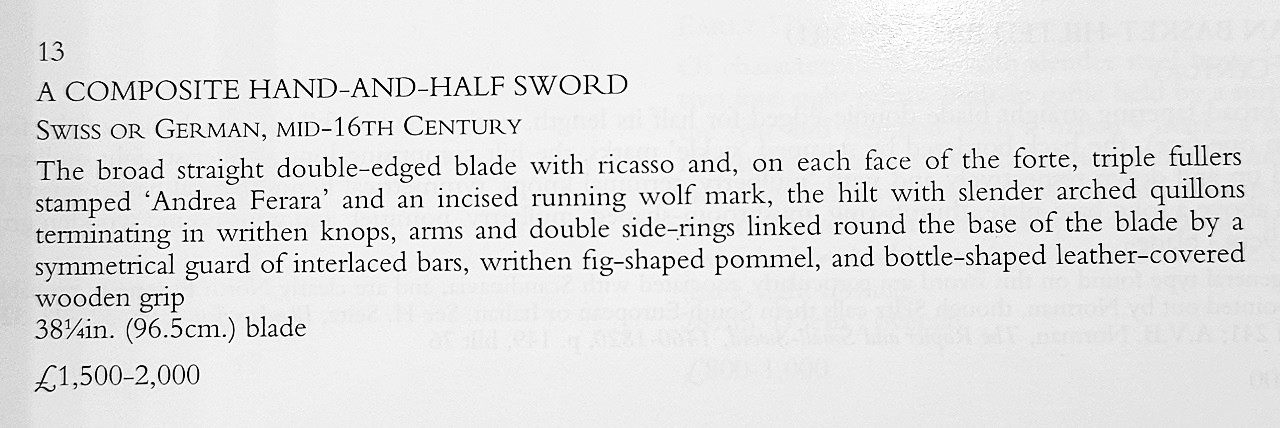

I bought this at Christie's at their 12/12/97 auction. Sadly the catalog is in a box somewhere. Eventually I will post the listing.

I had always thought that this sword was "untouched" and that it was as it was during it's working life, even down to the leather. I wonder if one did a careful examination if one would find traces of blood? I think that is likely.

I noted that the Christie's description description describes it as "composite". I see not evidence of that.
Thoughts?

I well remember my anticipation of the glossy sales catalogues from the major London auctions back when I was active...
The cataloging was pretty stringent back then...

Thats it. I wonder what the issue was?

I wonder if some features seemed possibly asynchronous to the cataloger at the time, then logic was to better call it composite to be on the safe side if someone later had doubts. When and if it turns out to all be contemporaneous on further study, then the buyer will not likely be unhappy.

Thats what I figured.

Hi Ed,
during that period, you'll see the same thing with good pieces at that auction, where specific knowledge is required, this went on for years.
However, items described as "composite" were never specified as to which part was actually composite. In some cases, you could see that the leather on the grip had been replaced.
Almost all the pieces were simply "good" not only that, it also happened a few times that good pieces were described as 19th-century.
This can still be verified using online catalogs.
