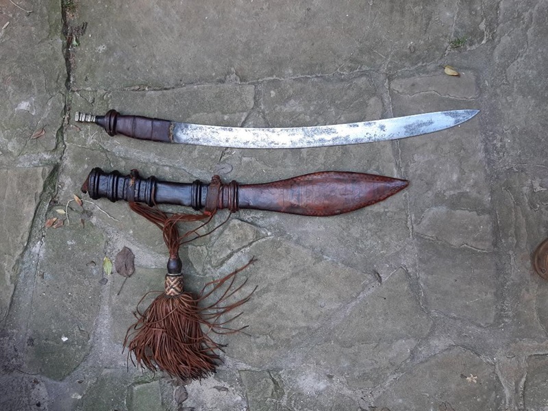

To add to my previous soliloquy;
The 'Mandinka' sabers are as noted typically regarded as from this tribe and from Mali, but obviously there are not distinct geographic boundaries to their regional presence. As far as I have known, there has never been a term for these sabers distinctly assigned, nor a distinct regional categorization...simply that it is a Mandinka saber.
The Mandinka tribes as I have understood were keenly in control of Trans Saharan trade routes which of course went through the important hub of Timbuktu in Mali. This alone would account for the diffusion of these type sabers, and the distinct leather work which seems to come from the west.
It is notable that the flared scabbard tip which is a distinctly Sudanese feature from the kaskara is present on these Mandinka sabers.
Also notable is that these typically have European saber blades, which is atypical for the preference of straight broadsword blades from Sahara to Sudan with the takouba and kaskara. Here I would note that some Tuareg swords with takouba type hilts have such saber blades and are known as ALJUINAR in Taureg parlance.
As far as the MANDINKA saber, I was once discussing these with a Fulani man from Guinea and showed him photos of one of these.
He immediately recognized it and called it KOTA........and pointed out the scabbard as called HOLGA (= house, apparently).
The study of the diffusion of these sabers is far more complex, but of course reflects the importance of the trade routes and how they carried not only goods but many cultural influences far and wide.

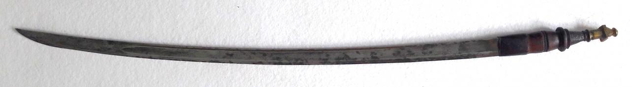

Got this piece at real knock down price as the blade is stuck in the scabbard. I am hoping for easy retrieval and a fair condition blade that is not too rusty, fingers cross. Will follow up. I was meant to be no longer collecting.

This is my copy, not old, the blade is clearly locally made. I have long wanted to buy something more "ancient", but so far it has not been possible.

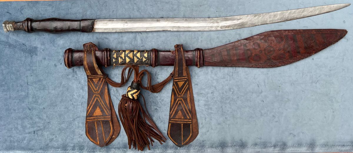

This is one I had with a native blade quite flexible and razor . There. is a much better photo of it with the scabbard some where on this site but I cannot find it for now. Wish I had kept it now. Sold the bulk of the collection some time ago. Why did I do that??? I do not know. The money went so quickly.

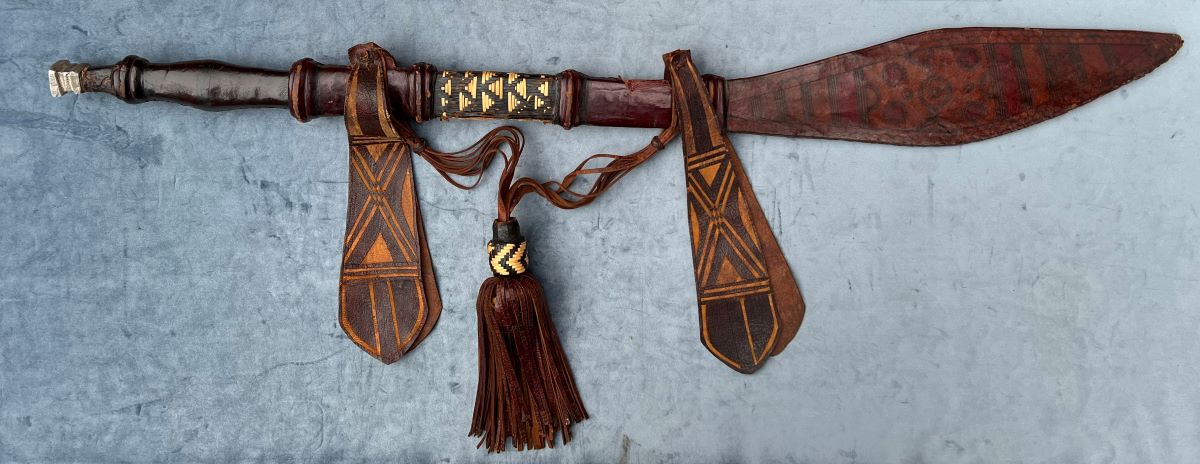

I am glad I did not pay much for this sword. Once stuck in the scabbard, I managed to get it out but it was heavily rusted, deep rust. The rust had rotted the inside of the scabbard. The way these scabbards are made heavy rust will break up the materials. The scabbard is made with vainer like slat of wood either side of the blade, then rolled in cotton fabric and finally covered with leather. So as the blade came out debris of the wood came out with it and now the blade will not go back in. I cleaned the blade of rust so just bit of a wall hanger.

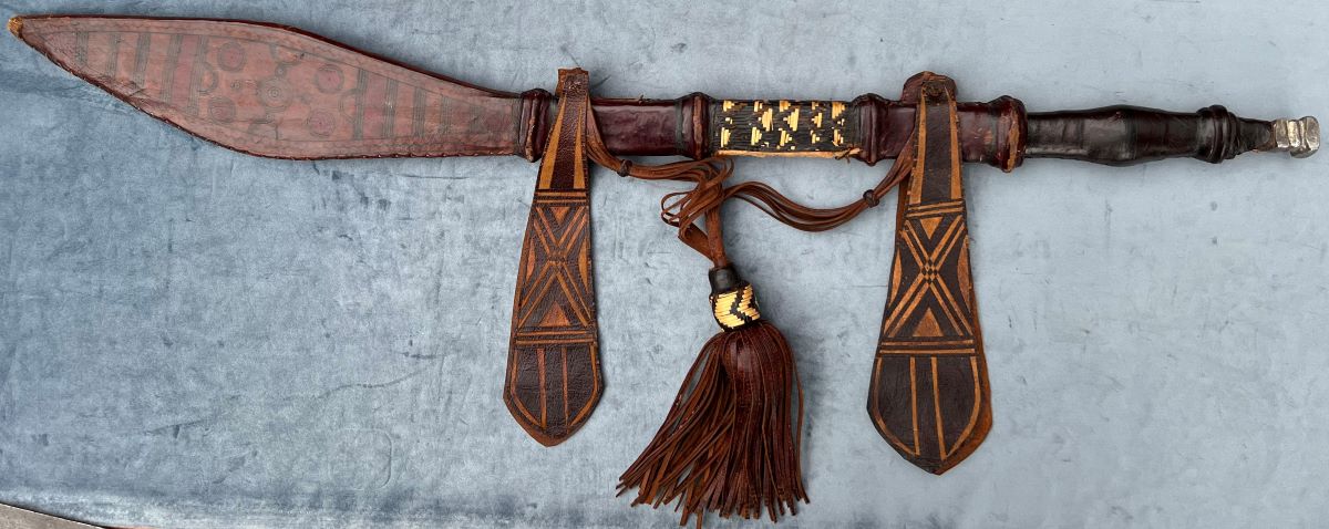

This is my duplicate, which has a military blade from Europe that is probably French because of the previous colonial impact.
Marc
It looks like a cut down 1822 French Light Cavalry saber

Thank you for confirming my suspicion that it is a French military blade. The examples of an 1822 light cavalry saber on the net are very similar.
