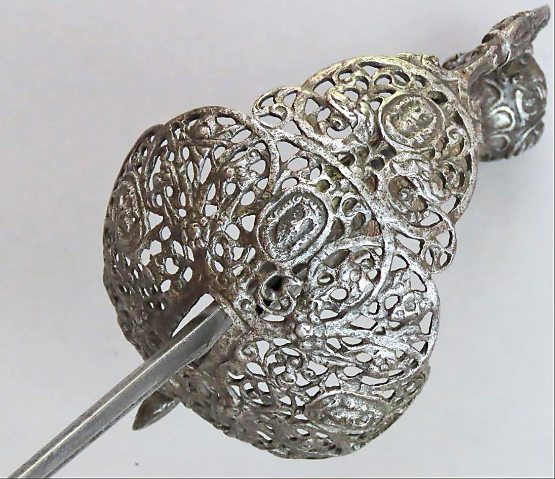

It was actually Sebastian Hernandez on the blade; the final letters were obscured.

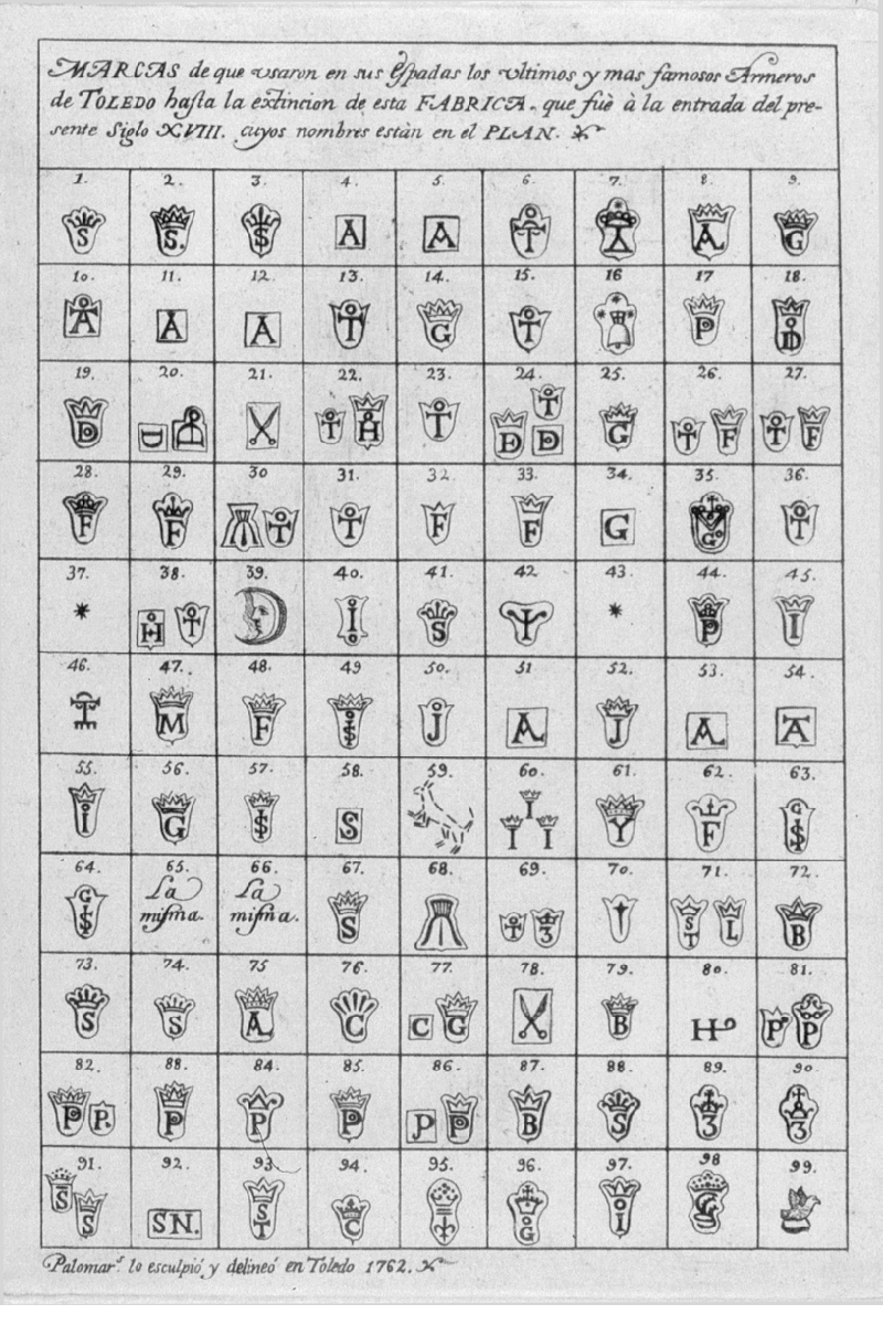

Fernando, your post of the names and symbols of Toledo blade-smiths, in particular the symbols, led me to take a close look at the forte, and sure enough, there was Hernandez the elder's sign.
I've always wanted a Toledo blade, but did not actually envisage finding one. The fact that it is on a Cavalier's rapier (another want on my list), and a luxurious one at that, with Charles and Henrietta's masks on the hilt, makes me very happy.

This is breathtaking Keith!!! A cavaliers rapier with a TRUE Toledo blade!!
I have honestly never seen a rapier blade that is unequivocably TOLEDO, and with this very famous maker. While Solingen indeed copied his name on their blades early 17th c......this may well be from Toledo by him c.1590s.
As far as I have known, Solingen may have used his name, but never his punzone.
This undoubtedly belonged to a very well heeled cavalier.

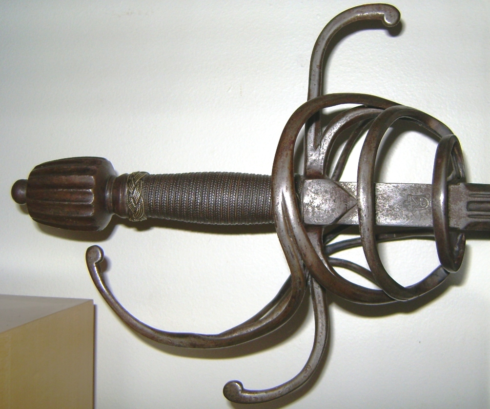

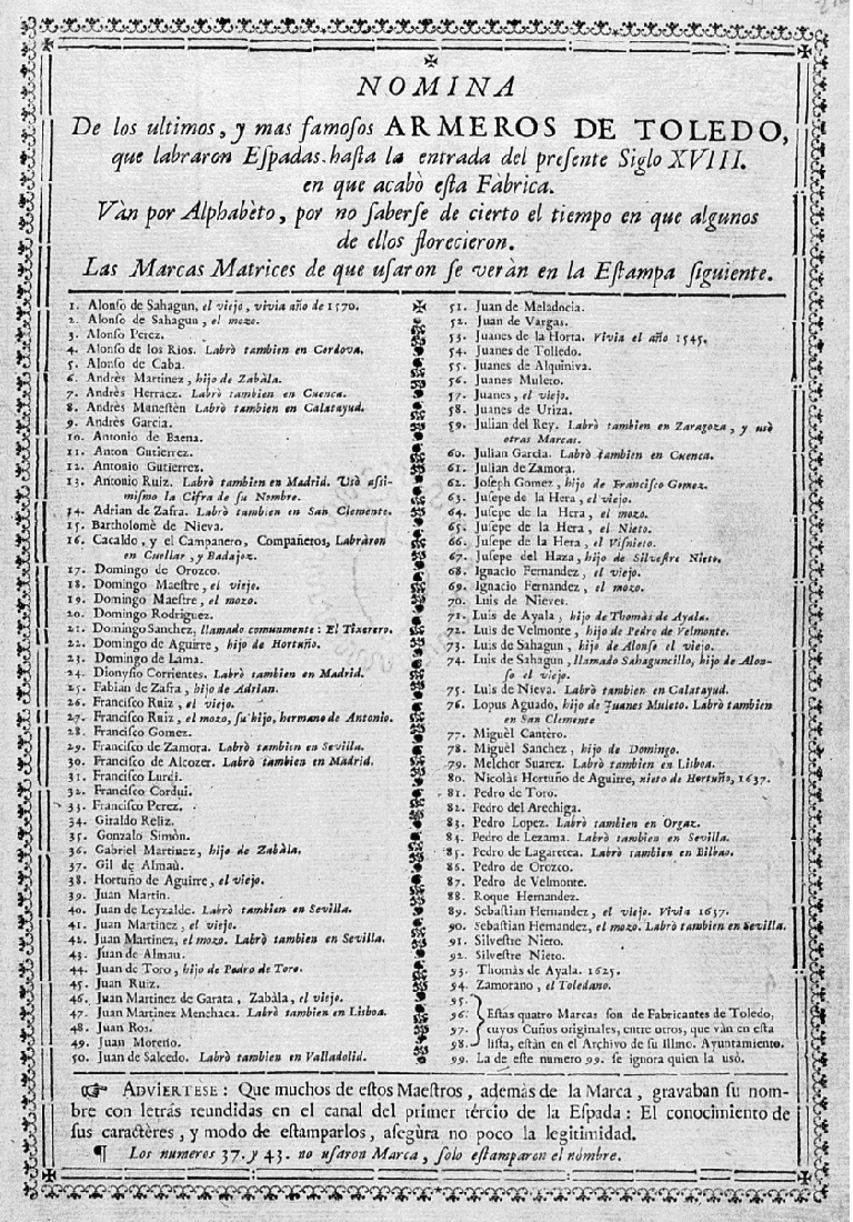

But speaking of inequivocal Toledan blades, and as also a reminder to Jim , allow me show you my not so gorgeous example, signed and marked by Gonzalo Simon, position #35 in Palomares nomina.

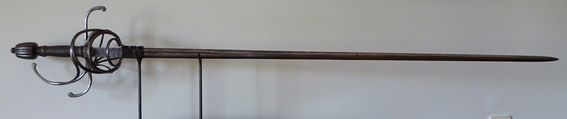

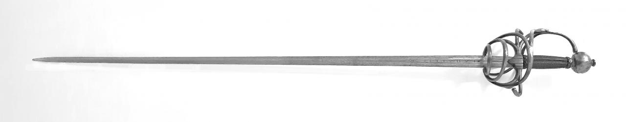

Of all the swept-hilt rapiers, that one is my favourite - by a long way. I've looked at your avatar many times and admired the sword. Somehow, it speaks to me.
I searched a long time to acquire a similar one and finally came across this.
I have not been able to find out who made it or where it came from, but I suspect it looks like a 'City Guard' shield - of which there are a multitude; also, I am unfamiliar with the script.
I abandoned the search and simply enjoyed the sword.

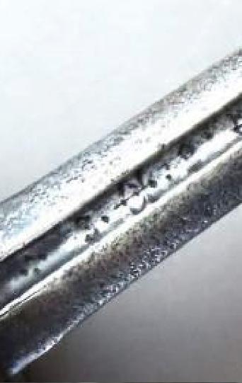

ps

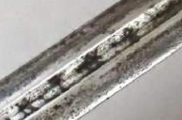

Incidentally, observe these traces of a gold coloured metal in the ricasso; are they just part of the mix or do they have some significance; I was never certain. KF

It would take someone with more luggage to accurately judge on that inscription but, within my limitations, i dare say it is just gibberish. Also the symbol on the left, a very early one, was certainly hijacked.
As (i think) i recall reading, in this case in Toledo, one of the crafts was blade guilding. This being a luxury asset, not always customers requested it. Also this being a very thin gold layer, tends to vanish within time.

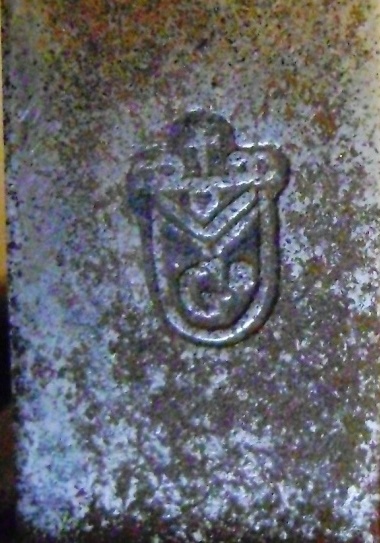

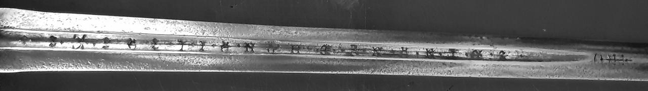

I have done my best but I no longer have my pro gear.
It would appear I saw what I wanted to see and the punzone is not what I imagined.
I don't know what it is... does anyone.
So, without the second identifier we cannot be certain this is in fact a Sebastian Hernandes blade - even though it says so on both sides.
Nonetheless, it is a spectacular sword.
ps
these seem to be very peculiar Es

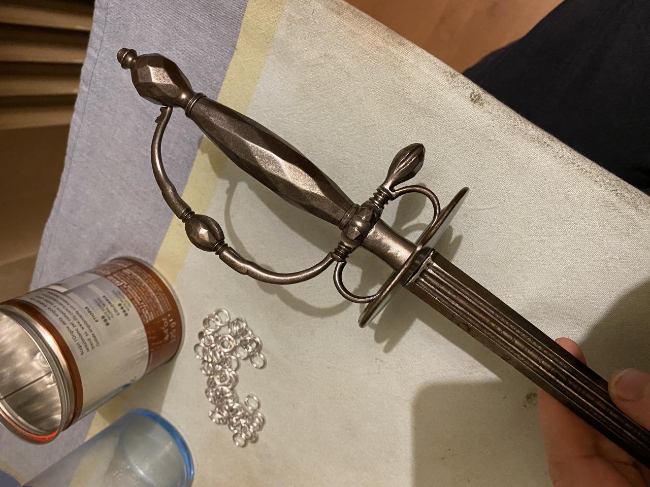

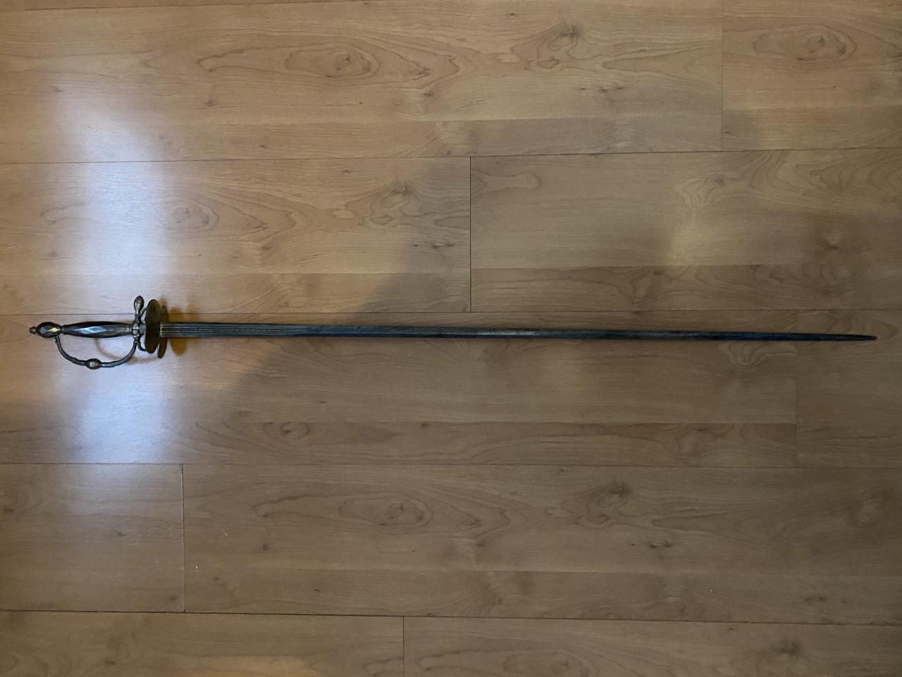

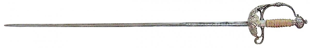

Hello guys, this is my contribution to the topic of Sebastian Hernandez.
Already showed in a dedicated post, but this is my Smallsword (quite surely a composition of different years) with its blade marked as XX Sebastian X Ernandes XX and then the Anchor...
RogerFox is offline   Reply With Quote
