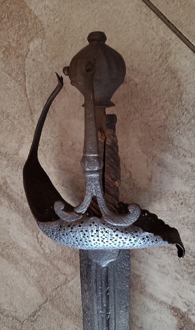

Picture 1 a Hounslow hanger
2 'mortuary', typical English half basket attributed to Hounslow with ANDREA FERARA blade, German blades clearly were a
strong component of Hounslow produced blades.
