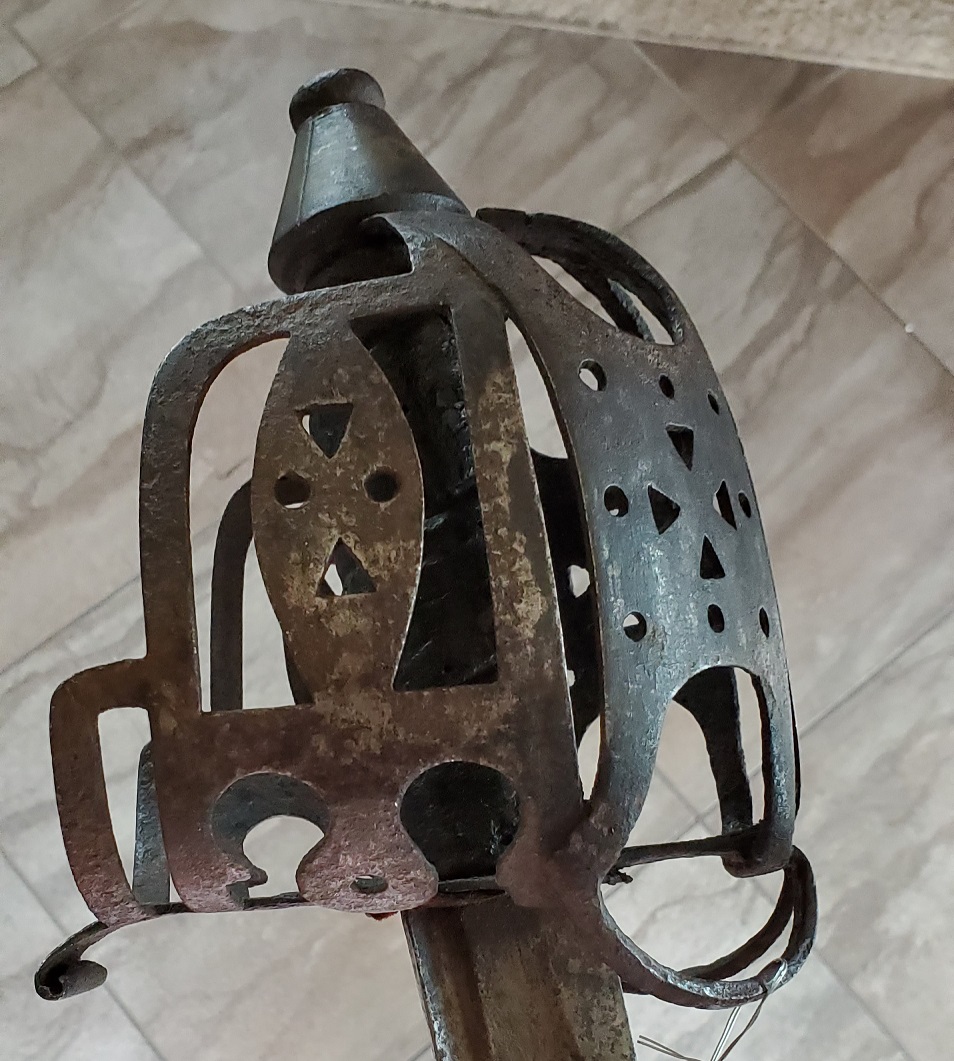

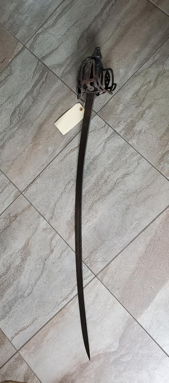

As an example of how basket hilts might obtain curved (Turcael=turkish, curved) blades, this one is a British basket hilt c. 1750 as used by the Black Watch into the Revolutionary War. These were abolished when infantry were to no longer use swords (focus on bayonets) in 1784, and they went into armory stores. Apparently later in the century, officers, whether rifle companies or other, opted to use these basket hilts mounted with M1788 light cavalry blades as this one.......thus 'turcael'

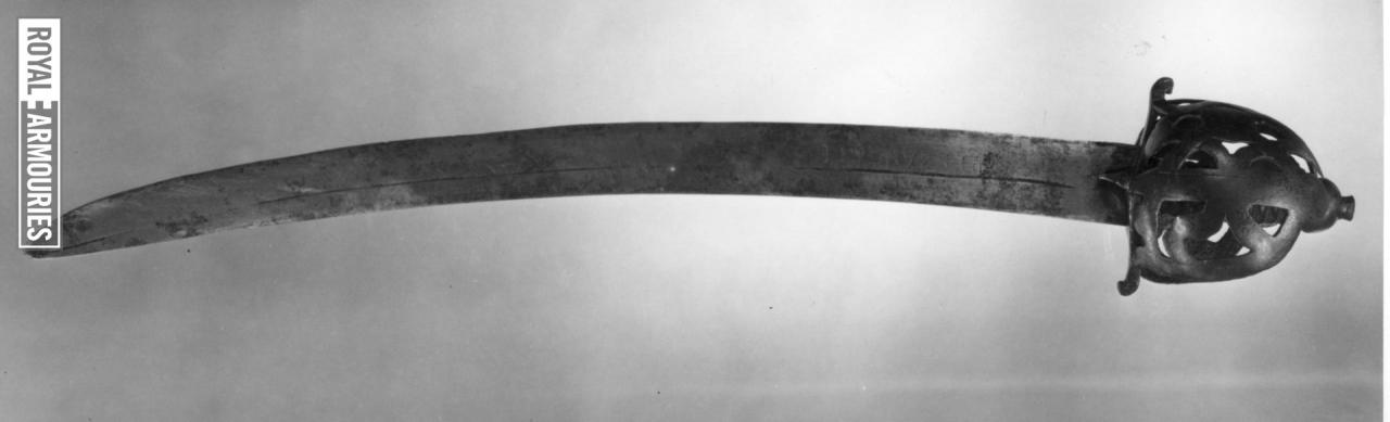

Hi Jim. Just in case you are not familiar with the sword mentioned: RA IX. 1015
here it is.
Old 4th August 2023, 04:01 AM   #4
Posts: 10,867
Thank you Keith, actually I had not been able to locate an image of that, velly interesting!
